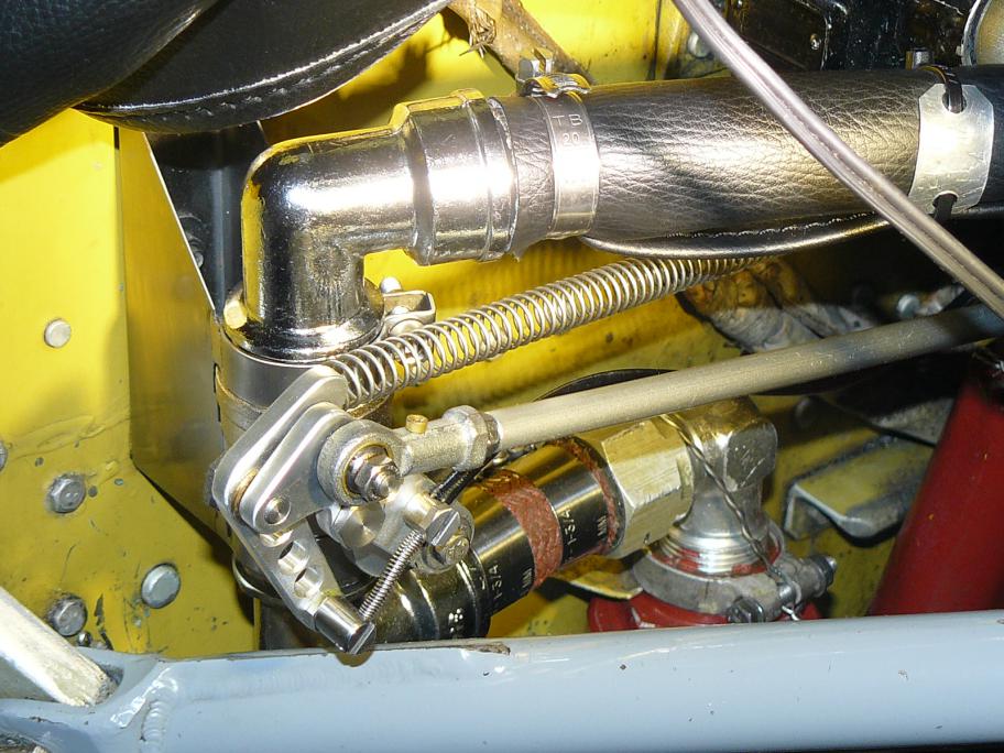

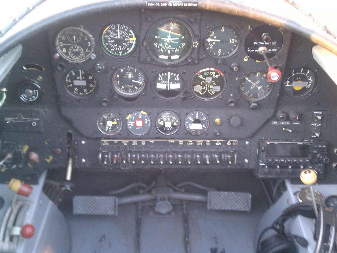

I’ve used the system from Kevin Kimball for about 6 years. Yes, you need the shut off valve and the scavenge pump both. Even running up at 1800 rpm for a while doesn’t get all the oil out. I’ve NEVER had a lock since the system has been installed (over 700 hours). I’ve had some oil in the exhaust/drain (very small amount). But never close enough to cause a problem

We decided against the electric shut off attached to the oil tank as I know of several cases of the tank cracking with the weight of the valve
and associated plumbing.
I believe some owners have installed a mechanical gate valve and bowden cable with safety micro switch. Looks like best fix to me.
We have a drain manifold installed with a drain valve when parked plus cans hanginging under the ex pipes.

I'm previously one of those with an electric valve that ultimately failed and also cracked the oil tank because the valve hanging beneath the tank was insufficiently supported. Now have a mechanical ball valve mounted to the port firewall. When the valve is open, it's red handle closes a micro switch wired to the start switch. I must open the valve with my dumb hand before getting into the cockpit. Should my dumb hand forget, the engine won't start and a red light on the panel advises me of the dumb hand's error. It's worked flawlessly since Vladimir installed it three years ago.

On the two CJ's I've owned I have installed the electric shutoff valve. Tank cracking is a problem and we solved it by welding gussets to the bottom of the tank (not the big square plate welded to the bottom of some which WILL eventually crack at the corners due to the stress).
On our restoration projects we installed the Kimball valve, which also works very well. It's a bit less complicated to install and does the job. The things I don't like about it are that it creates an extra push/pull lever in the cockpit (v. using an existing switch in the panel) and because it is mechanical it requires a pretty forceful pull to the open position (this turns opens the start electrical circuit). But, it does do the job well aside from these more minor hassles.

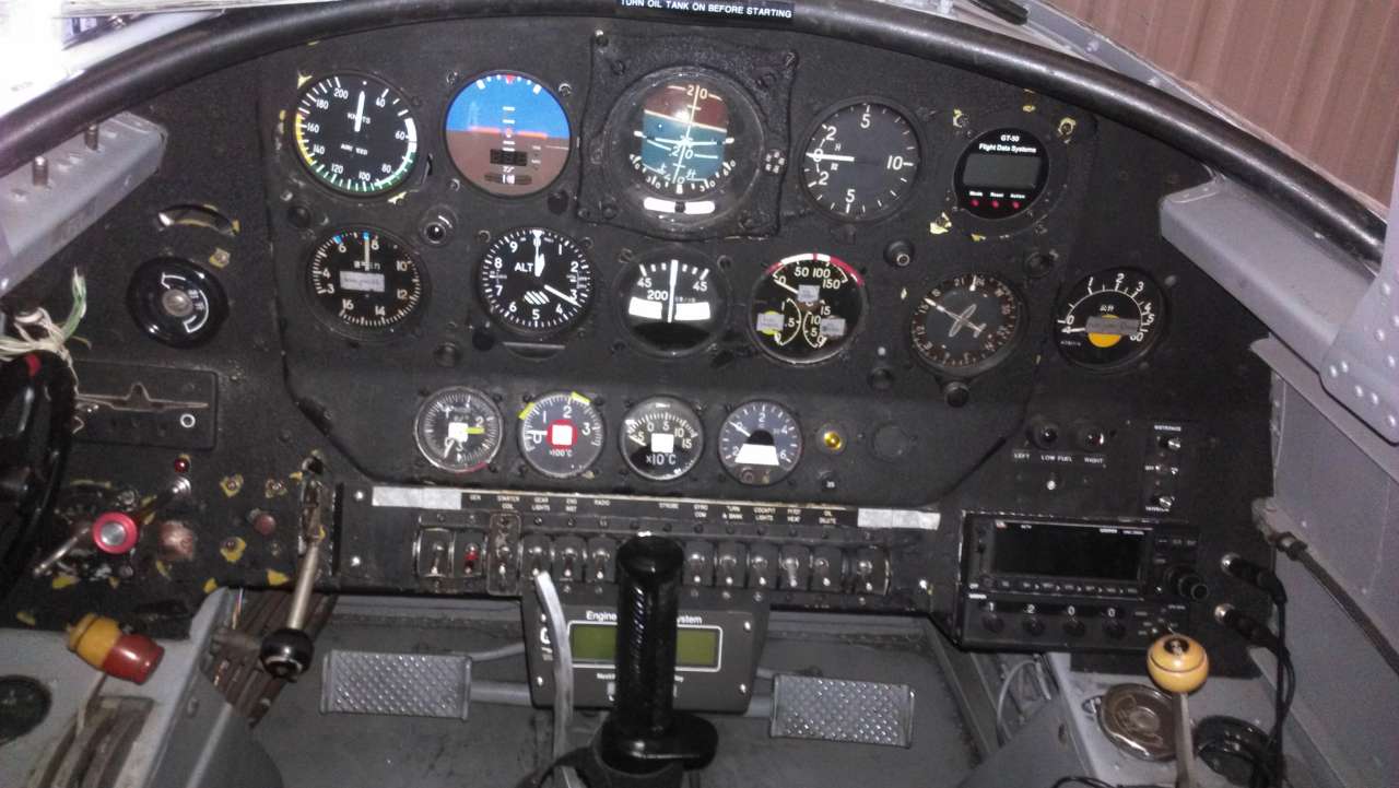

rmhou(at)yahoo.com
PostPosted: Fri Aug 23, 2013 10:43 am    Post subject: Hydraulic Lock Prevention Reply with quote
My CJ came with a Kimball valve. It was mounted on the upper right side and was hard to operate - 2 hands operation to open. I moved it above the starter push switch; this location is very close to the mag switch, so I won't forget to close it after shutdown. I put a lot of WD-40 through the cable and now I open and close it with 3 fingers. The space above the starter switch is not much, but there is enough room for the cable and a small light.
From: Walter Lannon <wlannon(at)shaw.ca>
To: yak-list(at)matronics.com
Sent: Friday, August 23, 2013 9:44 AM
Subject: Re: Re: Hydraulic Lock Prevention
--> Yak-List message posted by: "Walter Lannon" <wlannon(at)shaw.ca (wlannon(at)shaw.ca)>
Thanks Barry;
I will be using the Kimball valve as well and am planning manual operation. However I will make final decisions on the installation after I receive the valve.
Cheers;
Walt

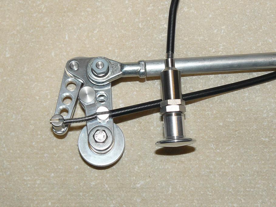

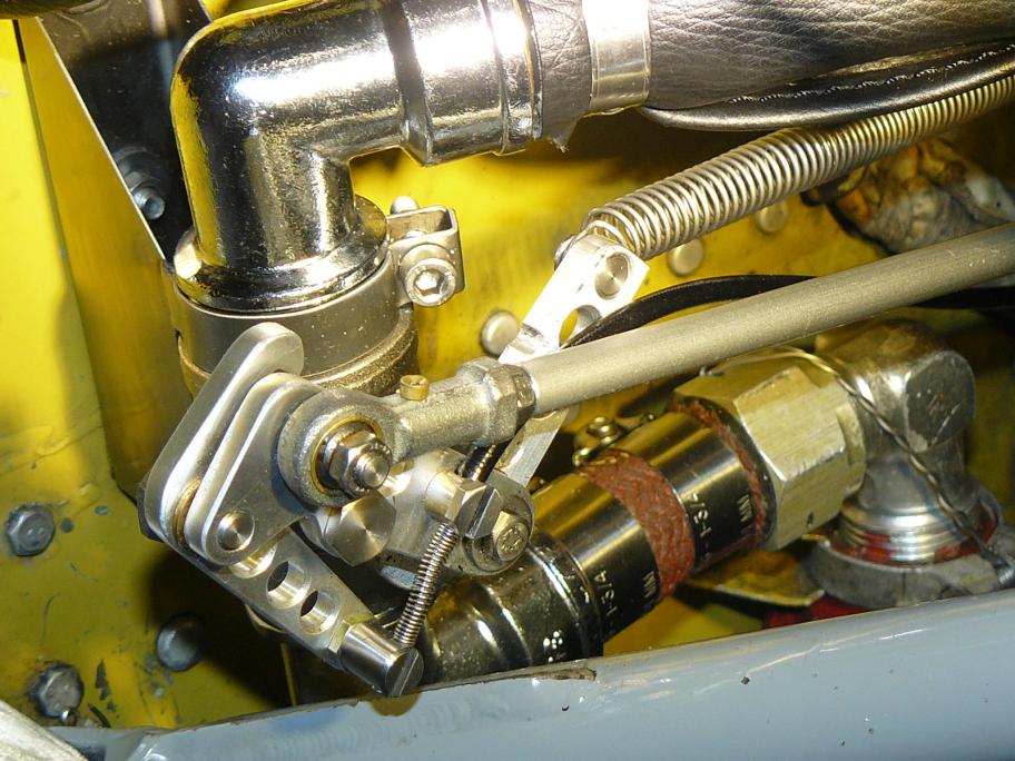

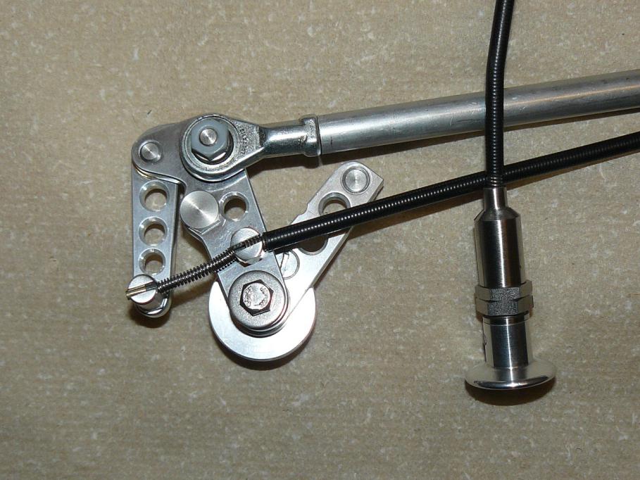

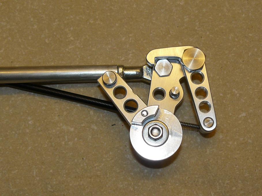

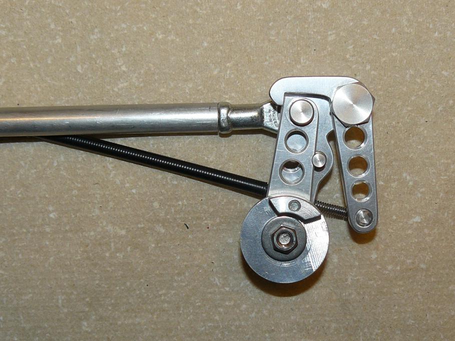

PostPosted: Tue Aug 27, 2013 7:38 am    Post subject: Re: Hydraulic Lock Prevention Reply with quote
Hi all,
for those who prefer a purely mechanical oil shutoff system let me share my actual setup on the 18 T : Basically the fuel tap is linked by push-pull rod to a common 3/4" ball valve on the right side of the firewall where the oil hose from the tank forms a U-turn. So in the cockpit you will not forget to open or close the systems or otherwise it would not be of dramatic consequence. After warnings from this forum that in case of a broken mag ground wire you only have one way to kill the engine by closing the fuel tap and too much time would pass with the oil shut off till the engine actually stops I reworked my initial concept :
The version 2.0 has an extra lever on top of the real oil valve lever and in normal mode both move united when you open or shut fuel and oil. In the unlikely case of a broken earth wire the oil lever can be unhooked via Bowden wire in the cockpit near the fuel tap and oil supply remains open while you kill the engine by fuel starvation.
So this set has worked great in the past and don´t worry about the rubber diaphragm in the carb falling dry, a year inactivity (Russian FLA reg aftermath) had no effect on it. Certainly no hydraulic lock since but we always pull several blades as ever. We get half a cup of oil in the plastic bottle on the ex pipe that collects from within the crankcase and that´s it.
Fitting an electric shutoff valve to the underside of the oil tank is a poor idea, it could be placed anywhere, just where my ball valve sits would work quite as well - and is easier accessible. But then, this is an electrical design - and electric current is a weird material ........
Cheers
Vic

PostPosted: Tue Sep 10, 2013 11:04 am    Post subject: Re: Hydraulic Lock Prevention Reply with quote
Wot, no comments - still ??
Please understand, I don´t sell any sets but wanted to share my idea with those who like the purely mechanical way. So feel free to include this idea of unlocking the oil valve from the fuel shut-off by Bowden cable in your own design that may look quite differently. But then, you will need some metal working facilities......
Cheers
Vic
