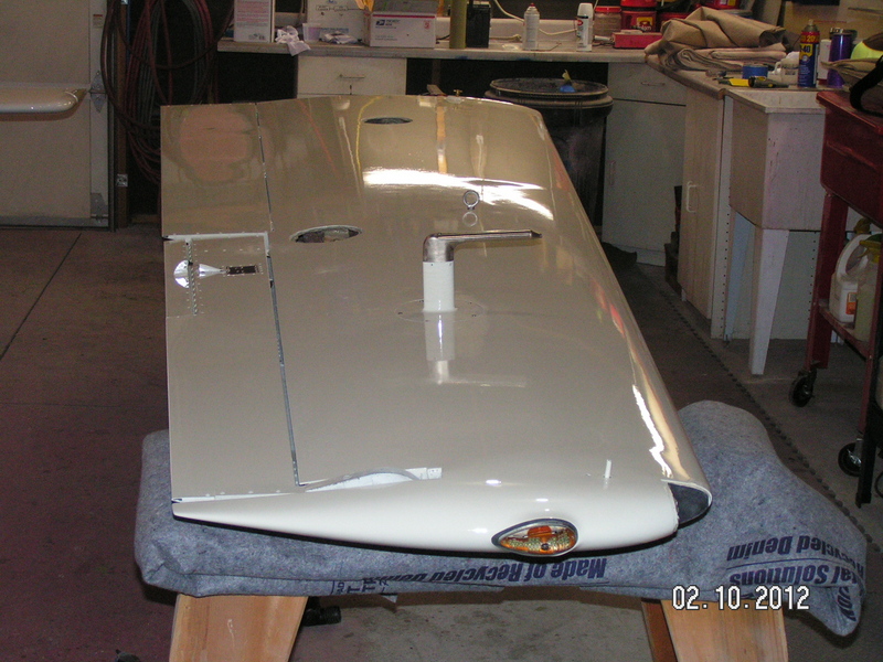

Does anyone know if a Dynon pitot has been fitted to a Pulsar - I have both the boom and angled type and need to know how much of a mod this will be.

I have a Dynon Pitot and AOA fitted to my Pulsar III. I mounted it to the required inspection plate I made when building. I have pics if you are interested. Cheers, Larry N852LW

Yes please - my repair guy thinks it will be much easier if we have something to copy. But you have a composite wing and I have a ply-skin - it may still be very useful.

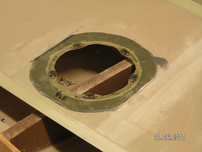

Here are the pics I have and I would be more than happy to forward any other info I have. Cheers, Larry N852LW

That looks like exquisite workmanship!
Would you mind sharing more details regarding your install?
For example, is it attached before or aft of the main spar? Where did you route the tubes/cables?
Could you describe the materials used in designing the inspection plate? Did you just cut a hole in the wing skin, are my eyes deceiving me, it seems that the back plate is recessed somewhat...
Thx

In my particular build (Pulsar III) the suggested mount in on the forward inspection plate outside of the left fuel cell. I routed the AOA and AS lines behind the fuel cell and into the wing root. Then it was a matter of routing inside the fuselage to the appropriate gauges and sensors. I used the Push to Connect fittings. I have enclosed several places to buy http://www.ebay.com/sch/i.html?_nkw=pneumatic+push+fittings (tubing), [url=http://www.automationdirect.com/adc/Overview/Catalog/Pneumatic_Components/Pneumatic_Fittings_-a-_Air_Couplings/Push-to-Connect_Pneumatic_Fittings_(Thermoplastic)]http://www.automationdirect.com/adc/Overview/Catalog/Pneumatic_Components/Pneumatic_Fittings_-a-_Air_Couplings/Push-to-Connect_Pneumatic_Fittings_(Thermoplastic)[/url] (all kinds of fittings), Hope this helps. Cheers, Larry N852LW

I came up woth another supplier which I have used. They are an aircraft supplier and have the fittings and the tubing in the various colors to keep the function clear. http://www.averytools.com/searchprods.asp Hope this will help as well. Cheers, Larry N852LW

Must search the Avery site for Safewair1 kit/tubing. Cheers, Larry N852LW

So the inspection plate assemblies came with your Pulsar III kit?... I have a Pulsar XP and was wondering if I can/should do something similar... the questions really is how the wings differ on the two pulsars?
There must be structural differences as the III has a higher gross...

I am thinking my XP would take the loading of the pitot if mounted on the inspection hatch but it only has 4 small screws. My repair guy/inspector thinks it may be viewed as a modification that requires in-depth planning and proposals so I will suggest the hatch rather than going into a piece of virgin surface.

You had to fabricate the plates. What I did was cut the size hole you need and save the cutout circle. I then glassed 3 layers of glass on one side and trimmed to give me a 3/8" edge. Sanded, filled and paint the same as the wing. On the wing I fabed another layup of 4 layers and cutout a circle to give me a "shoulder" to glue to the inside of the wing. After fabricating and trimming I installed 5 blind nuts. You want to use the type that will give a little play in the captive nut portion. You have to do some fidgeting at this point to get the shelf into the wing. Place In the wing using Hysol adhesive. How you index to get the holes to line up is up to you. I just laid the fabed inspection plate over the made shelf and marked and drilled the five holes and marked the location with a felt tip pen. It is kind of a pane but they turn out real well. If you want I can take some close up pics to further illustrate what I am telling you. Cheers, Larry N852LW

I have an XP and I have two inspection holes on the underside of each
wing. Checked it out with Aero Designs first who said go head.
No problems after 13 years.
Bernie Wilder
That would be greatly appreciated. Thx
