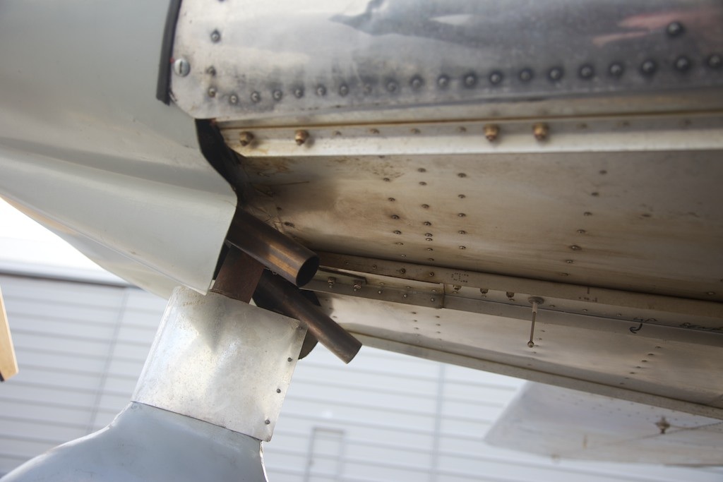

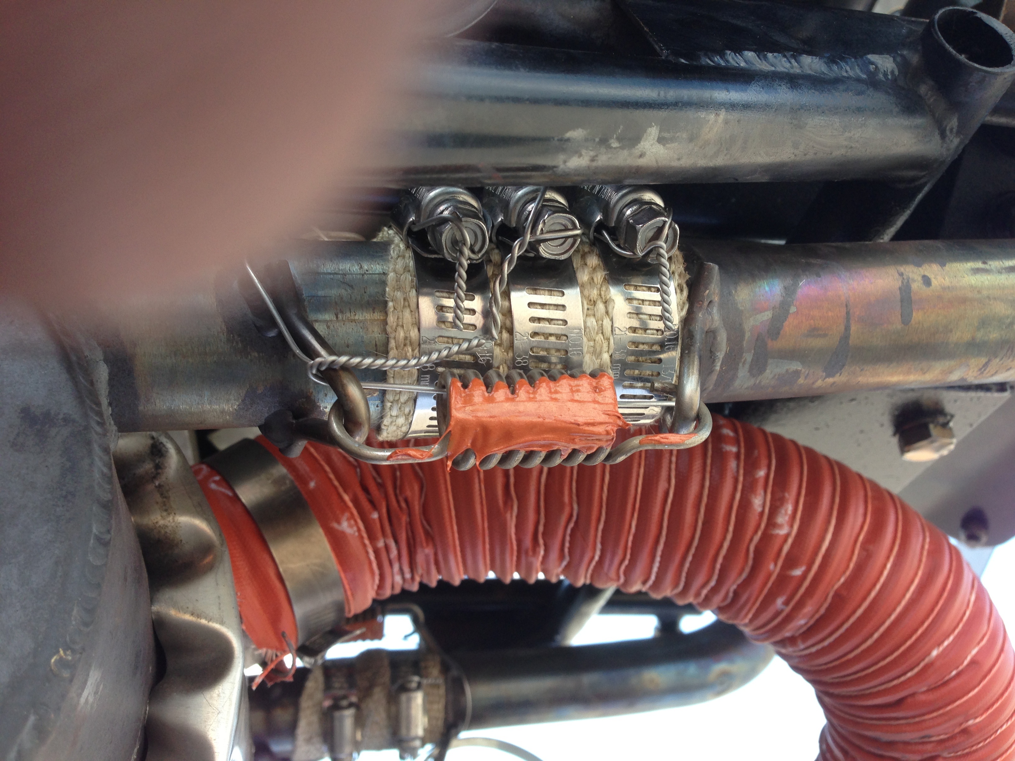

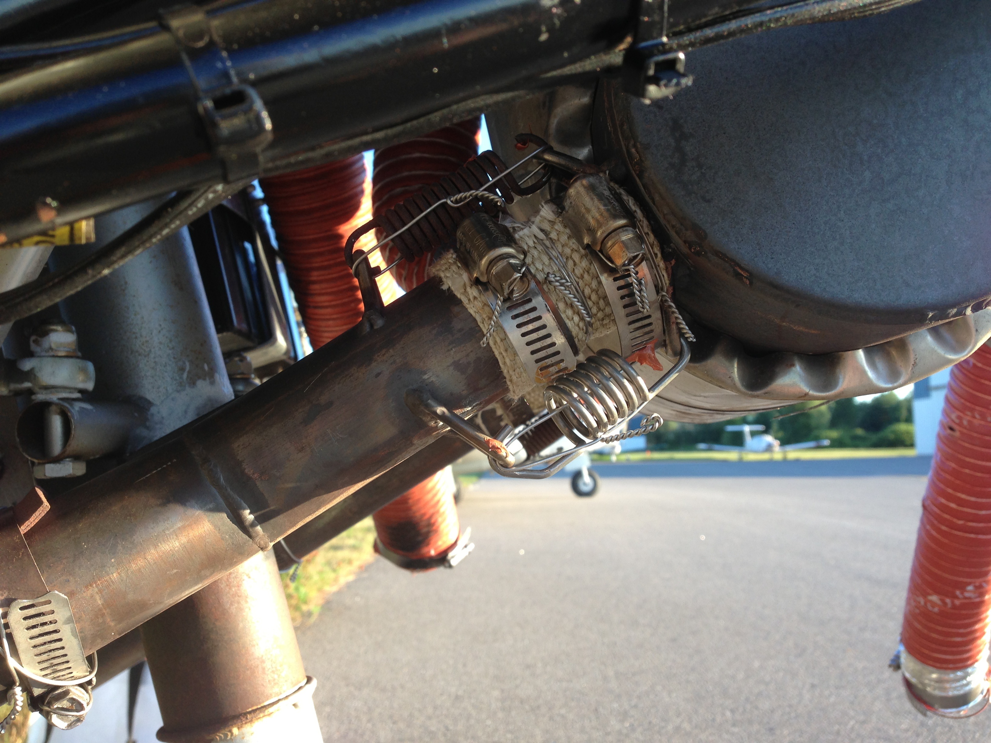

Need some help guys. I'm getting VERY high CO readings in the cockpit. Especially in slow flight. Rotax 912ULS powered. I get CO entering even at 110kts. Any ideas? I plugged off my cabin heat and It made no difference. Exhaust re-sealed at the joints. Noticed the CO increased when I re-sealed the two stacks out of the main muffler. I'm lost.....

Here is the stacks.

<?xml:namespace prefix="v" /><?xml:namespace prefix="o" /><![endif]--> You might consider adding a pair of pipe extensions (I assume you have two exhaust pipes) set to release the exhaust somewhat lower, and more aft, just to see if it helps. Otherwise, your choices would be limited to finding and sealing all possible leaks, or wind-pressurizing the cockpit and blowing everything aft. Either way, until you solve it, keep your flights short. CO2 sneaks up on you.

Here is where the pipes sit. You think they need to be further back and down?
