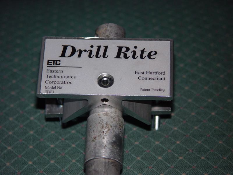

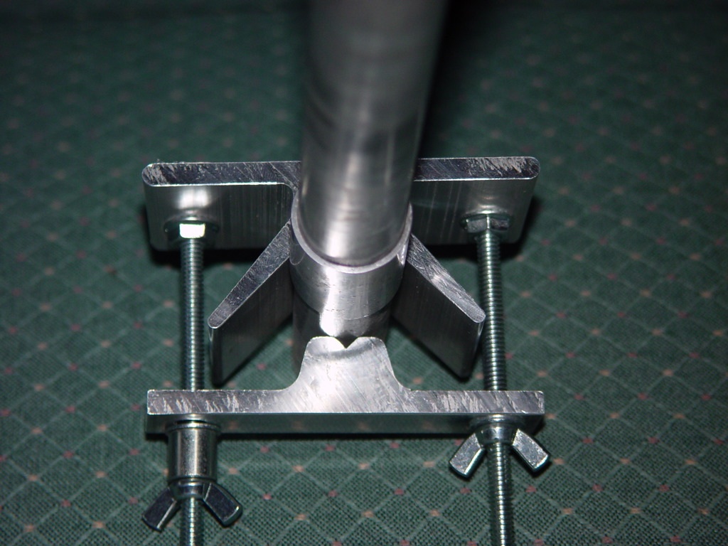

Here is what I use and it works perfect every time
 Filesize:  193.78 KB
 Viewed:  6776 Time(s)
 Filesize:  88.89 KB

That would be great to order for drilling the vertical stabilizer post, the drag strut, or the landing gear leg and the universal joint on the aileron control tube which would be drilled inaccurately. It might be used to drill an innumerable number of holes in small tubing used in the wing.

http://www.skygeek.com/eastern-edf1-drill-rite.html sells the drill guide.
