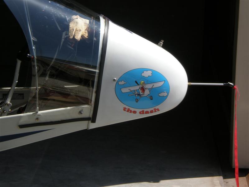

How would you use cheap house paint to do a small graphic detail on top of Polytone, on fabric, in order avoid buying some quarts of Polytone? You can get small sample cans of latex mixed colors at Lowes which are intended for people to use in choosing colors.
Or develop your graphic and find a sign outfit that does vinyl signs/car wraps. Got the attached "nose art", one for each side (flipped horizontally) for about $30-$35. The oval is about 10" across. Has worn like iron. Colors have not faded (even in FL sun).
