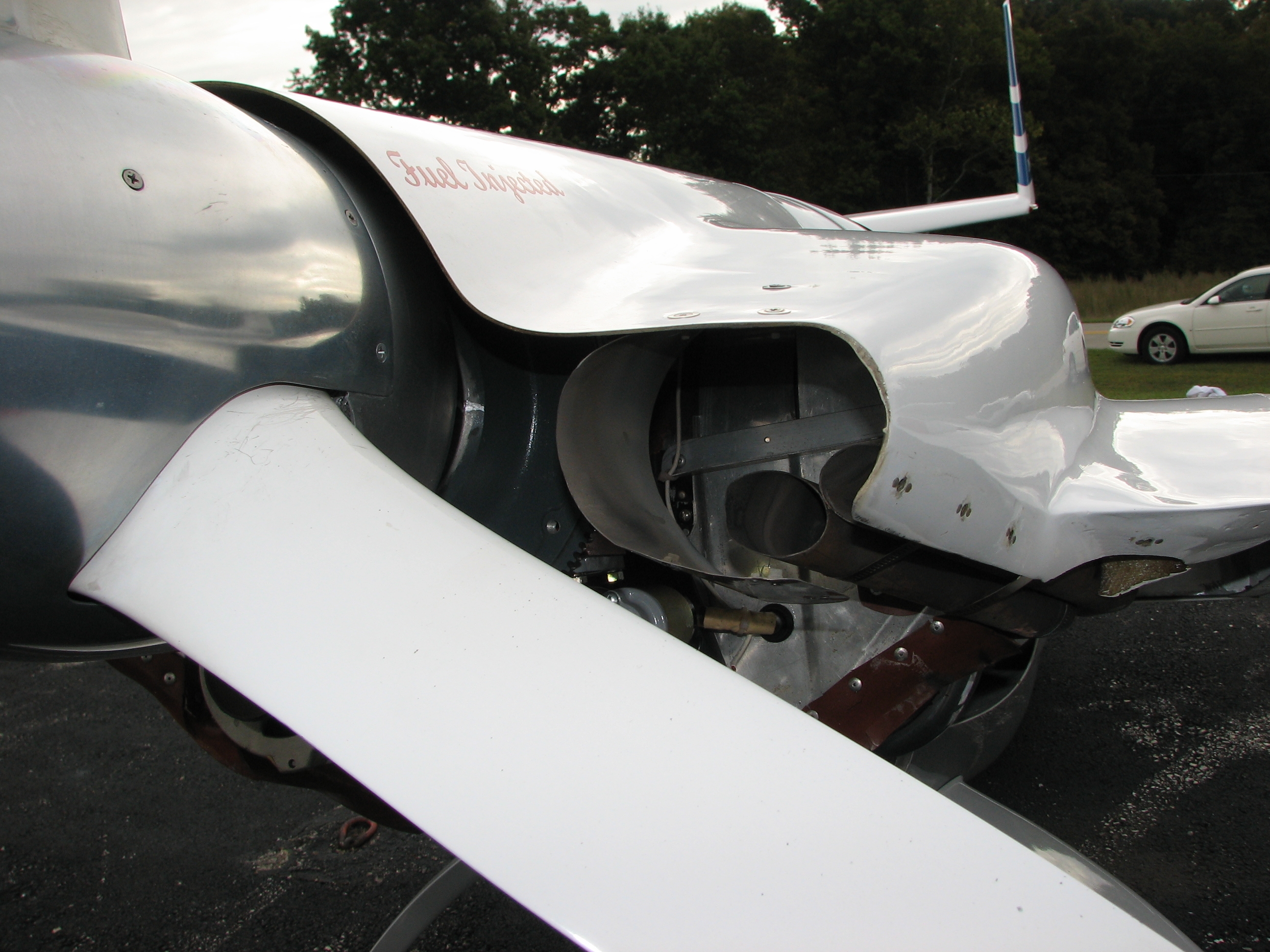

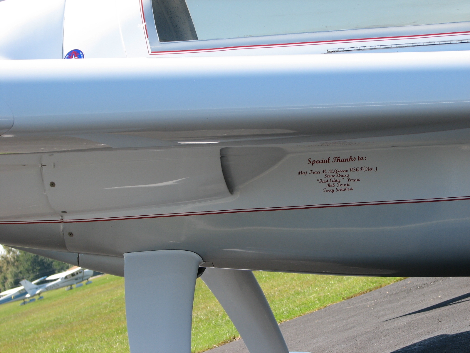

Frans
this is the USA Long EZ that was my mentor. He is based in Florida and has no cooling problems.Note the small cooling air inlets.
The third inlet is the engine breathing to the fuel injector servo.
Graham

On 06/11/2013 11:12 AM, GRAHAM SINGLETON wrote:
It would be worth researching exhaust extraction. I have it on my
Lycoming (pusher Long EZ) and it works
Warm day, full throttle on the ground for 10 minutes, throttle back and
it cools down from near red line..
I implemented exhaust extraction also in my Europa. No venturi, just the
exhaust tube shorter than the tunnel it is fed through. I could however
never establish that it is really working as designed. Fact is that I'm
unable to overheat the engine on the ground, but that can also be the
result of the completely different low drag cooling arrangement. Or the
Woodcomp propeller of course.

frans(at)privatepilots.nl
PostPosted: Wed Jun 12, 2013 6:36 am    Post subject: Woodcomp or Airmaster Prop Reply with quote
On 06/12/2013 02:42 PM, GRAHAM SINGLETON wrote:
Frans
Thanks for the picture! This looks quite like my own setup. I guess it
must be working then.
Frans
