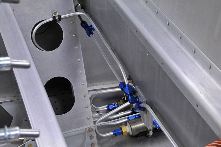

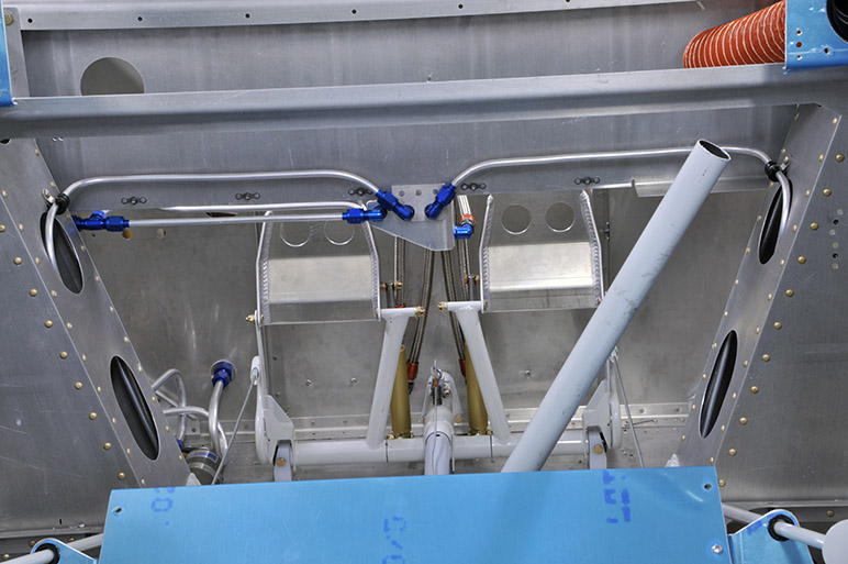

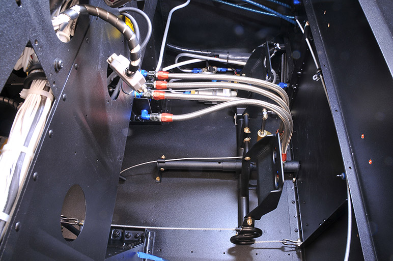

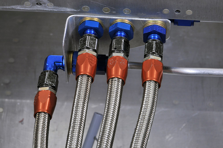

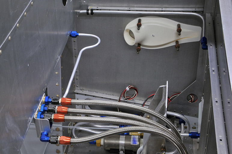

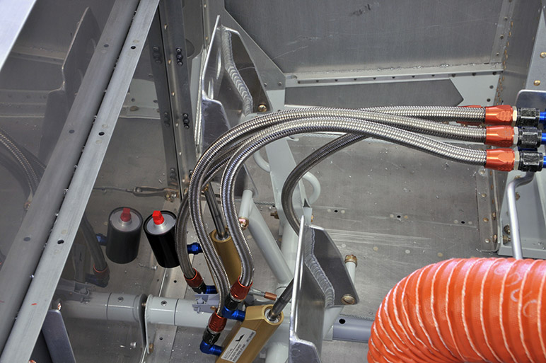

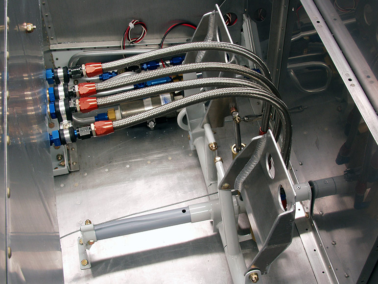

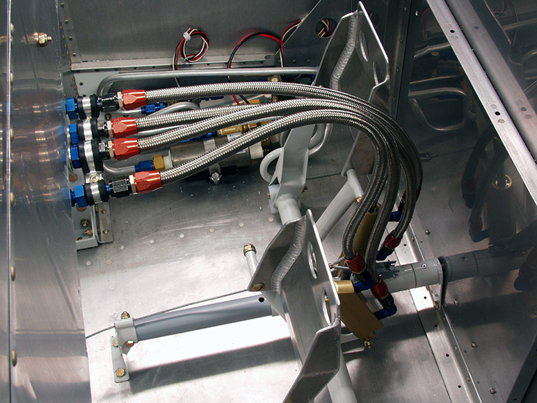

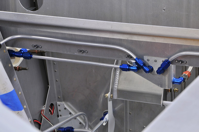

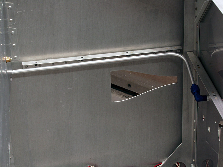

Hi Stan,
Here's how I did mine in the RV-8. Worked great. Took me three tries to get a scheme I was happy with.
Matt Dralle
RV-8 #82880 N998RV "Ruby Vixen"
http://www.mattsrv8.com - Matt's Complete RV-8 Construction Log
http://www.mattsrv8.com/Mishap - Landing Mishap Rebuild Log
Status: 172+ Hours TTSN - Rebuilding Fuselage After Landing Mishap...
RV-6 #20916 N360EM "The Flyer"
http://www.mattsrv6.com - Matt's RV-6 Revitalization Log
Status: 150+ Hours Since Purchase - Upgrades Complete; Now In Full Flyer Mode

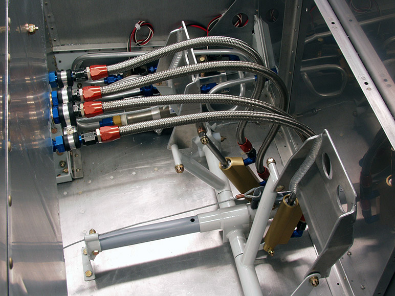

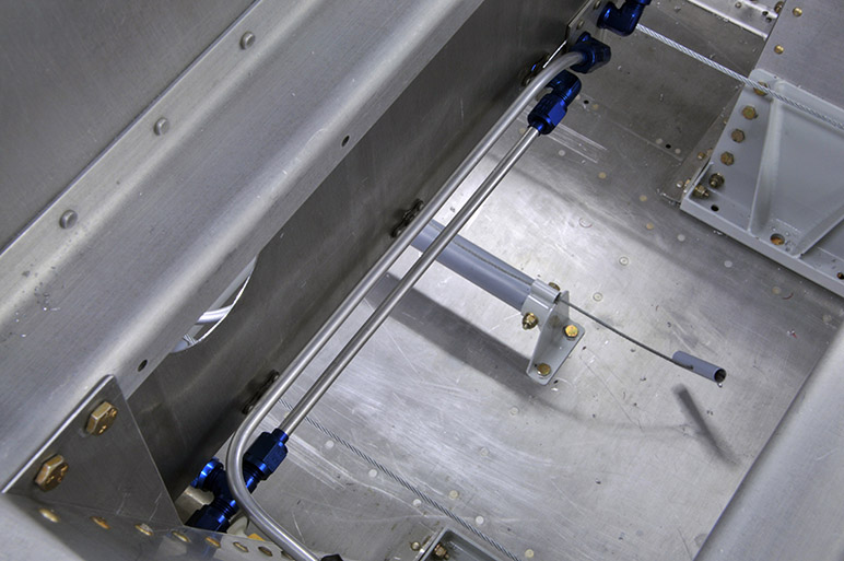

Hi Stan,
Matt Dralle
Whoops, I didn't mean for that picture of the Grove Mini Brake Fluid Reservoir to get into that set of pictures. The GMBF seemed like a good idea, but in reality, it stuck out too far and required that I pull the rudder peddles back one notch to clear the firewall when full rudder was applied. I didn't like losing any leg room so I scrapped the GMBF's and did the braid hoses as shown.
After I sent those pictures, I also realized that I had a slightly modified 4th revision. Attached are pictures of that version.
Matt Dralle

I used stainless steel braided lines from Summit Racing. Super easy to fabricate yourself to your exact dimensions.
