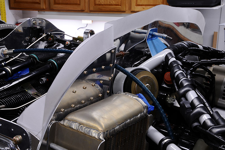

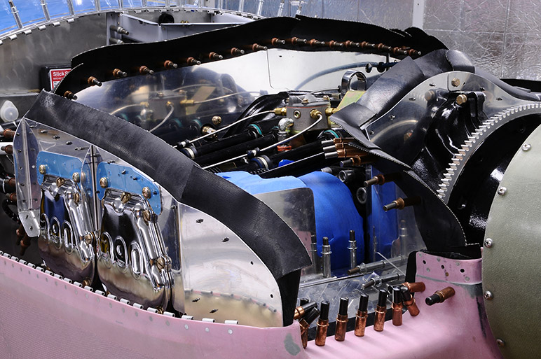

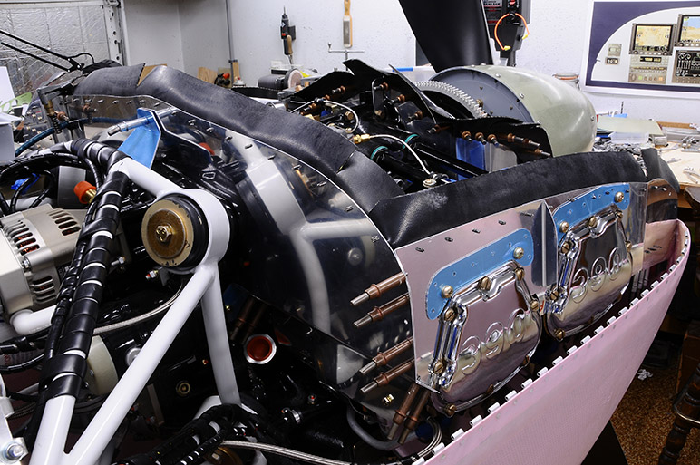

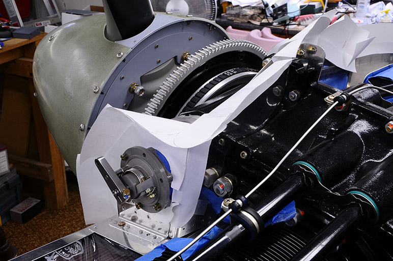

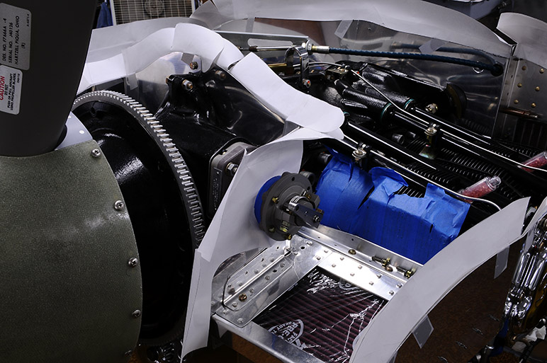

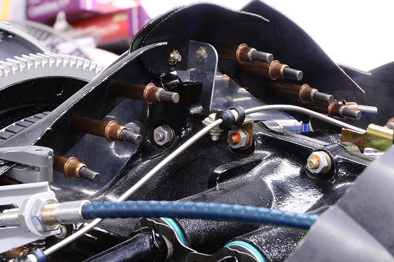

At 06:23 PM 3/13/2013 Wednesday, you wrote:

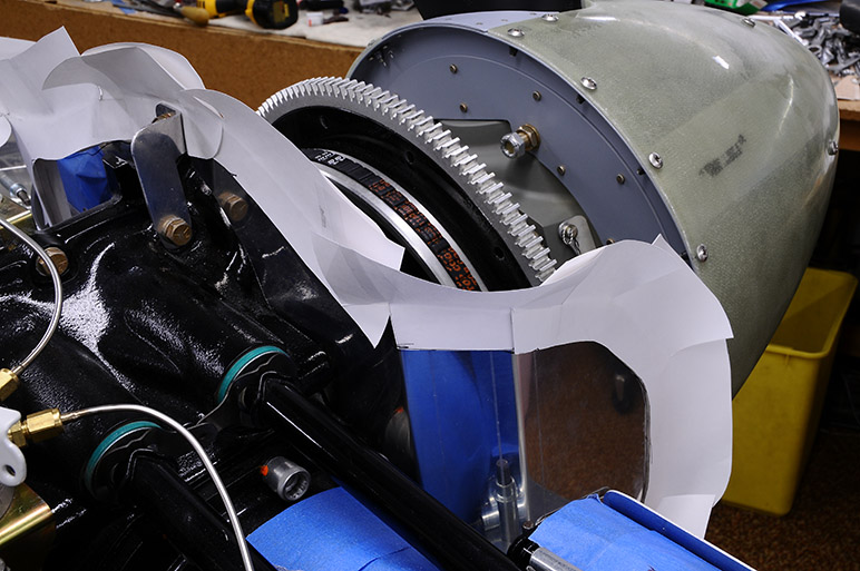

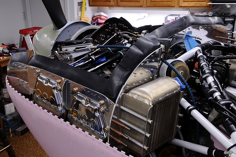

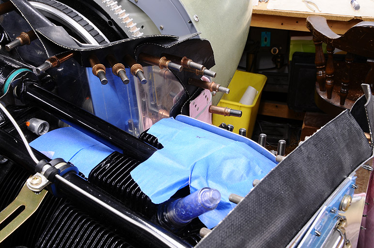

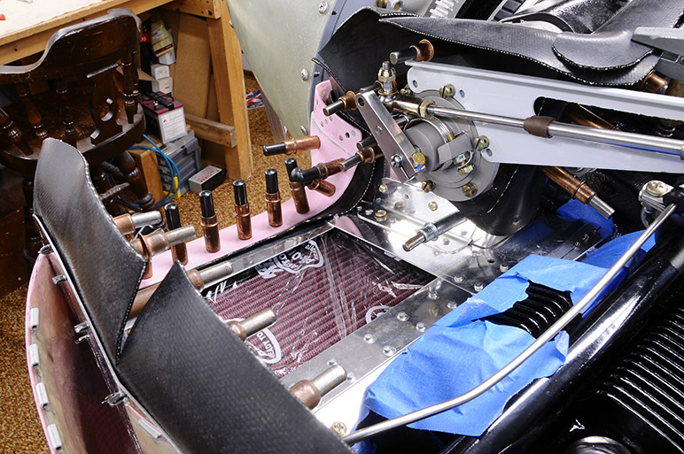

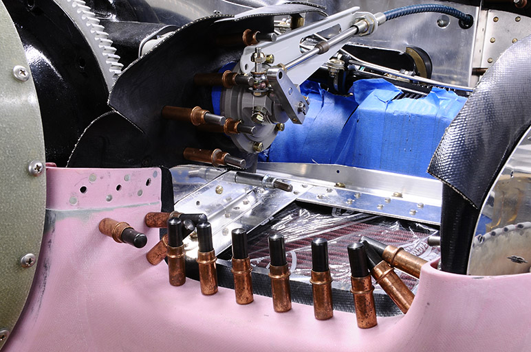

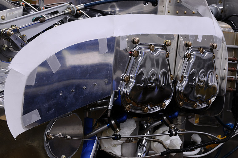

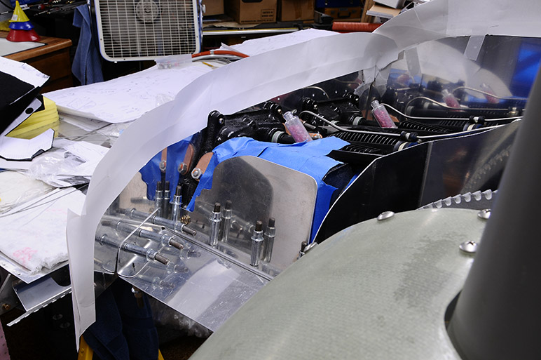

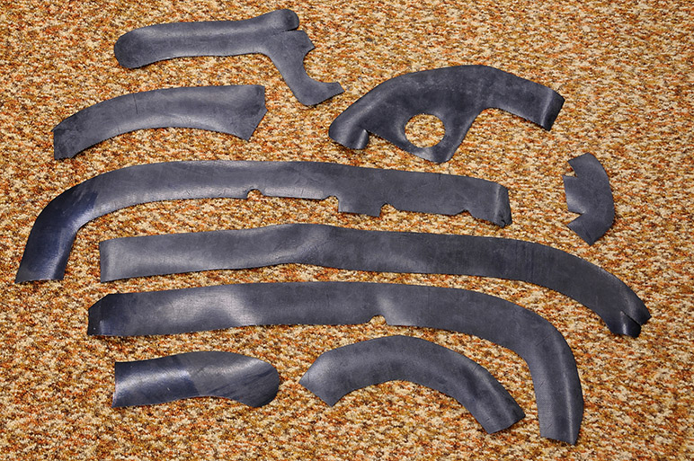

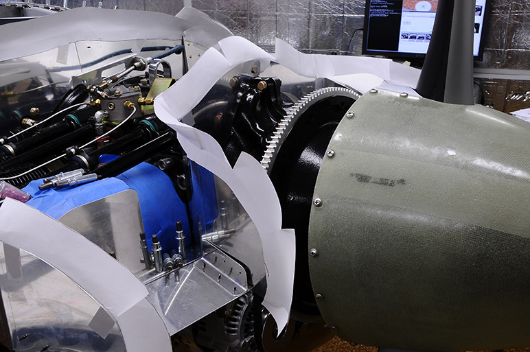

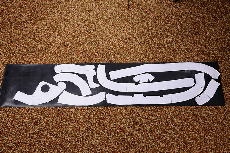

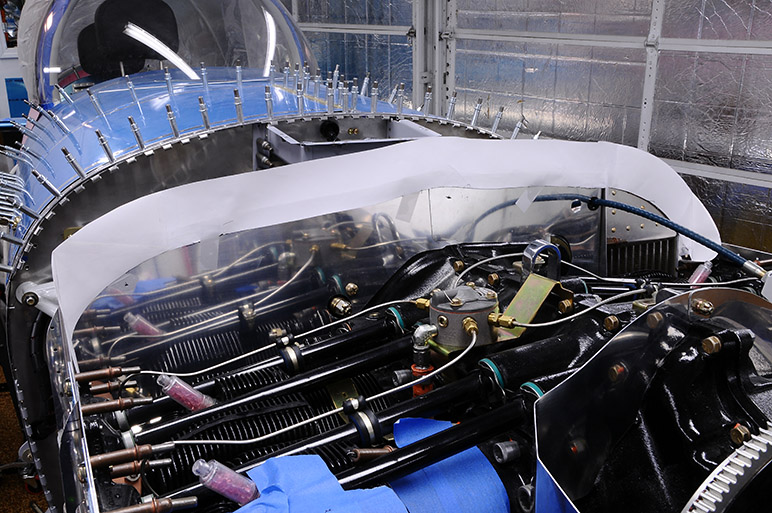

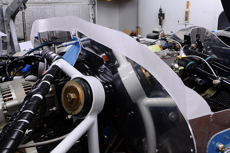

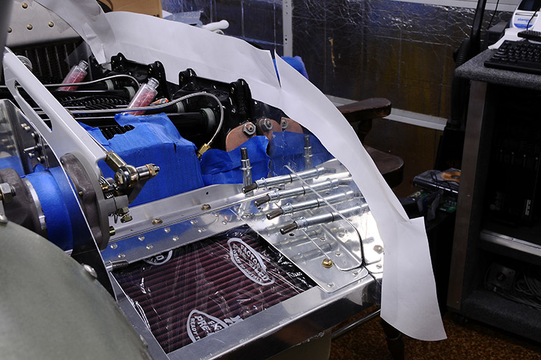

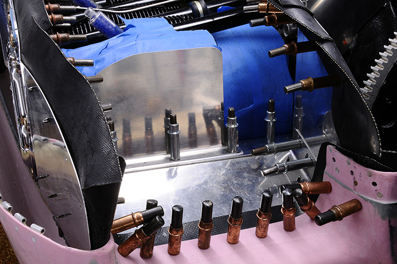

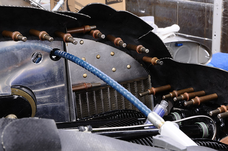

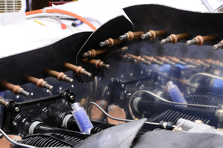

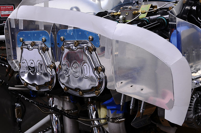

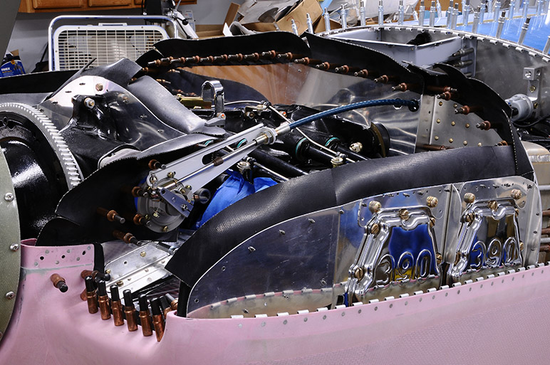

nearing completion of FWFD, having trouble visualizing the baffle seal plan around the front of the top cowling. I have the Van's cowling and IO-360 angle valve engine. If anyone has good pics showing how to fit the seals to stop the air flow in the upper front center area, I would appreciate seeing them.
Hi Dennis,
I've got an IO-390 with a front-mounted prop governor, but the seal layout is about the same. Attached are some pictures of how I did mine. I had no problems with CHT or EGTs.
Matt Dralle

PostPosted: Fri Mar 15, 2013 5:48 pm    Post subject: RV8a baffles Reply with quote
thanks for the pics, helps a lot.
