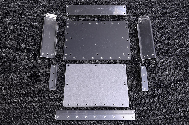

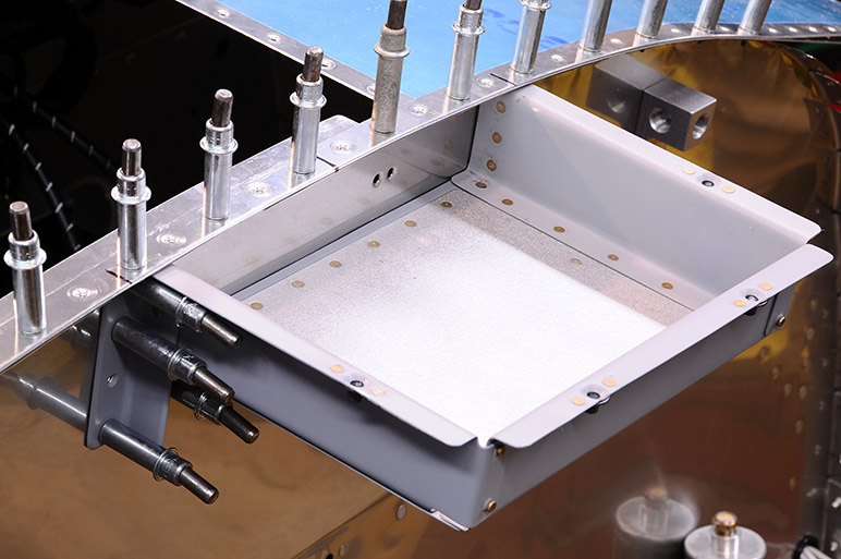

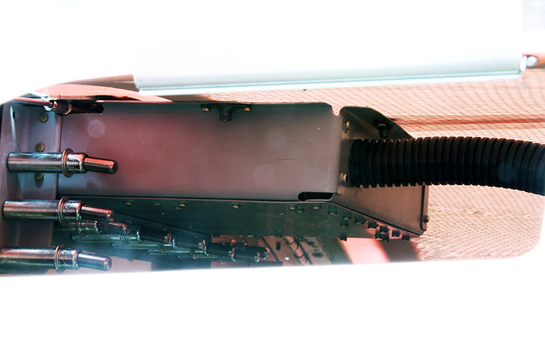

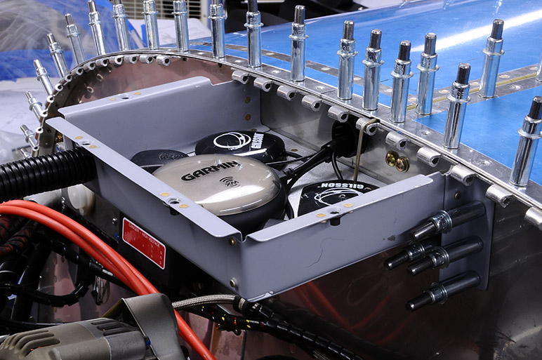

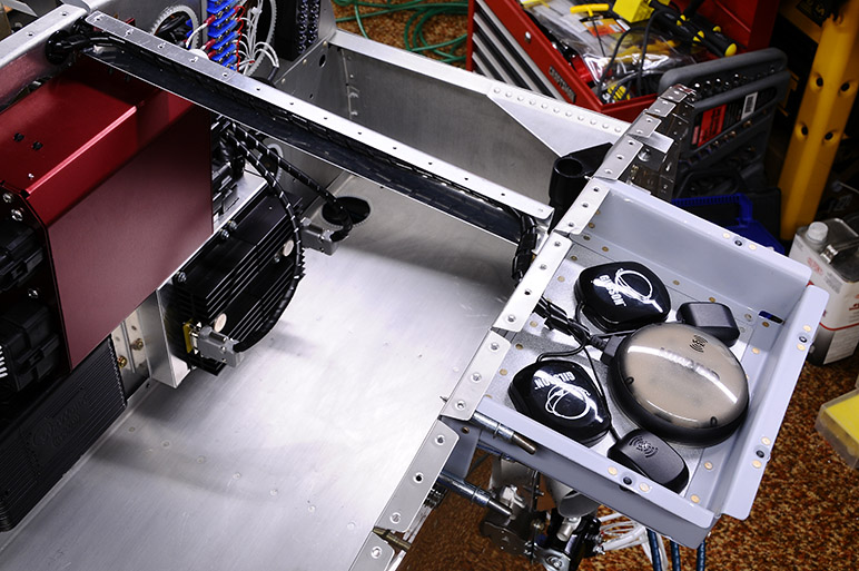

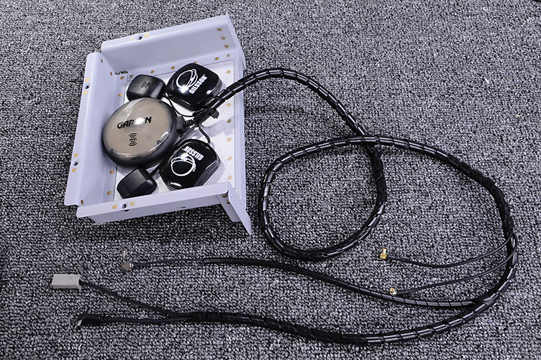

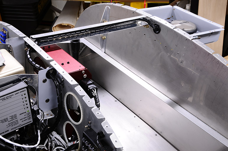

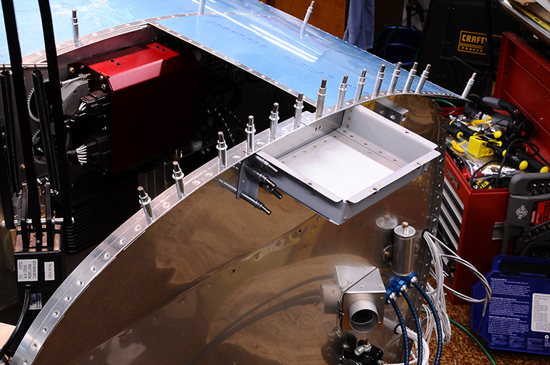

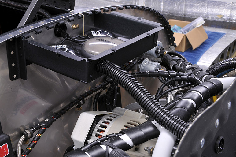

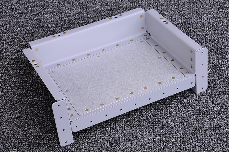

At 11:55 AM 3/12/2013 Tuesday, you wrote:
Someone on the RV-10 list shared a photo of their GPS shelf mounted FWF that had 4+ GPS antenna mounted. I recall the shelf was painted black and connected the firewall with the motor mount? Can the owner share the photo again with the group? I need something similar for my 8A and cannot locate the post.
Robin
Hi Robin,
Here are some pictures of how I did the GPS antenna installations on my RV-8. Works great. Blast tubes keeps them cool. No unsightly pucks on the dash!
Matt
