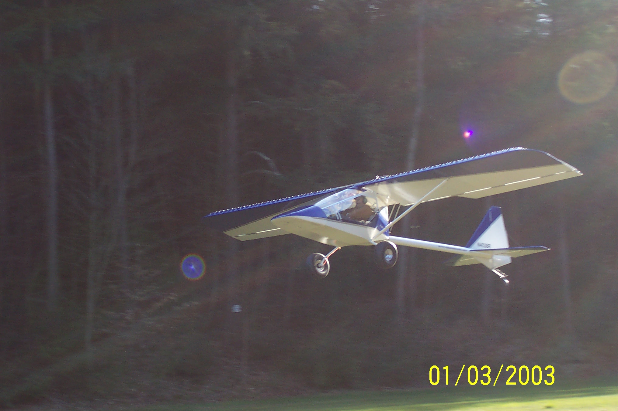

Another way to go for you guys with Mark 3s. Take a look at Rotax Ricks 670 engine. I traded in my 582 for one and put it on my Xtra. It puts out 89hp and gets about 1 gph better fuel burn. Basically performs like a 912 on a 582 budget. This is my first yr with it so not alot of time but I put 60 hrs on it this yr and it was flawless. Make the 2 place alot more fun to fly when you have the extra power.

Good looking bird....
wondering why the fuel burn is less than the 582? fuel Injection...running at lower rpm's? Herb
