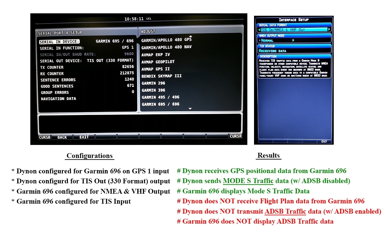

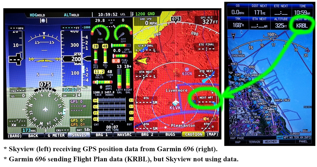

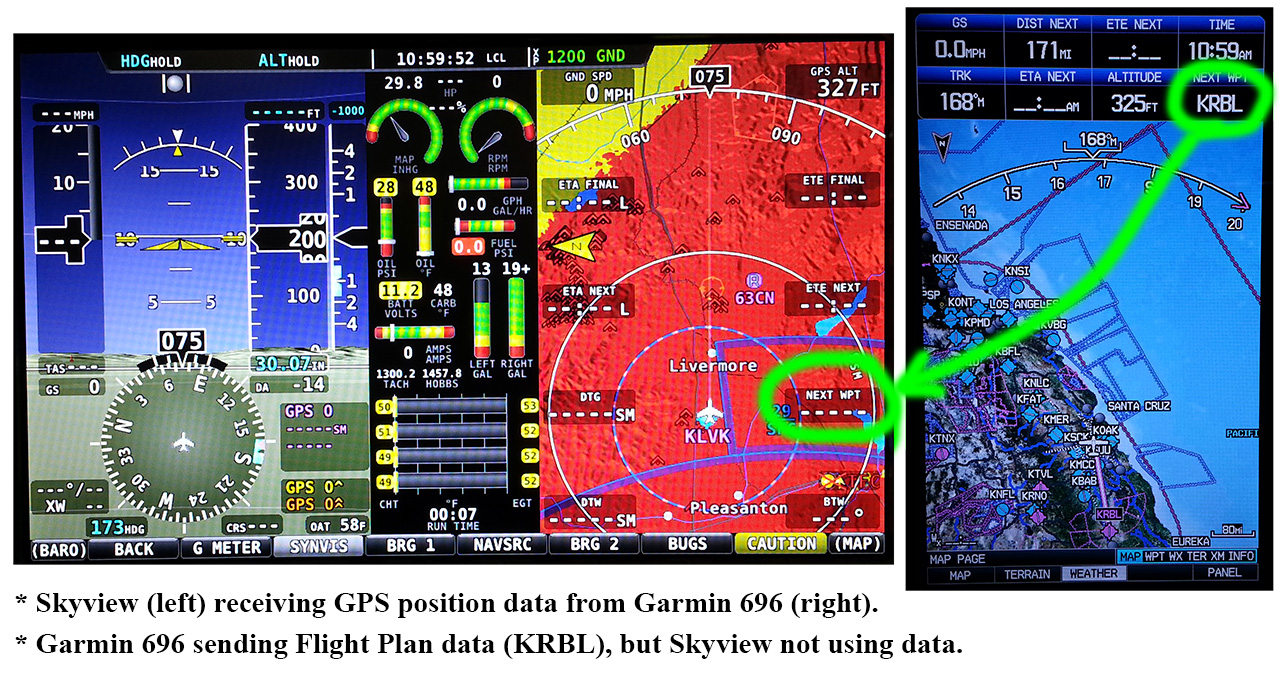

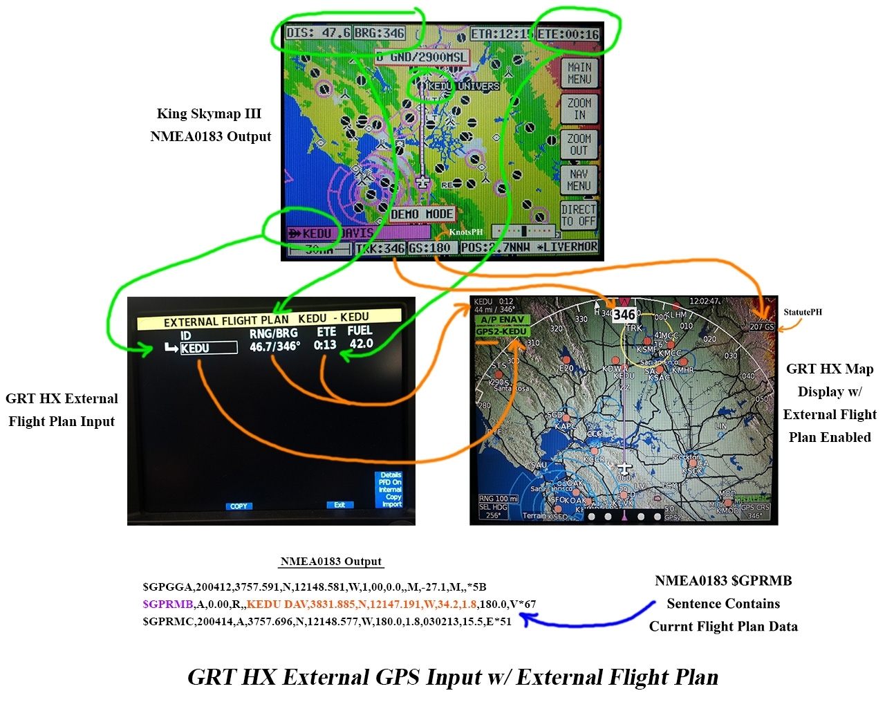

Dear Listers,
Below is a dialog that I'm currently having with Dynon technical support regarding the support for External Flight Plans on the Dynon Skyview. I have a Garmin 696 connected serially to the Dynon and use it for primary GPS positional data. I would like to also have it transfer the current flight plan data as its a LOT easier to look up remote airports, etc. on the Garmin696. But, for some reason, the flight plan data doesn't seem to propagate to the Skyview; I can only assume because the Dynon is ignoring the GPRMB NMEA0182 data fields.
In contrast, I have a King Skymap IIIc connected to the GRT HXs in the RV-8 (for testing) and I am able to easily get external flight plan data from the Skymap to the GRT HX over the serial line (see screen shots)
Finally, with the new ADSB receiver on the Skyview, I'm no longer getting Traffic data on the Garmin 696. With just the Mode S transponder, I get traffic targets when I'm in traffic areas so the TIS data link (Skyvew->Garmin696) seems to be working. But as soon as I enable the ADSB receiver, I no longer get the traffic on the Garmin 696 even though the ADSB traffic is showing up on the Skyview Map and PDF displays.
Below are some composite screen shots I made for Dynon with embedded comments and documentation to describe what I'm seeing. I thought I'd share with the rest of the group in case someone maybe had some feedback or thoughts.

At 10:36 AM 2/1/2013 Friday, you wrote:
[quote]Matt,
Please do send some screen shots. We will fly a flight plan from the Garmin. Do you see the CDI on the HSI?
I can make sense out of this with a picture.
Mike H
