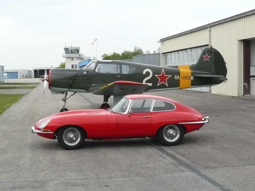

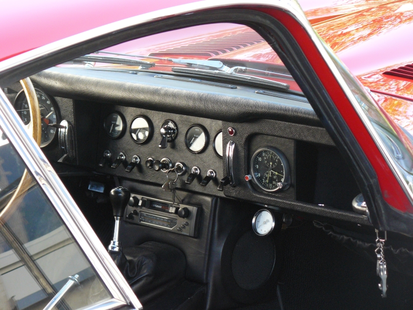

PostPosted: Thu Jan 17, 2013 11:45 pm    Post subject: Re: Russian time piece Reply with quote
Vic.
I just have to ask, what is that beautiful auto you have the Russian time piece mounted in?
Coop.
Coop
Vic
Joined: 12 Aug 2008
Posts: 117
Location: Southern Bavaria
PostPosted: Fri Jan 18, 2013 5:32 pm    Post subject: Re: Russian time piece Reply with quote
Hi Coop,
this MIG clock lives in a 3.8 Jag E-Type Coupé. We found the clock at 50 dollars in an autojumble in Munich in 1993 when the Iron Wall was down and loads of great eastern products were converted to western currency by "private exporters". Many years later we found another MIG clock but this time the price was considerably higher, definitely. The owner would only give it away in a set. So we accepted the Yak to go with it.
Cheers
Vic
 Filesize:  328.02 KB
 Viewed:  9608 Time(s)
