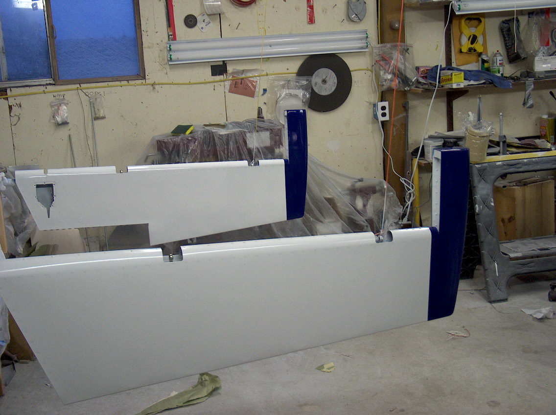

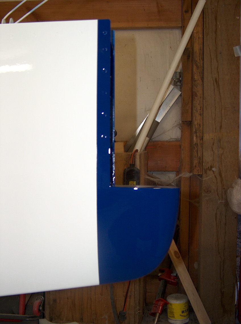

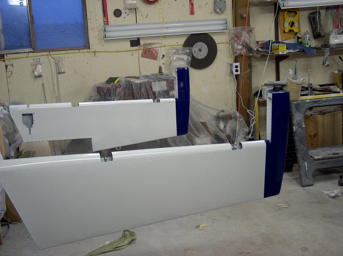

PostPosted: Tue Jun 06, 2006 2:04 pm    Post subject: Painting Reply with quote
Thanks Larry I thought it would be like my first welds...I.e an
unmitigated disaster and waste $1000 in paint, but its awesome to see
the fine result.
I'll attach a pic, don't know if it will work but lets see.
Frank

HVLP gun!
OK I'll have my buddy pick one up and I'll try it out...I have the
borrowed one so it would be a good side by side comparison. I should
have some trim I could paint tomorrow so I will report back on how well
it works...If its like the one I borrowed its just so sweet..More like
an airbrush than a spray gun...Smile

frank.hinde(at)hp.com
PostPosted: Wed Jun 07, 2006 10:27 am    Post subject: Painting Reply with quote
Actually no you won't...Well "getting away with" is not a term that
works when pinting an airplane. Remember I only got good results by
turning UP the pressure. The 20Oz gun requires (they say) 28psi...I got
marginal to poor results (i.e BAD orange peel) at 28psi and excellent
results at 50 psi.
I tried 55psi this morning but the results did not improve so I will go
back to 50psi from now on.
The touch up gun I also run at 50psi and the results were just stunning.
Frank
PostPosted: Fri Jun 09, 2006 7:18 am    Post subject: Painting Reply with quote
Bought the detail gun and indeed it had "HVLP" stamped on the side and
appears identical to the one I am borrowing.
I have not used it yet but have no doubt it will proovide excellent
results.
Frank
