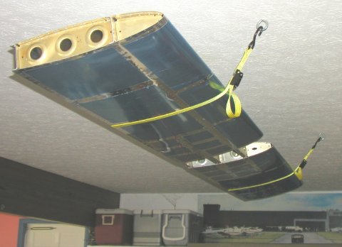

Here is my HS, "flying" from the garage ceiling.
   I closed the rudder with the new version of the Proseal, in the self mix caulk tube. Very easy to work with, lots of extra mixed material wasted..... clean up is easy if you dont touch the stuff.  I was able to dispense directly to the inside surface of the right skin, then place the trailing edge piece a few clecos from underneath, and add a layer of proseal and then the left skin, without touching the stuff.
Steve

Looks like it's flying pretty good.  Nice job.
