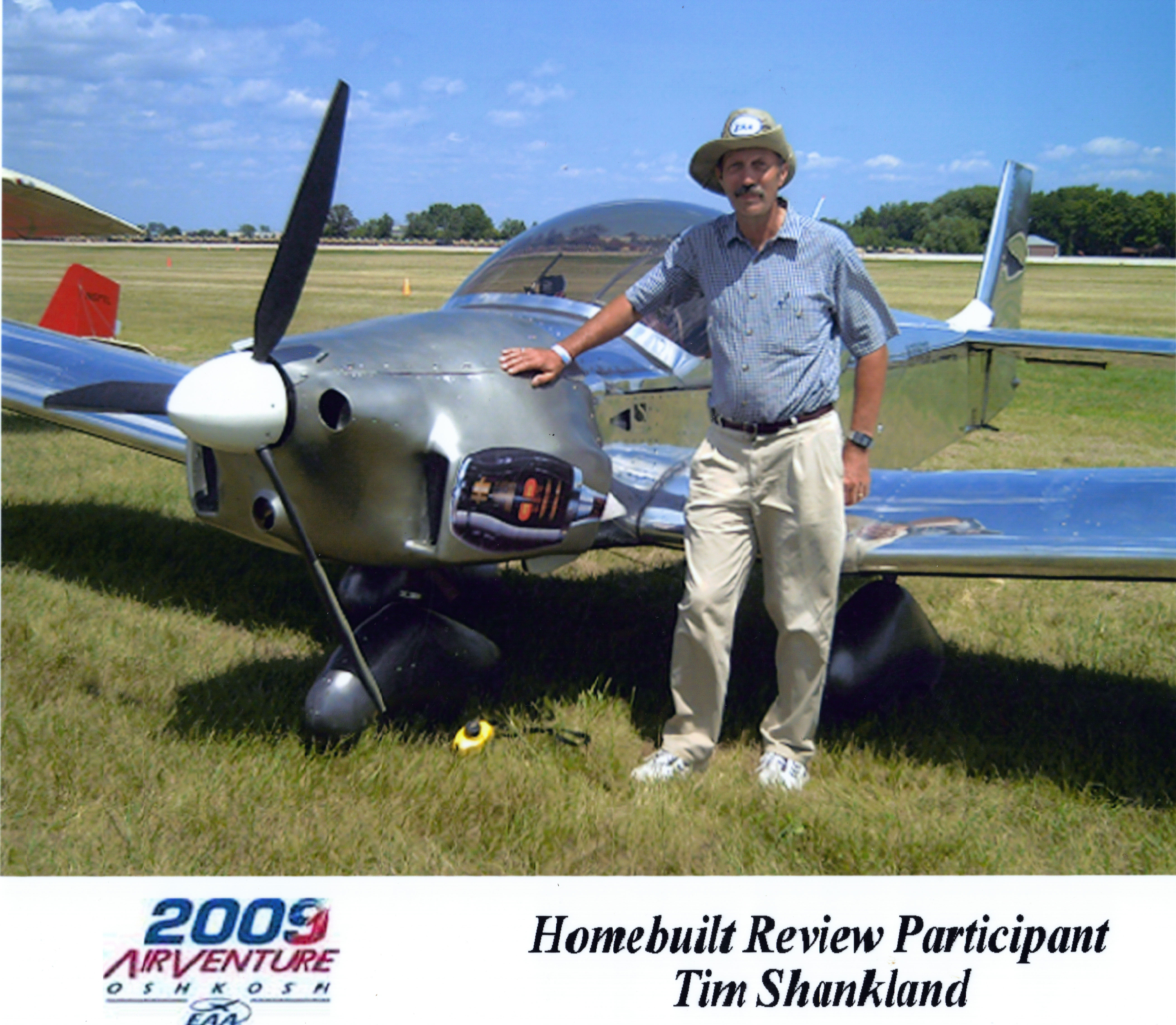

Don,
I did not like the under the fuselage placement in that both engine heat and exaust flow through the radiator. I mounted two heater cores to the sides of the engine and a third smaller core on the firewall to be used for cabin heat. When the cabin heat is not in use heat from this one flows overboard contributing the the cooling. In the attached picture you can clearly see the left side and part of the right. Air entering the hole under the prop is directed by partitions in the cowling to flow across the oil pan. There are two more cooling holes on either side of the prop, part of one has a duct to the cabin heater and part of the other a ram tube that directs air over the oil filter.
Tim
