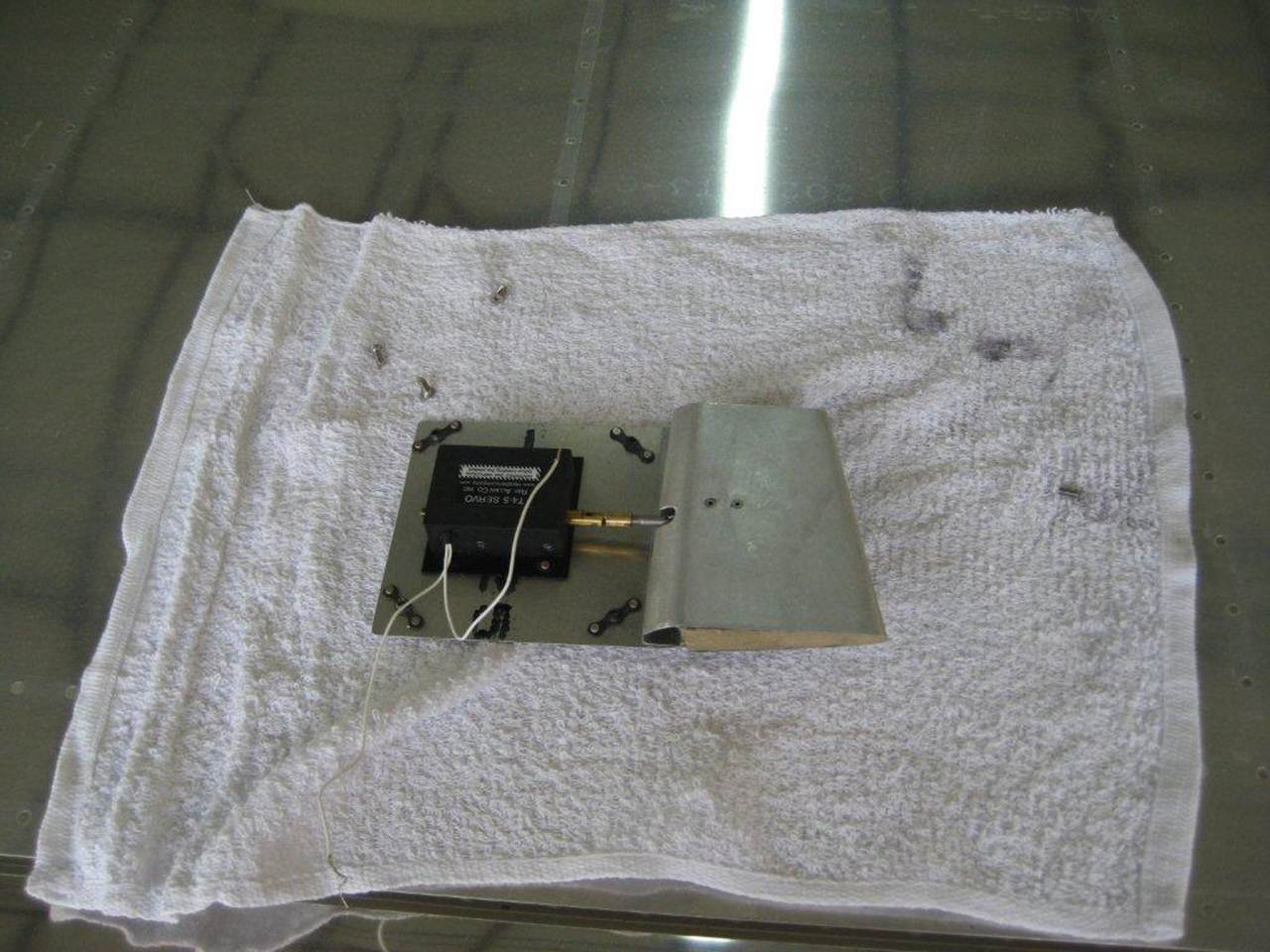

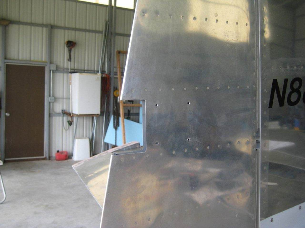

PostPosted: Sun Nov 04, 2012 5:37 am    Post subject: RV-10 Rudder trim Reply with quote
Hi Carlos.
To answer your question, AFAIK there isn't. Most of the rudder trims I've seen are wedges affixed to the rudder trailing edge, followed by hinges operated by Ray Allen trim motors .... followed by by a moveable tab cut out of the rudder.
I'm afraid I'm walking down the path to mental illness. That KISS thingy is starting to look pretty darn good.
I'm wiring. And wiring. And wiring. That 6-pack of steam gauges is looking better all the time. I have dual, independent flat panels with autopilot and engine monitor.
Because I had a stroke of lunacy I am installing the hinge-type trim on the ailerons and rudder operated by model airplane servos. I had to build up a mocrocontroller to create the pulse width to operate the servos, write the code and add a power supply to drop the 12V to 5. Why? Because I can. But it seems like anytime I deviate from the plans it adds 6 months to the build time. Some longer. At this stage in the build my recommendations would be to build the airplane stock and deal with the idiosyncrasies when it's flying. Which I still hope to do someday.

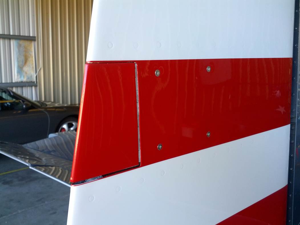

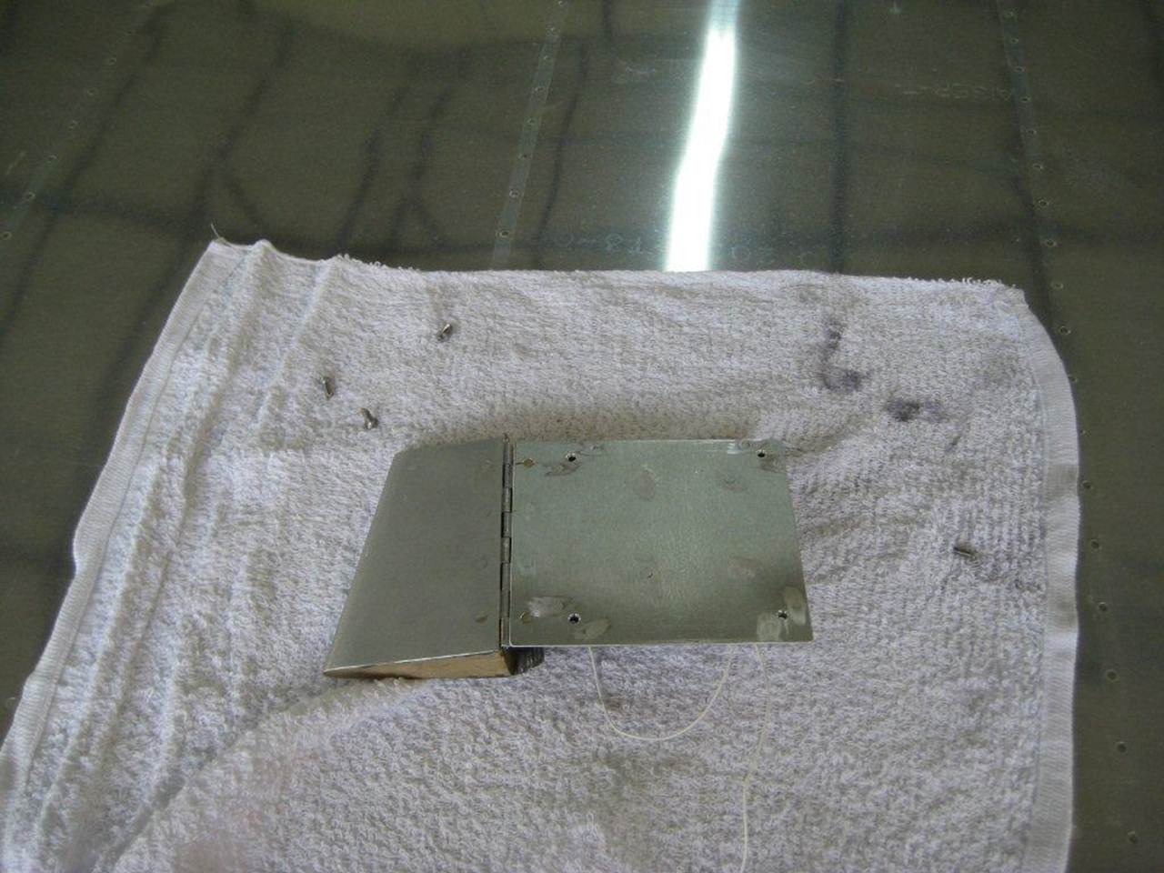

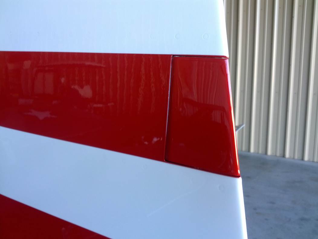

PostPosted: Sun Nov 04, 2012 6:25 am    Post subject: RV-10 Rudder trim Reply with quote
Carlos the only electric rudder trim you
Must make. Aerosport products offers
A rudder trim that is not electric but installs in most RV-10s in around 1 hour. It works very good and another advantage is it keeps the rudder
From flapping in the wind while parked.

PostPosted: Sun Nov 04, 2012 6:26 am    Post subject: RV-10 Rudder trim Reply with quote
Take a look at Aerosport Products rudder trim. It's simple and doesn't require any major modifications to the airframe. It can be installed in under an hour.

PostPosted: Sun Nov 04, 2012 7:04 am    Post subject: RV-10 Rudder trim Reply with quote
Carlos,  Geoff's system is much quicker and easier.  I probably spent 30 hrs (I seem to be a "slow builder" though) building my electric rudder trim system. I've got about a dozen word documents I could send you but I think after seeing the process I went through, the spring biased system is much easier.

get the job done very quick. I added rudder trim in one
evening, to a flying plane. No need to build special

That VAF link you sent is basically my (actuall Vic S's)
rudder trim. It took me one night to cut the hole and
add the doubler and servo. I guess add another evening
for getting the parts painted and ready. But, it was pretty
easy. It wasn't super cheap just because I bought the
Ray Allen parts, but otherwise was not at all complicated
and works really well at least, so the reward paid off.

Regarding Rudder Trim I have shared my link in the past to the trim on my -10::
http://painttheweb.com/painttheweb/rv-10/RudderTrim.aspx
It was our first attempt and was done on an already built rudder. No problems, works great and I am very happy to have electric rudder trim. No need for the position sensor because you can use your ball as the position indicator.
On my 8A Rudder Trim which was also installed on an already built rudder (we never do anything the easy way!) we were able to get the entire leaver arm inside the rudder so no additional items sticking out into the wind. This one turned out ultra clean and looks great (IMHO). It also functions well in flight. Servicing the trim mechanism is as simple as removing the 4 #8 screws and pulling out the trim tab and attached servo tray (much like pictured on the -10 but w/o the position sensor).
Robin

PostPosted: Mon Nov 05, 2012 3:52 pm    Post subject: RV-10 Rudder trim Reply with quote
Why since you asked so nicely here you go…
Robin
From: owner-rv10-list-server(at)matronics.com [mailto:owner-rv10-list-server(at)matronics.com] On Behalf Of Bob Condrey
Sent: Monday, November 05, 2012 2:07 PM
Subject: Re: RV10-List: RE: RV-10 Rudder trim
Robin - got any pictures of how the lever arm is set up inside so it all fits with nothing exposed?
Bob
On Mon, Nov 5, 2012 at 3:06 PM, Robin Marks <robin(at)painttheweb.com (robin(at)painttheweb.com)> wrote:
Robin

On 11/4/2012 7:36 AM, Linn wrote:
Hi Carlos.
Robin
