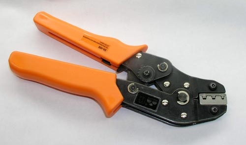

A few weeks ago I mentioned a find on eBay for
a b-crimp tool for $20 postage paid.
[img]cid:7.1.0.9.0.20121008085015.01e25b88(at)aeroelectric.com.0[/img]

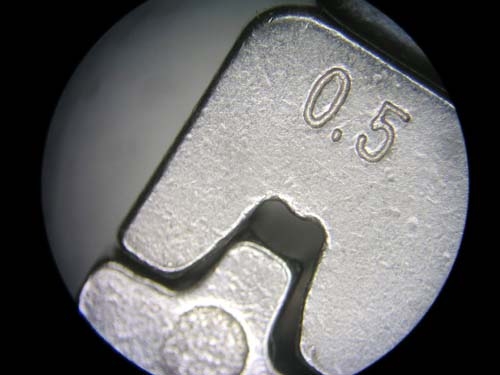

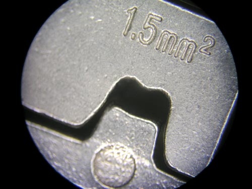

The picture looked good but you couldn't see die details
in the ad. I ordered one and produced the following pictures.
[img]cid:7.1.0.9.0.20121008085015.01e25b88(at)aeroelectric.com.1[/img]
[img]cid:7.1.0.9.0.20121008085015.01e25b88(at)aeroelectric.com.2[/img]
This isn't an AMP or Molex tool but the dies are the right
shape. The big disappointment was that I couldn't find a b-crimp
terminal anyplace in my goodies with which to try it out. I'll
be going to Wichita next weekend for some remodeling supplies,
I'll find some terminals and report further.
In the mean time, I wouldn't discourage any of you from acquiring
one of these. The price is right. I don't the smallest die will
close sufficiently to do d-sub b-crimp pins but it should handle
everything larger like the AMP strobe supply connectors and possibly
down to the .060" miniature pins in Molex connectors.
