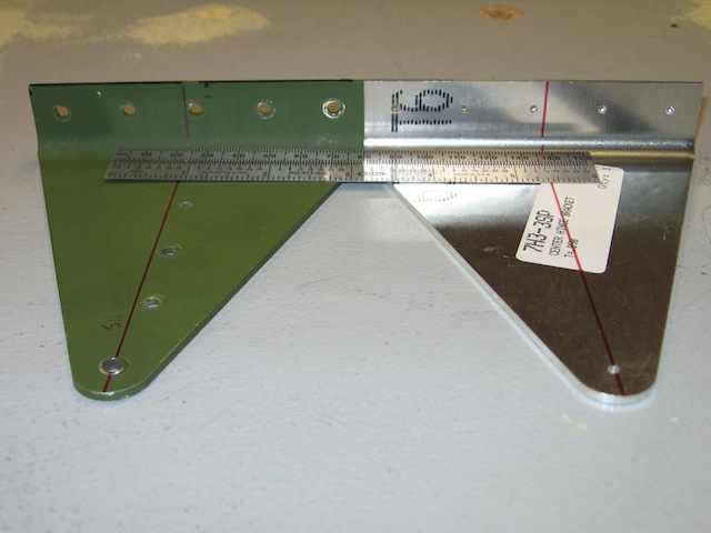

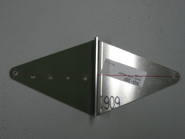

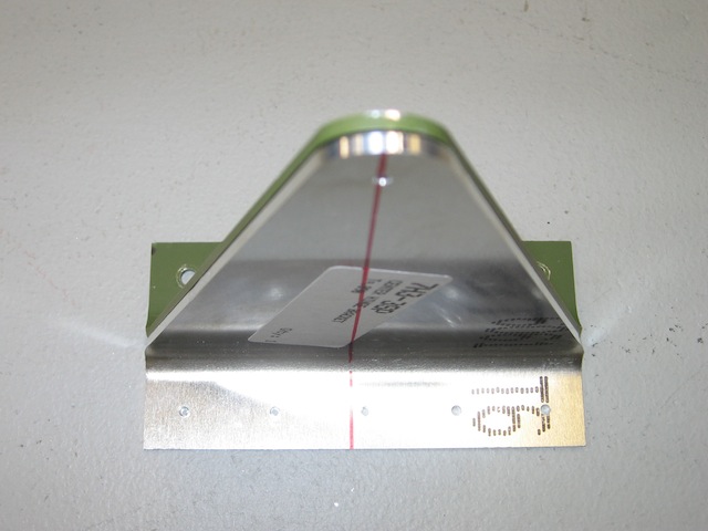

Perry,
Not sure if you're having a similar issue as I did without photos of the misalignment, but what happened in my case (a CH701) was that part #7H3-3-SP was bent the wrong direction and was actually a mirror image of what it was supposed to be. The angle is NOT symmetrical, and caused a misalignment up and down. Don't remember now whether it was too high or too low. Anyway, called Zenith and they sent a replacement bent the correct way. Please see attached photos. Hope this helps.
Richard

pdelano(at)telus.net
PostPosted: Sat Oct 20, 2012 11:25 am    Post subject: Center Hinge Elevator Reply with quote
Hi Richard,
Mine seemed to be bent the right way. And per my earlier message to Tommy all seems to be fine. Although the elevator skin is still a mystery what way it was bent. Between Caleb and myself we sorted out a fix for that.
Perry
