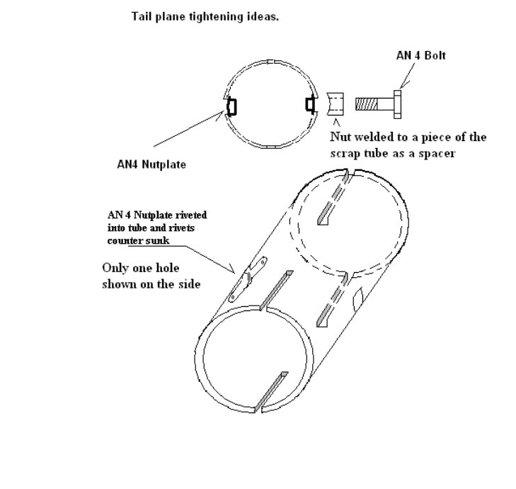

budyerly(at)msn.com
PostPosted: Sat Oct 20, 2012 1:36 pm    Post subject: Mod 73 - slightly different Reply with quote
 <?xml:namespace prefix="v" /><?xml:namespace prefix="o" /><![endif]--> [img]cid:00e401cdaf0a$3B2B00E7(at)goldfishbk2xxe[/img][img]cid:00e501cdaf0a$3B2B00E7(at)goldfishbk2xxe[/img] Photo E-mail [url=https://skydrive.live.com/redir.aspx?cid=2161856909618aa7&page=play&resid=2161856909618AA7!280&type=5&authkey=!ANjvqrEIxO9rAbE]View slideshow [/url]| [url=https://skydrive.live.com/redir.aspx?cid=2161856909618aa7&page=downloadphotos&resid=2161856909618AA7!280&type=5&authkey=!ANjvqrEIxO9rAbE]Download images [/url] Stephan,
Richard did a great job on his mod. I have attached a drawing of our solution which differed only in that the nutplates were riveted to a tube horizontally and 1/4 inch bolts used. (see drawing) It was never submitted as I had a local machine shop that could put out the work for about $300 and make new holes and pins, or if the 3/8 pins weren't installed yet, we could machine the holes to a zero tolerance fit. A drop of Loctite or two and the whole thing stayed solid for so far, 3 years. So we dropped pursuing the idea. Richard's mod 11969 is a perfectly sound solution that should work. I just felt that Redux on the nutplate was a bit tedious when a rivet could be put into a steel tube quickly. I used a 1 1/4 inch tube (Sloppy fit for ease of moving into position into an existing stab, slotted it on the bandsaw, slid it in and marked the holes with a centering punch (inserted into a 1/4 inch tube to center the punch on the hole and gave it a try. A $10 experiment, that works, but it too is tedious. When Roger Bull came out with the Loctite solution and got it all approved, I sure liked not having to go through approvals when what he did works. You know us Yanks, instant gratification.
Bud Yerly
[url=https://skydrive.live.com/redir.aspx?cid=2161856909618aa7&page=play&resid=2161856909618AA7!281&parid=2161856909618AA7!280&type=1&authkey=!ANjvqrEIxO9rAbE][img]cid:00e601cdaf0a$3B2B00E7(at)goldfishbk2xxe[/img][/url]
