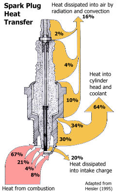

But what's this, its recommended by Rotax on 4 stroke engines especially the 914 to spread the heat load.
Product ID: HTC
4 STROKE HEAT TRANSFER COMPOUND Details
1 ml is enough for 1 set of 8 spark plugs.
http://www.skydrive.co.uk/products.asp?cat=51
Can any body tell me why the 914 plugs are £9.78
Alan

Rotax 912/914 engines require heat sink compound on the plug threads to transfer heat from the plug to the head.
Pete

As I mentioned there are different anti-seizes for different heat ranges.  Some do contain metals and both copper and silver will transfer heat faster than steel or stainless steel.  BUT!  To take that little bit of information of heat transfer and call it a Heat Sink Compound is only Advertising Bunk.
Think of it this way... What would transfer heat better:
a> A solid hunk of steel without any gaps or dissimilarities in molecular construction or
b> Two pieces of dissimilar metals with gaps between them, gaps that are being held together only by a tension force (screwed together)(spark plugs)?
Obviously the solid would do better in heat transfer.
And if heat sink was so important, why doesn't the two cycle engine use ANYTHING on the spark plugs?  Which engine produces more heat, four cycle or two cycle?
A: [Two cycle]
And if this 'advertised' heat sink compound did anything why isn't the heat range changed on the spark plug?
Ya can't mess with physics but you sure can mess with the uninformed consumer's head.  Just look at women's make up and wrinkle commercials.  And men are no better.  Which Gas is best, which Oil is best, which Tires are best... Oh, don't put air in your tires use Nitrogen.  Use Thin Silicone baffle seals, they are more flexible... NO!  Use Thick Silicone baffle seals they are stiffer, they put more force against the sealing surface.  Want more?  I can write a book on it.  And I would, IF I knew it would sell.
A: [Two cycle]
Barry and all,
Good point.
This strange recommendation from Rotax is not supported by simple physics :
Only 20/30% of spark plug total heat rejection is by way of the thread,
so even if a little paste did improve heat transfer by say, 20 %, the
plug heat rejection would improve only by 5 to 6 %...
What DOES work on the other hand, is providing adequate head cooling : a
properly cooled head is the best heat sink one may dream of to have
cooler plugs.
BTW, what is proposed as heat sink compound by a well known European
importer, is actually *copper antiseize* and yet no adverse effect on
the thousands of engines flying in this area.
So real heat sink might not be so necessary after all...
Best regards,
Gilles
http://contrails.free.fr

Well, just for the sake of it. The insulator in a spark plug runs at 1000 to 1300 degrees. Too cold and the plug can't burn off the carbon and combustion residue, too hot and you risk detonation and destroying your engine. Having the spark plug torqued into the cylinder head is essential for the cooling path of the plug. Read the article in Sport Aviation about the Cirrus owner who got his airplane back from annual with a plug severely under torqued. Cylinder head temperature, as recorded by the aircraft's engine information system peaked at almost 700 degrees. In less than five minutes the piston was holed and the owner had an emergency on his hands.
Rick Girard
On Thu, Sep 6, 2012 at 7:43 PM, Gilles Thesee <Gilles.Thesee(at)ac-grenoble.fr (Gilles.Thesee(at)ac-grenoble.fr)> wrote:
A: [Two cycle]
Barry and all,
Good point.
Only 20/30% of spark plug total heat rejection is by way of the thread, so even if a little paste did improve heat transfer by say, 20 %, the plug heat rejection would improve only by 5 to 6 %...
What DOES work on the other hand, is providing adequate head cooling : a properly cooled head is the best heat sink one may dream of to have cooler plugs.
BTW, what is proposed as heat sink compound by a well known European importer, is actually *copper antiseize* and yet no adverse effect on the thousands of engines flying in this area.
Best regards,
Gilles
