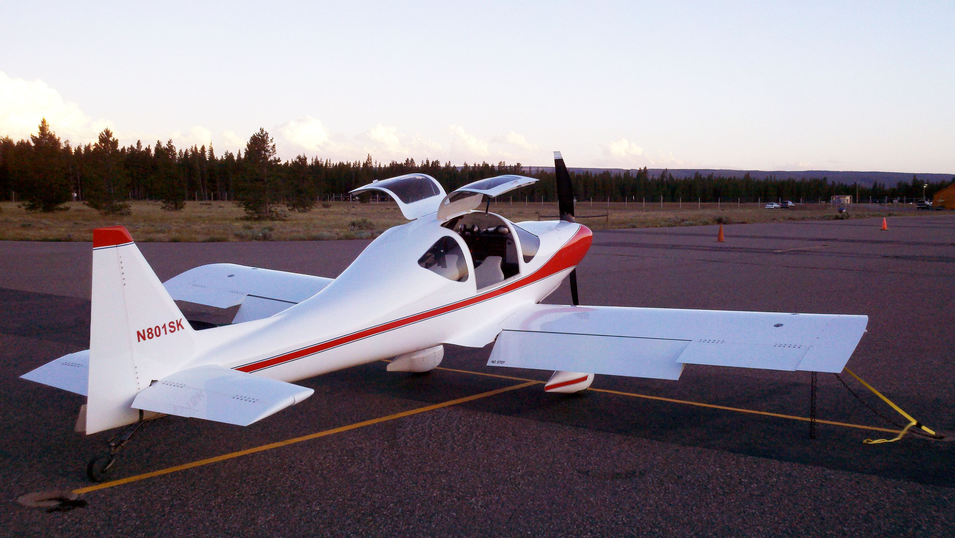

PostPosted: Sat Aug 11, 2012 10:31 pm    Post subject: Sanding, sanding, some more sanding and so on. Reply with quote
I primed and painted my airplane outside. My airport is also 100% no spraying in hangars, but they did not care about outside. I used the UV smooth prime with a roller initally, expensive waste of time. I sprayed auto body high build primer and painted with PPG Delfleet with a $15 harbor freight gun. The finish had a lot of orange peel, but remarkably little dust/dirt. I wetsanded and buffed the paint and it looks great. I would prime/paint outside again for sure. I would not try to paint the whole plane at once, but spilt it up into wing, fuselage, and everything else on different days.
