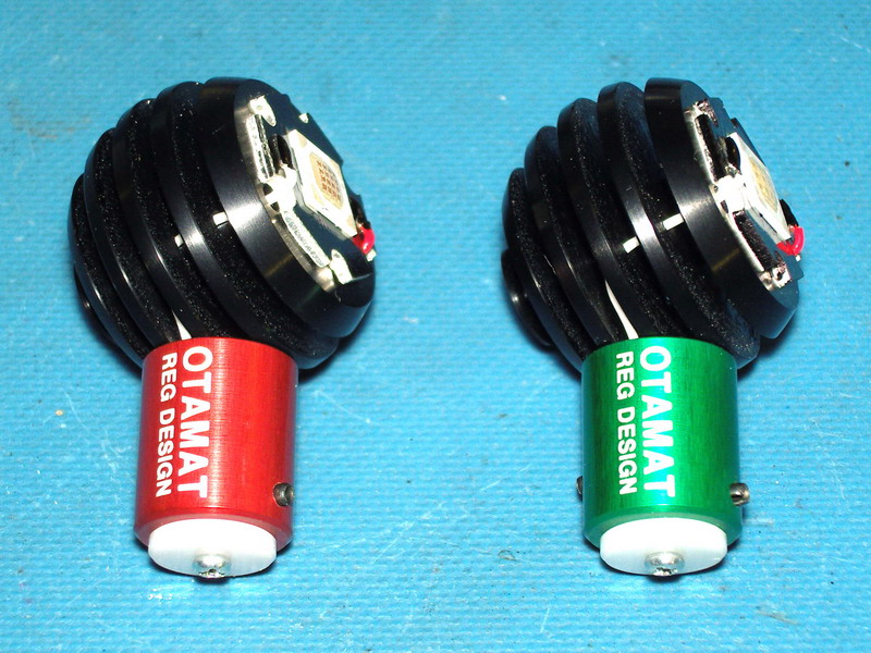

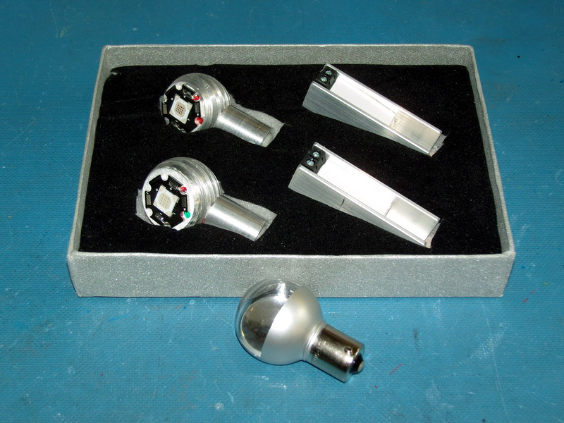

The bulb outside box is one being replaced. The bayonet pins are offset. There is ballast in each supply line. You can use existing wiring, only cut the positive going to the socket and wire in the ballast.
Technical Specifications:
Model OTA204
Bulb physical size as ML7512-12, Whelen, Grymes and usual fittings compatible
LED each individual power 5W
Life 50,000 hours
Weight 100g complete kit
DC power 12-15V 0.9A
v\:* {behavior:url(#default#VML);} o\:* {behavior:url(#default#VML);} b\:* {behavior:url(#default#VML);} .shape {behavior:url(#default#VML);} <![endif]--> 281 1 7560000 10692000 359410 259 261 257 276 262 279 1 0`````````````````````` 5 1 1 285 282 1 False 0 0 0 0 -1 304800 243 True 128 77 255 3175 3175 70 True True True True True 278 134217728 1 1 -9999996.000000 -9999996.000000 8 Empty 16711680 52479 26367 13421772 16737792 13382502 16777215 Bluebird <![if pub11]> <![endif]> <![endif]--> 22852860 22856760 (`(at)````````` 266 263 5 110178060 110181960 <![endif]--> <![endif]--> They cost £180.00 plus P&P
otto
Pulsar III
Rotax 914
[img]cid:part1.07050705.06090206(at)otamat.com[/img]
[img]cid:part2.07090306.06080403(at)otamat.com[/img]
This is what they look like now.

Thanks Otto for your reply! I am looking for drop in type of replacement bulb without any modification. Yours look defenately good option when building new or when modifying the plane. I just finished repainting wings so I dont want to make any cutting.
-Esa
