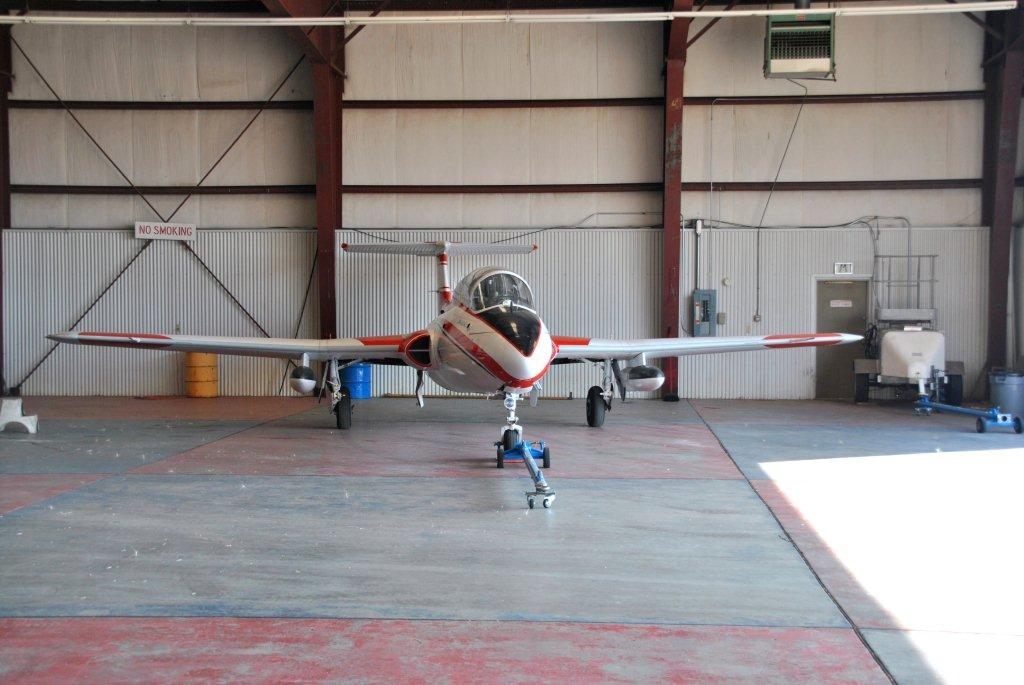

I recently a chance to fly a L-29 with modified wing tips. They are a little more than twice the width of the stock tips. It took about a day to install both tips. While flying I saw a plus 200 to 400 foot in the climb rate (increase) and 2 knot decrease in the dirty stall configuration and the 29 was very stable and smooth though out all flight phases, but the aileron roll was slower. The 29 also seems to want to stay in landing ground effect longer while in the roll-out, landing with speed brakes becomes more a requirement than an option.
What do you think of this kind of mod?

Where can I see the wing tips?

L-29 wing tips mod was done by Eric Ahlstrom....

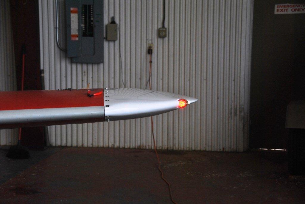

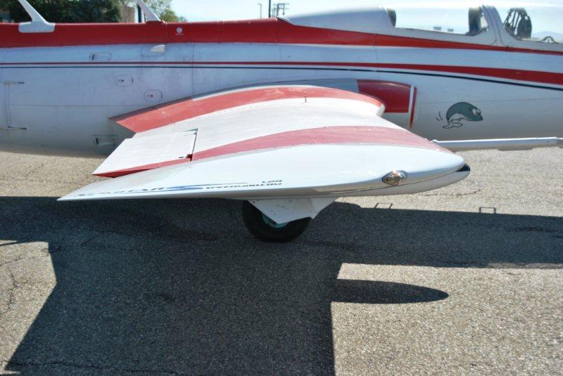

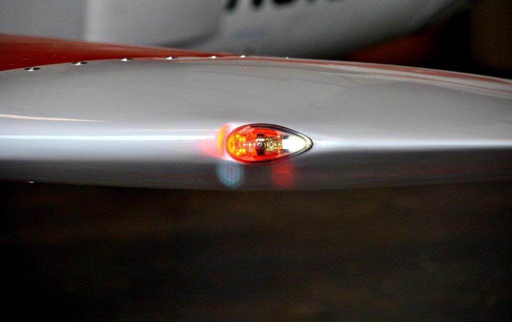

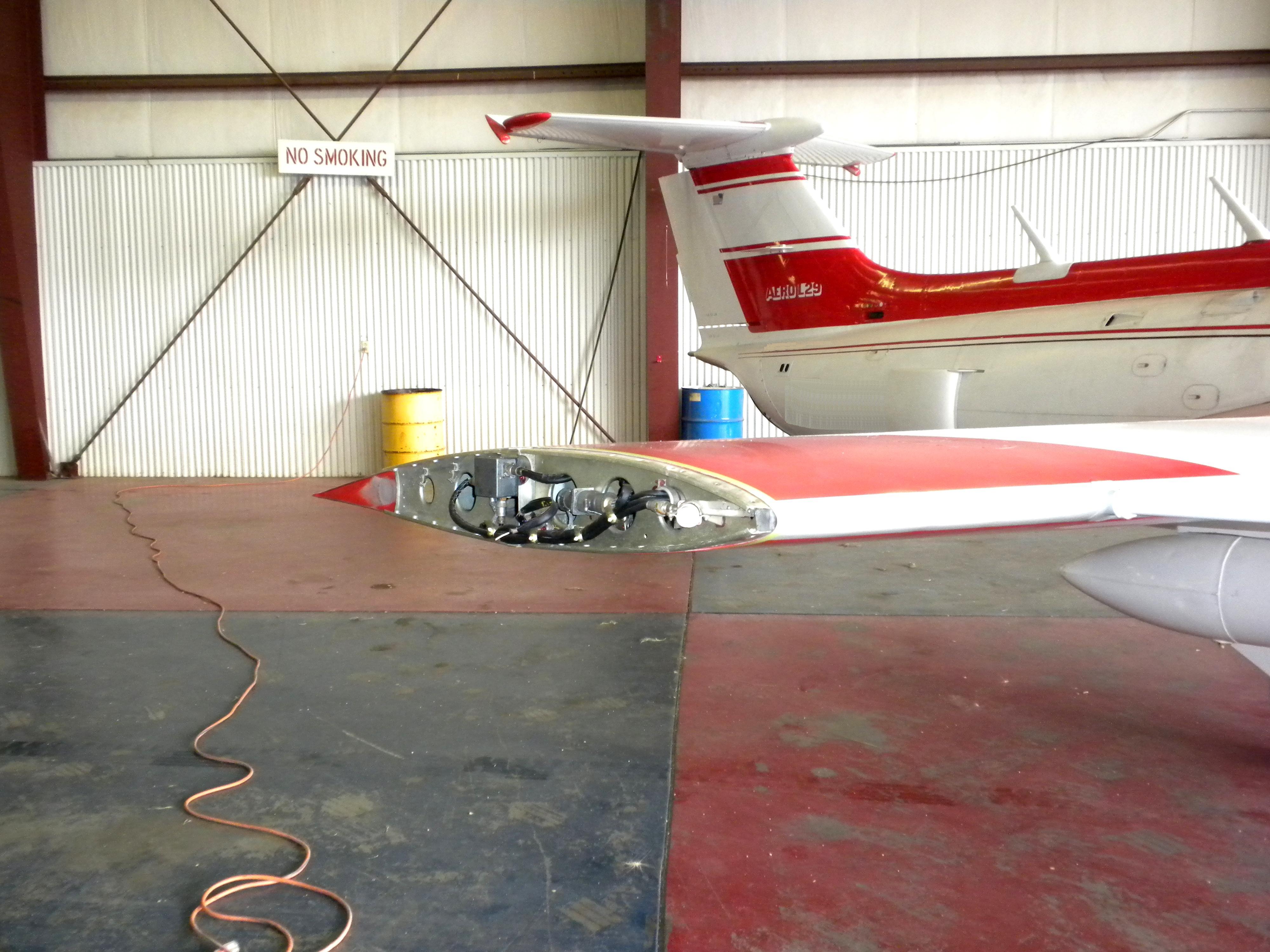

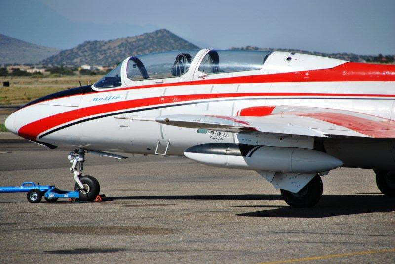

Here are 6-pix of the new 29 tips... I hope you enjoyed them...
I thought the tips worked great...

Interesting wing tips pix's....
old were sort of fat and blunt as the photo shows, the new tips were wide, almost 3 times the width, and tappered to reduce drag and a smaller vortex signature.
Let me know what you all think about these tips...
