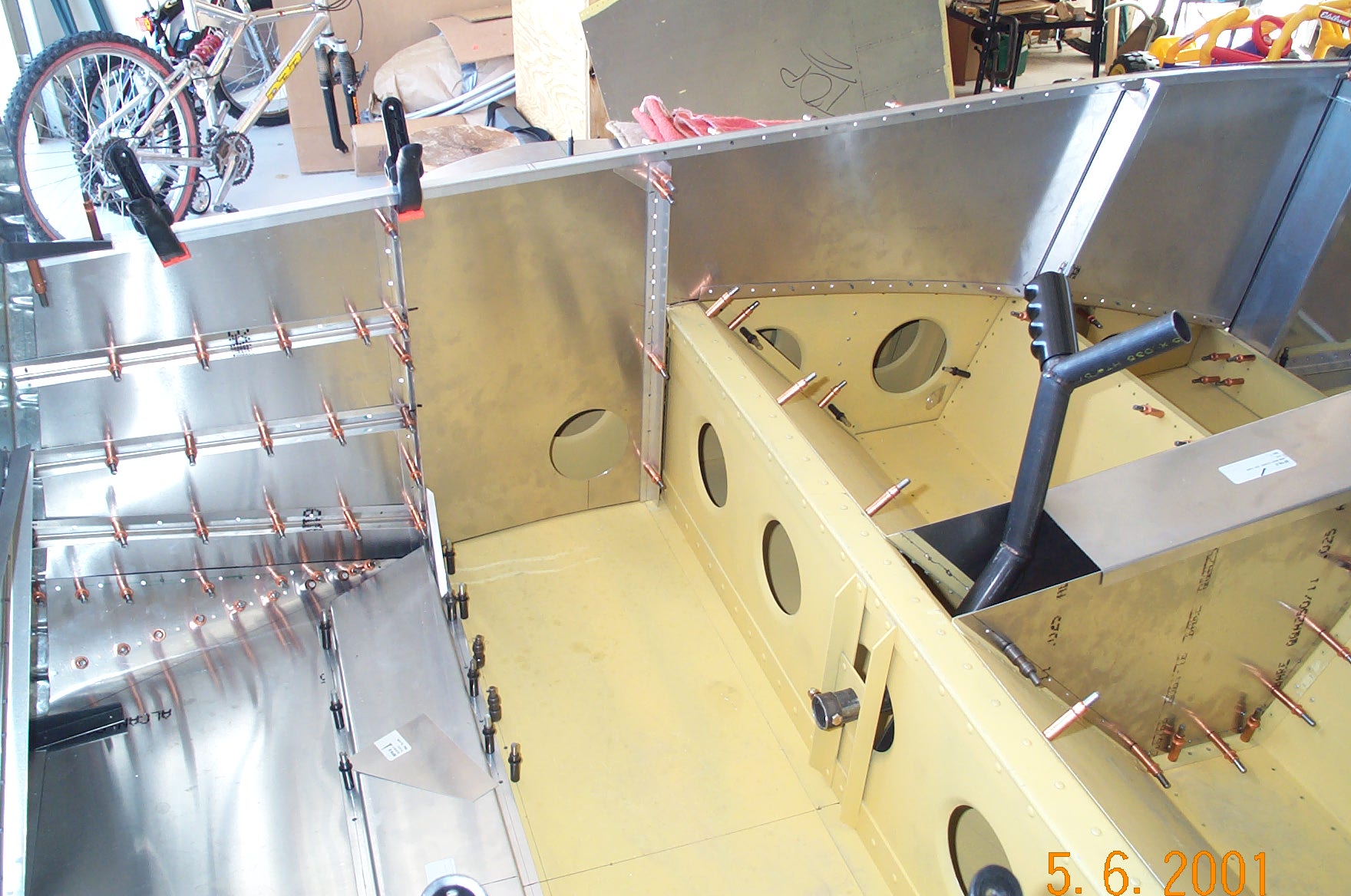

Carlos:
Did you use a 10mm radius on the bottom wing skin?
Russell

yup, checked again last night: cut a piece of paper and put it on top - exactly 10 cm radius.

Carlos,
I've enclosed 2 photos (one for the right side and one for the left side) of my HDS in the area you are having problems with. I don't remember having the same problem you are having. I did have to make the center wing nose skin 3 times for other problems. I kept leaving too much gap between it and the front fuselage skins.
Not sure this helps but it lets you look at some more photos.
Jerry

Jerry, nice photos - and photos of this area are relatively rare, thanks!

I was raised and educated in metric, and can talk imperial (with a bit of an accent).And can make mistakes in any of these systems.
Like this one.
You ask if I used 10 mm, I reply, yessir, 10 cm.
Reducing the radius will remove a bunch of material and eliminate the problem.
On 10 July 2012 10:44, Jerry <jlatimer1(at)cox.net (jlatimer1(at)cox.net)> wrote:
Carlos,
