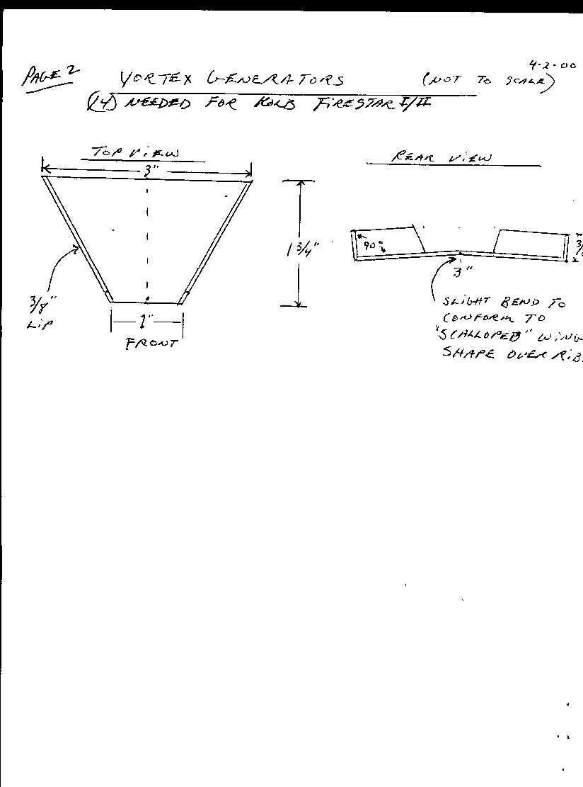

> I purchased my Firestar in 1997. It weighed 278 lbs. I weighed 230, It
> stalled at 46 MPH. I did a few changes that involved more weight (360) and
> the stall went up a bit but not more than 2 MPH. Then I installed VG's to
> each full rib and the stall dropped to 36 MPH. This last year I put them
> on the false ribs as well and the stall dropped to 26 MPH. I also need to
> tell you that my runway is at 4630 ft above sea level. I believe that
> Possums bought his from Landshorter.com, and paid about $100.00. I made
> mine from plans developed by Howard Shackleford. I have some made from
> alum, and some made from lexan. I believe that I like those the best. I do
> believe that it will cost you about 2 mph on your cruise, but that is a
> choice that I am happy to live with. I know how you feel about the stall
> speed since that was one of the factors that decided me on a Kolb, since
> most of the places that I would be landing would be other than on a
> runway. I too wondered why mine stalled so fast. So I believe that the
> speed you are experiencing is a bit more realistic.

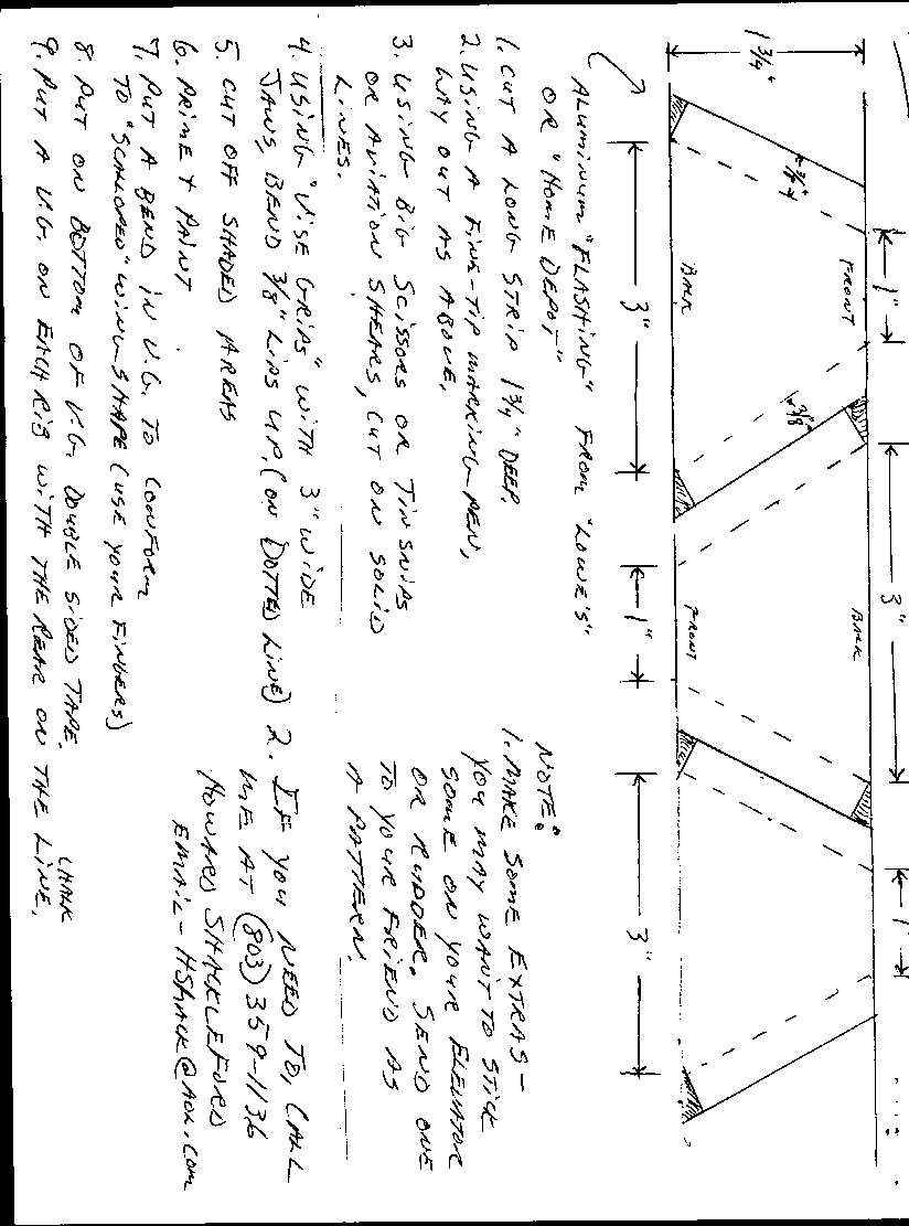

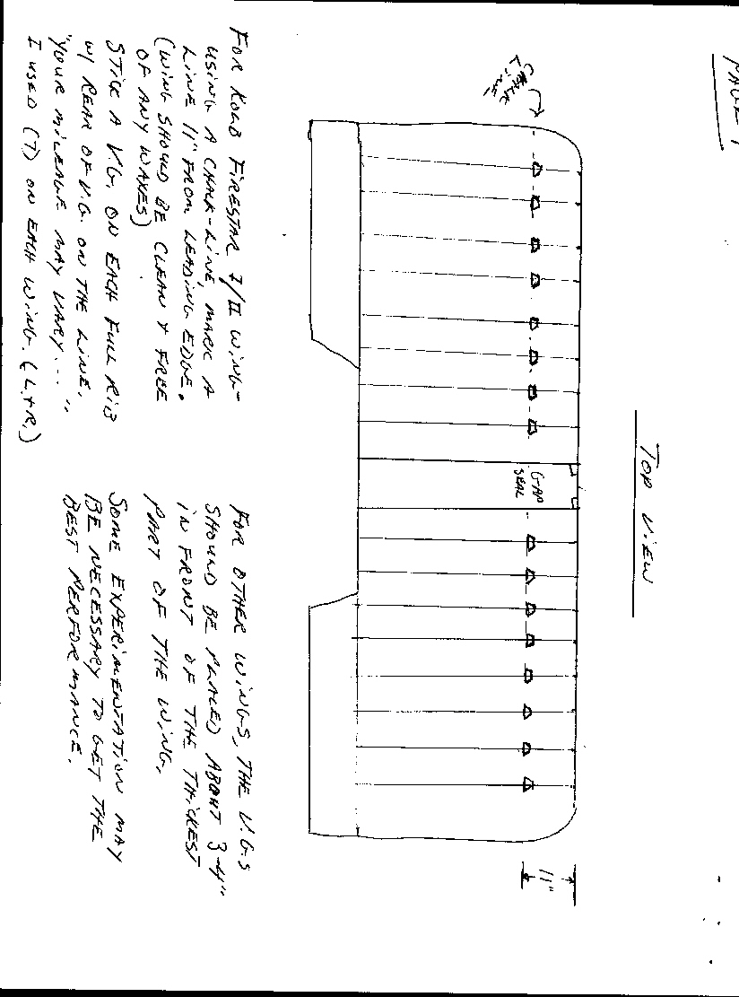

Thanks Larry, What is the placement and spacing as well as the number per
wing that you installed? And how did you determine the number and distance?
Would you be interested in making additional ones? And NO I am not a lawyer,
nor would I sue anyone if the didn't work! Also Larry, How did you get them
to adhere?

PostPosted: Fri Jan 13, 2006 9:34 pm    Post subject: Re: 40 MPH Stall Reply with quote
I attatched the first set at 11 inches back from the leading edge. These were on the full ribs. I then attatched the second set on the false ribs and I set those with the back of the VG's even with the front of the previous set. I have included the information that I received to make mine. I attatched them with double sided servo tape from a hobby store. It does well. If for some reason they don't come through let me know and I will send them to your email. If you use lexan (1/16 ) You can bend the lexan just as easy as alum, but being clear it is not necessary to paint them. The color shows right through making them almost invisible.
