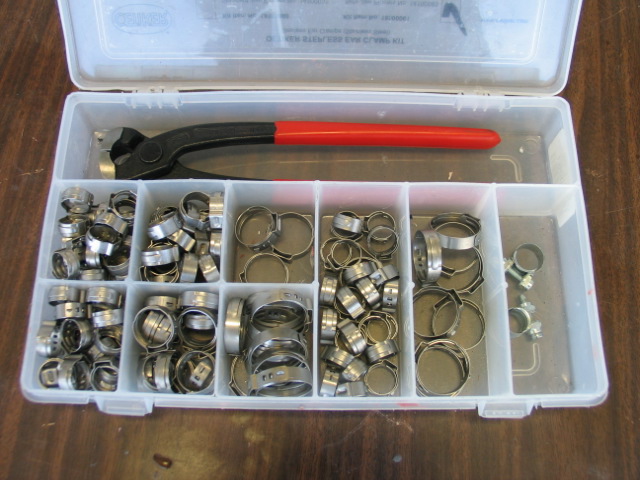

Bobby, I'm no expert on Jabiru engines but I have had good luck with Oteker Ear Clamps. They are a single use clamp so you have to have several on hand but they seem to hold much better than worm gear style clamps. A side benifit is the "ears" don't stick out as far as compaired to the screw on a worm gear style clamp. If your interested in seeing more about ear clamps, the EAA has a video about them in their homebuilder hints section.

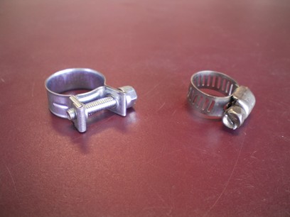

You should be using a good band clamp on the fuel lines like the Oetiker band clamps. These are usually the one eared pinch type clamp and easy to use. The serrated worm drive clamps you can get from the hardware store really aren't acceptable. At the very least they should be fuel injection clamps which are a screw style clamp, but can't slip as the have a nut and screw and apply good 360 circumferential pressure around the fitting. These can be puirchased from any auto supply house.

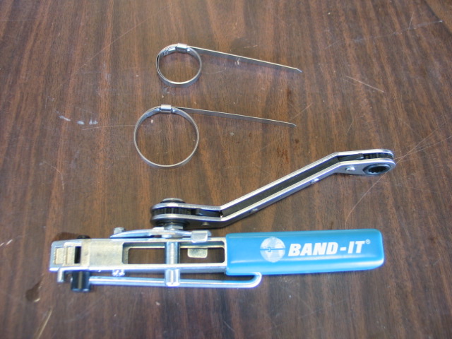

All fuel lines should be in fire sleeve and a band clamp like a Band-It clamp used on them. The ends of the fire sleeve can either be dipped in "End Dip" or can be wrapped with fire sleeve self vulcanizing tape that has a fire rating like the fire sleeve it self.
