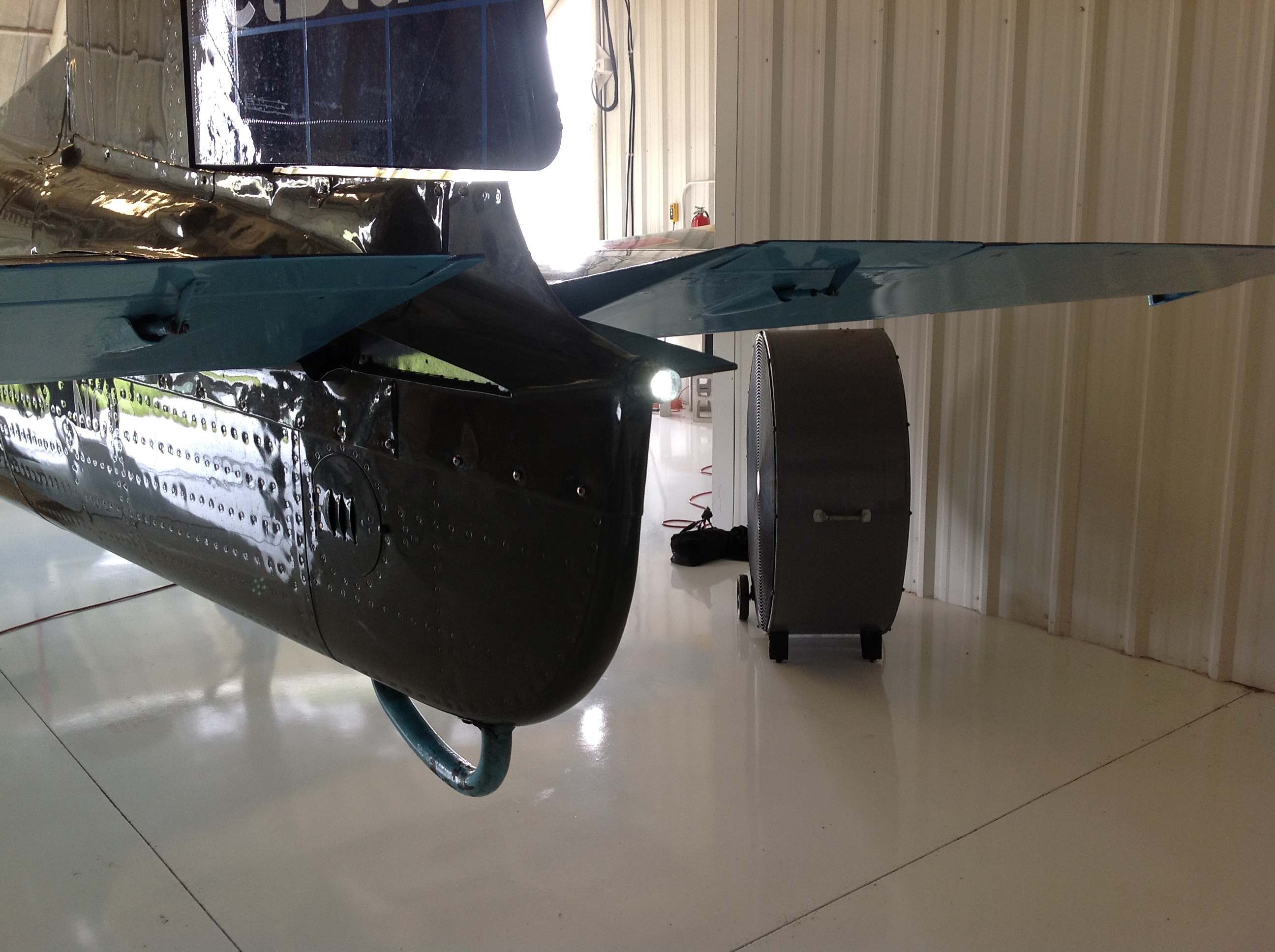

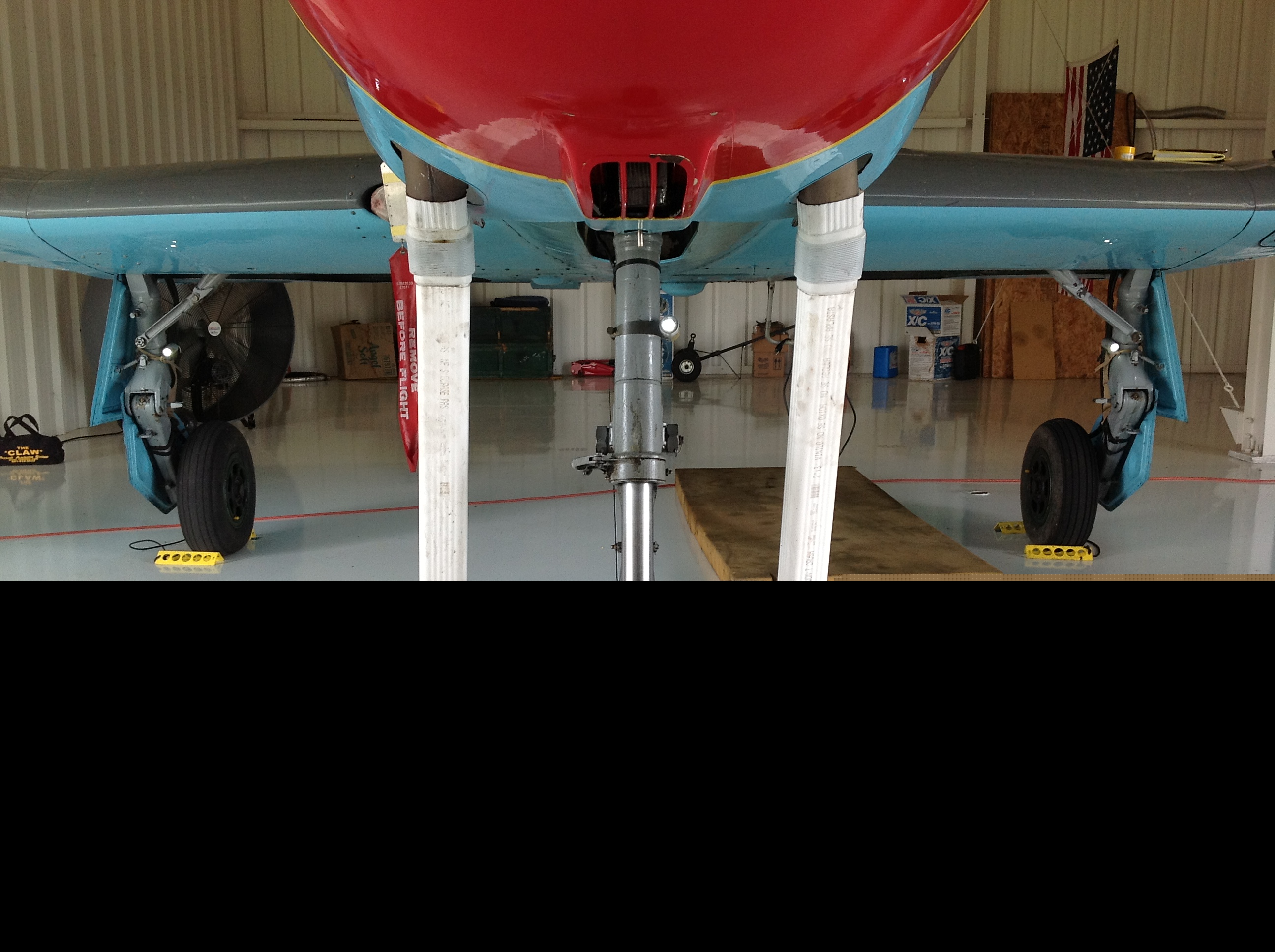

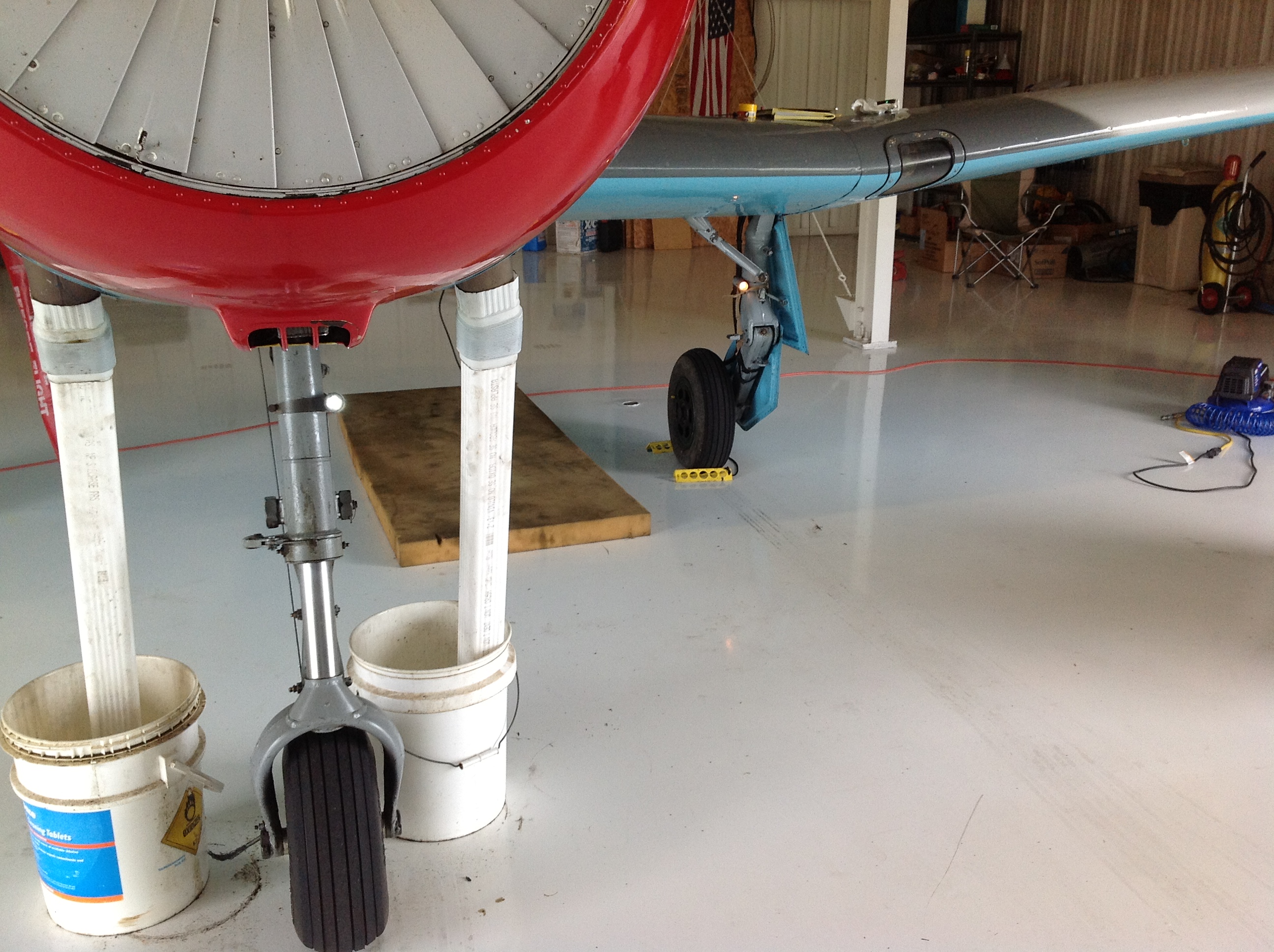

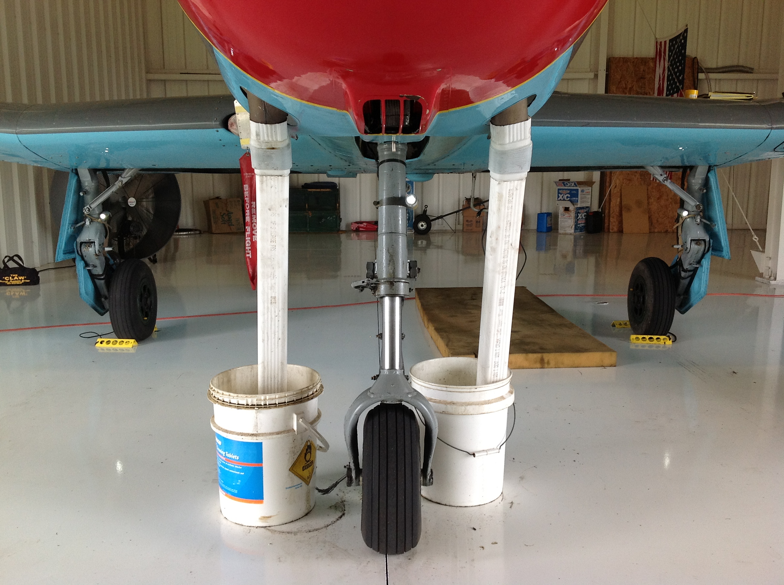

I am able to acquire LED replacements for the GE304s used in the CJ-6 (and presumably Yak) gear and tail lights. Here are some photos. I'll be happy to order a pile of these if there is sufficient interest.
As a heads up, the two contacts on the bottom require some trimming due to the springs on the poles in the sockets.
All three gear with LED

Tail Nav light LED

Nose with LED and Main with GE304.

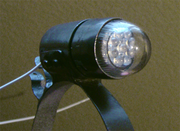

There are also replacements for the small exterior Chinese bulb. It's 24 volt, LED cluster that has the same bayonet base. This would be a direct, drop-in replacement for the lights on the nose gear, mains and tail cone. This particular LED arrangement has viewing angle of 90 degrees, so it is brightest when seen from straight ahead. Here is where I found this:
www.superbrightleds.com/cgi-bin/store/index.cgi?action=DispPage&Page2Disp=%2Fother_bulbs.htm
The web site navigation is a little confusing, but basically what you would be looking for is the 24 volt, white, dual contact, single intensity, 15 mm 1142 bayonet base. The ordering designation is: 1142-W15-24V White LED bulb - 24V. I've attached a picture of what this looks like installed.
There are also smaller LEDs from the same web site that you can use to replace the six interior landing gear indicator lights and the cockpit interior lights.
