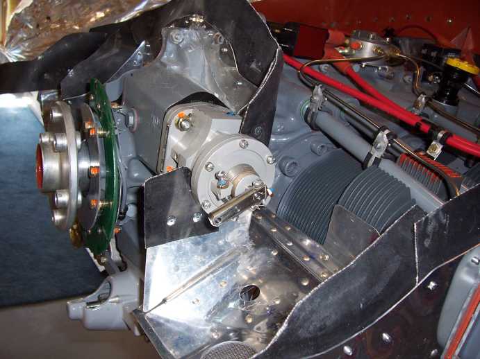

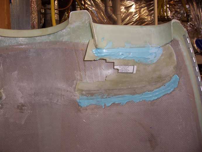

Attached are a couple of photos from my RV-10. One shows the governor,
the other shows the cutout for the governor in the upper cowl ramp. I
have gaps all around the prop governor between the governor and the ramp
cutout. This will permit air to flow from the high pressure side of the
cowling to the low pressure side through the gaps.
Have others encountered similar geometry? What, if anything, have you
done to reduce the leakage?
Tim Lewis

Yep, there needs to be clearance for that arm to travel with the cowl
on. I suppose it would be possible for someone to go into depth and
put rubber seal around the ramp area, but I didn't and doubt that it
has a lot of consequence. I suppose you could also mold in a cutout
with clearance around the governor and have it seal on the backside.
I can't say this wouldn't be great. I just doubt it's necessary.
Basically, as long as that arm doesn't hang up, I think you've got
it where it needs to be.

I bridged the governer with the rubber gasket and use screws to attach
it to the alum. baffle so it could be removeable. It is not perfect
but a little better than having it all open.
