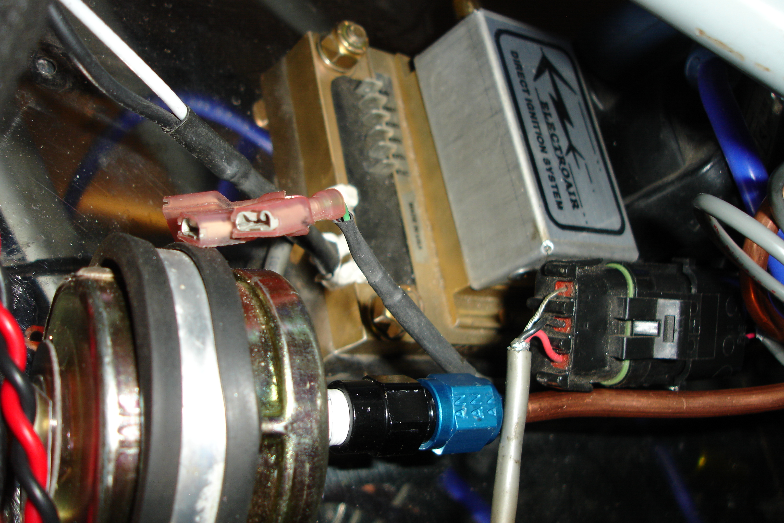

PostPosted: Mon Apr 23, 2012 4:48 am    Post subject: RV-List Digest: 2 Msgs - 04/21/12 Reply with quote
John,
 I checked the reading both from the transducer casing to the engine (at) the Pressure line output, as well as from the casing  to the firewall ground. Both readings were the same. I'm considering a direct reading using a mechanical gauge to verify actual pressure from the engine. That should determine the root cause and prescribe the remedy.  My concern is that if these readings are accurate, I'm down indefinitely. I'll run a hard line as you suggested and see the results. Would be nice if that resolved the issue... Here's a shot of the transducer installation. It previously worked in this configuration just fine, then last week was when it displayed the low reading.
