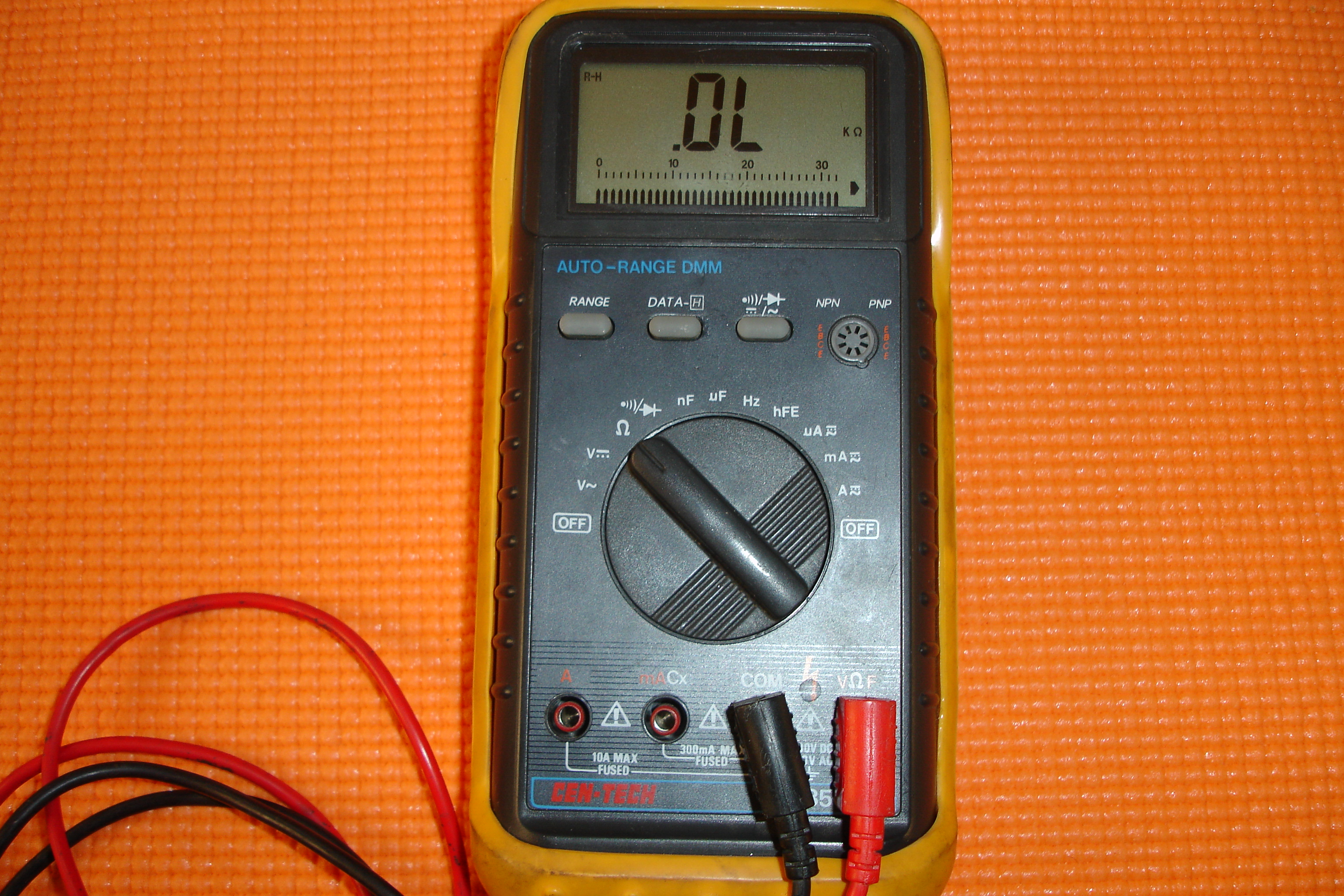

PostPosted: Fri Apr 13, 2012 10:26 am    Post subject: Oil Presure Gauge Reply with quote
I'll be removing the cowl this weekend to trace each of those.  I'm considering a 10A or an XTreme to replace the analog.
R.C.

Doug Gray
Posts: 112
Location: Sydney, Australia
PostPosted: Sat Apr 21, 2012 4:20 am    Post subject: Oil Presure Gauge Reply with quote
R.C.,
Yes a shop could sort this out for you, just apply cash.
The multimeter looks to be just the ticket. I see it is already set on the ohms scale, so here is a plan....
1. Disconnect the transducer, check the resistance between the terminal and the transducer body - this should be close to the 240 ohms. If not then you do not have the correct transducer. I notice you purchased the transducer from ACS, but the gauge is from Vans. With this type of gauge the  transducer has to have the resistance profile with pressure to match the gauge. I believe Vans sells the correct transducer, I am uncertain if this matches anything from ACS.
2. Now reconnect the transducer and disconnect the Sense terminal and the ground from the gauge. The sense wire should go directly to the transducer terminal, and the ground should connect to the case of the transducer (probably via the airframe ground) c- measure the resistance between the two free ends - this should measure the same as for the transducer alone - about 240 ohms. If not then there is a wiring issue between the transducer and the sense terminal or to ground. Fix this if it not correct.
If necessary run a new wire between the gauge and the transducer terminal, and run a new ground wire between the case of the transducer to the gauge ground. Retest for the 240 ohms.
3. Check the airframe ground connection (this is the negative of the battery, or the engine case) to the transducer case. The should be less than 0.1 ohm. If not find out why and fix.
4. Finally check the gauge itself - get hold of a 100ohm resistor - wire it between the gauge sense terminal and the gauge ground. Gauge supply terminal should already be wired to the supply - this should be 12-14 volts relative to the ground. Gauge ground wired to ground. With the 100ohm resistor in place and power applied the gauge should indicate close to 50psi. If it does your gauge should be ok.
Much easier to do than to describe.
Doug
