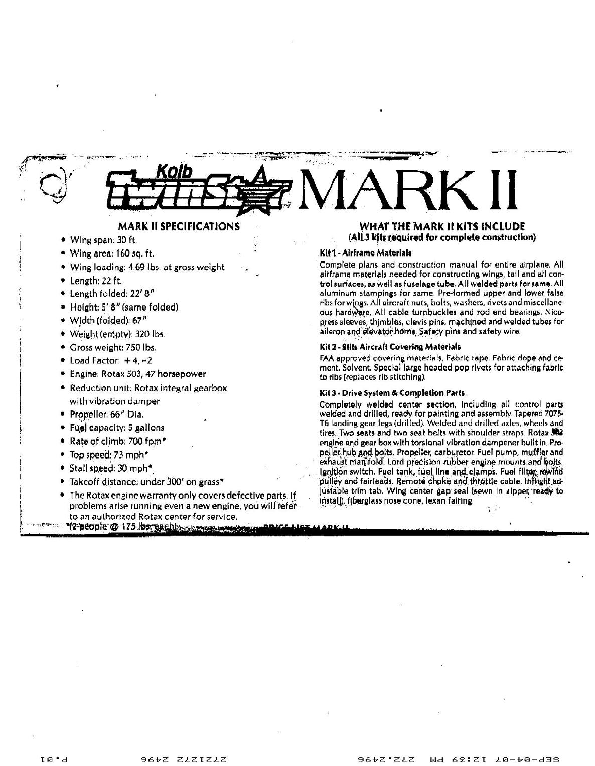

I also had a scan (don't remember where I got it) from the Mark II kit. I will attempt to attach it here. I don't know if it was for a kit that was enclosed or open though. My stats were closer to what Mike provided.
I got several answers when asking about the level flight attitude to do the weight and balance. You can weed through them. I never did measure the exact angle, but took an educated guess.
http://forums.matronics.com/viewtopic.php?p=142161&highlight=#142161
 Filesize:  245.1 KB
 Viewed:  12071 Time(s)

Actually I remembered last night that the scan I provided did come from the only specs documentation Travis or Dennis from The New Kolb Aircraft Co. had on the Mark II Twinstar.
The New Kolb Aircraft Co. never did sell the Mark II kit (it was before their time), but they will help as much as possible since they do have information about it. They have always been very helpful with me when I had a question or needed a part.
