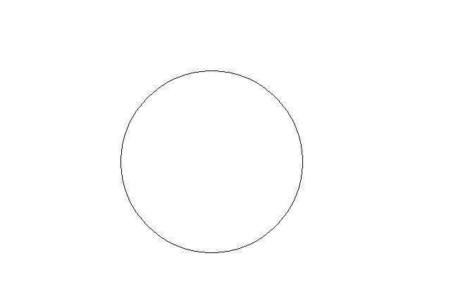

Actually I was referring to the limitations of delivering engineering
drawings as jpegs. Attached is a jpeg of a circle. The jpeg is 640 by 400
pixels. What size should the circle be when it is printed? Unless some
assumption is made about pixels per inch it is impossible to say.
For the jpegs that come out of my cameras (as opposed to being drawn like
the rib templates were) the EXIF information in the files say:
X resolution: 72
Y resolution: 72
Resolution: inch
Is that resolution information useful? No - but it is in the jpeg.
-- Craig

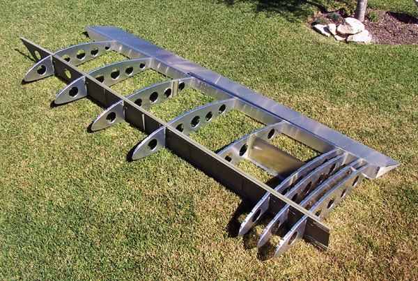

Yes, I agree completely with Craig that jpegs are not the most ideal format for engineering drawings. I initially plotted my rib templates in AutoCad 2005. Unfortunately, there were no printing shops in my home town that could print from the .dwg files. They could, however, print from jpegs. Honestly, they came out fine. Attached is a photo of my right wing skeleton with ribs made with jpeg templates. Looks OK to me and my EAA Tech counselor. Well, we've thoroughly beat this horse to death. I think I'll go out to the garage and actually do some work on my airplane.
