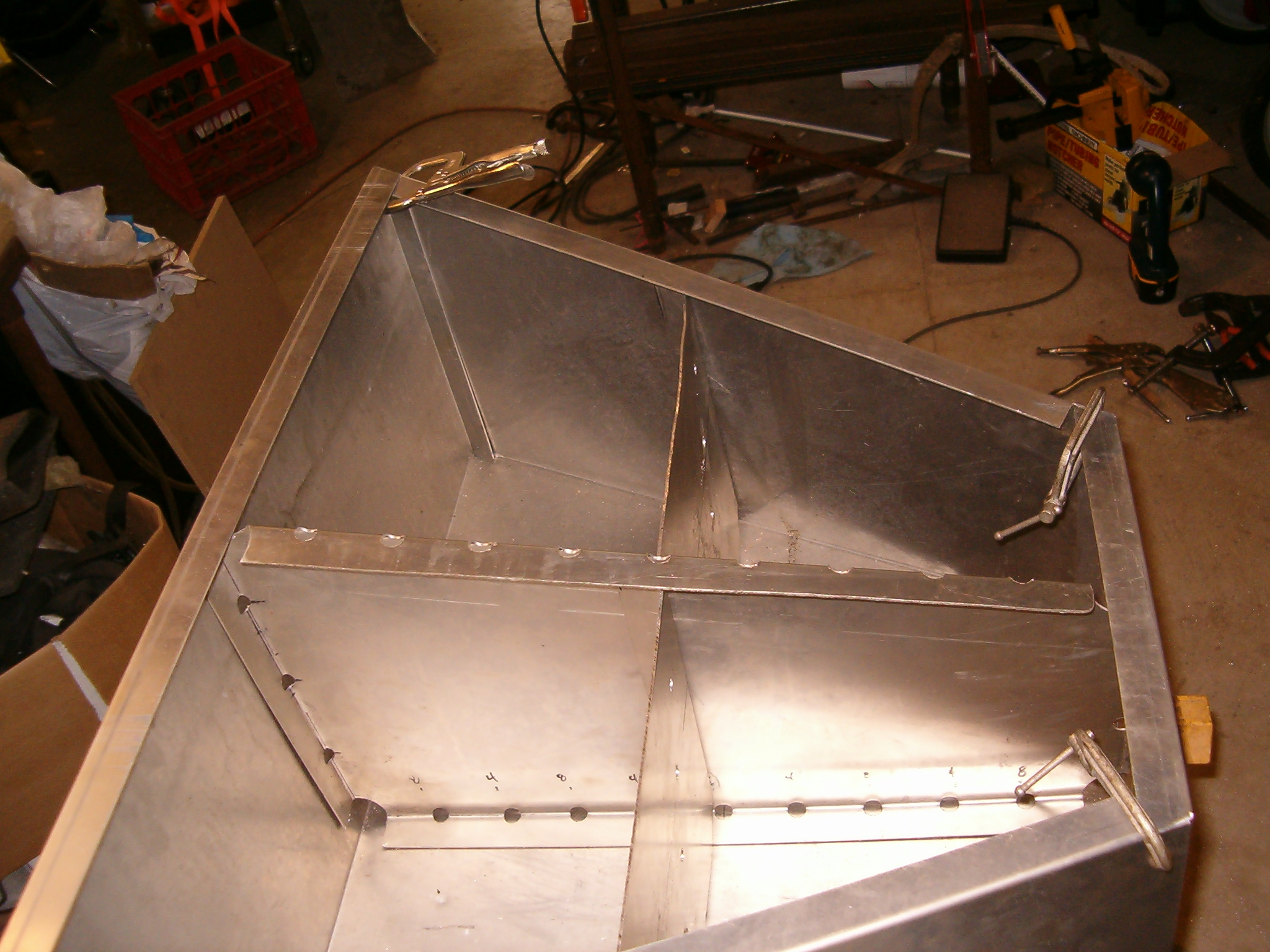

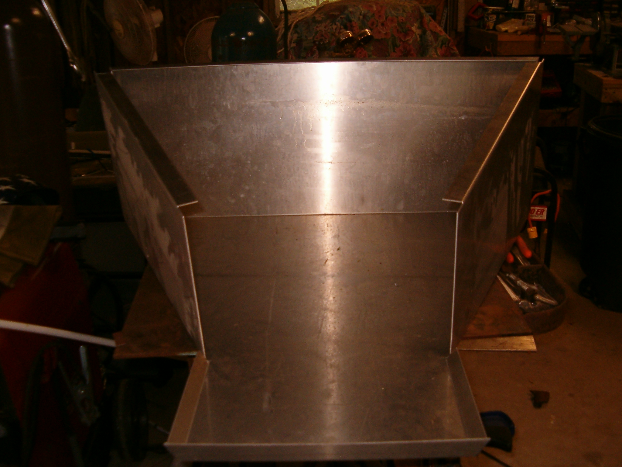

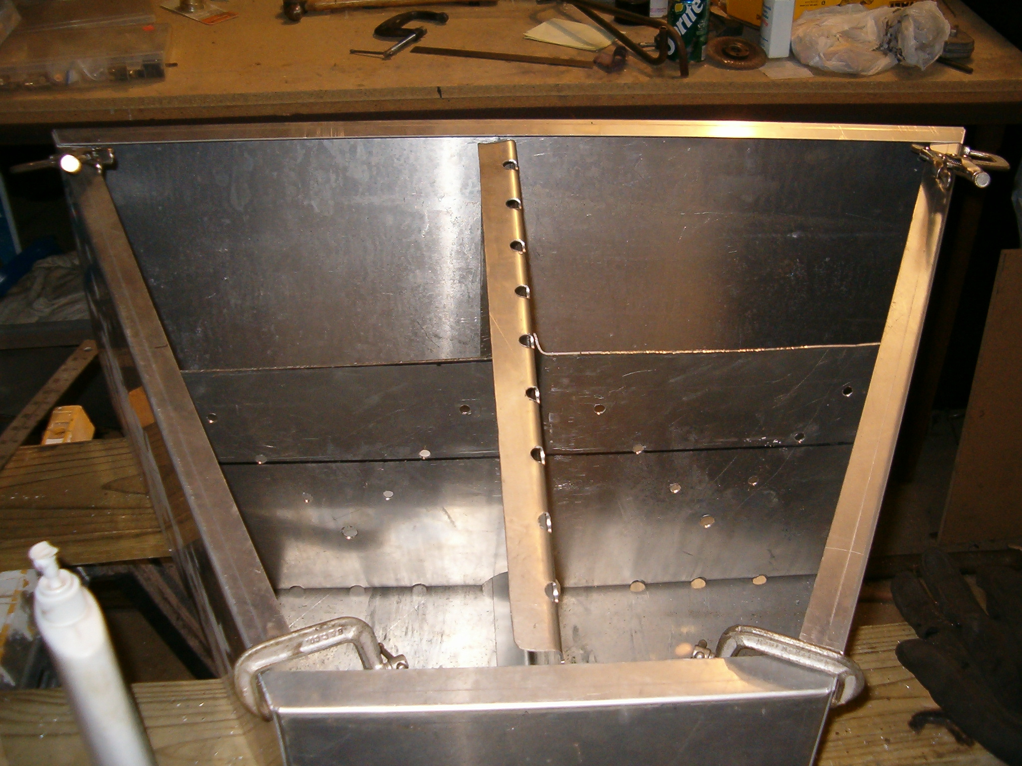

Hello list,
Instead of driving to MV as I hoped, I stayed closer to home. Visited my daughter at Eglin AFB and worked my fuel tank.
Special thanks to John & Brother Jim Hauck. This is pretty much their proven design and my attempt to benefit from their experience. Steven Green also had some great suggestions and was helpful.
The tank is made from 5052 - h32 .063" (1/16")Aluminum. Couldn't get any .050 around here without paying some really high freight charges. More than the cost of the sheet. Anyway, my chances of successful welds increase with the slightly thicker material.
I had a close friend that deals daily with an excellent fab shop brake the metal for me. He won't tell me how much it cost to cut and brake. He wanted to do this for me for the few favors and projects I helped him on. Kindness returned is a good feeling.
If you notice, there are only vertical seams and seams on the top. I haven't decided on the extent I will rivet. Each vertical seam can be welded on the inside and outside. May only use rivets to the attach the top to the long baffle down the center and then weld over them.
Thought some may find pictures useful - always a lot of discussion on tanks. There are easier ways to do this. I struggled to make the baffles fit with a hand made brake. After I bent the last one, the light went off! If the baffles were made in three pieces - 1) baffle wall, 2) bottom angle, 3) top angle - the pieces could be clamped in place and then riveted together to get the perfect fit. ARGHHH!
Next, run some practice beads to get my rythym going good. Then clean and weld. Install filler neck, high vent and low outlet fittings.
Hope to be running with the big dogs soon. Just a lot of little steps to go.
Please be safe. Make good decisions early. Keep the dominoes far apart. Voice of experience. It can cost so much when they start to fall.
Rear view
 Filesize:  1008.33 KB
 Viewed:  431 Time(s)
Baffles in place.
 Filesize:  946.41 KB
 Viewed:  394 Time(s)
This is how came from fab shop. Had to make last bend by hand.
 Filesize:  902.51 KB
 Viewed:  418 Time(s)

PostPosted: Thu May 25, 2006 3:36 pm    Post subject: How I spent my MV vacation - worked on fuel tank Reply with quote
In a message dated 5/24/2006 4:04:47 P.M. Central Standard Time,
gearbender(at)bellsouth.net writes:
John,
If you drill some 3/8" -- 1/2 ' holes in the top skin you can plug weld
them to the center baffle. This would be stronger than trying to rivet the top
to the baffle. Also if you dont get the steel mandrel out of the pop rivet
you will introduce steel into your aluminum weld ,when you try to weld over it
,which is not a good thing. The industry standard for fitting up an aluminum
gas tank is a corner to corner weld, which, when welded with the proper
heat,using the tig method will leave a uniform penetration which will look like
it has a bead on the inside. Good luck.
Ed Diebel

PostPosted: Thu May 25, 2006 4:20 pm    Post subject: Re: How I spent my MV vacation - worked on fuel tank Reply with quote
Hey Ed,
I was going to use aluminum rivets with aluminum mandrels (5052) and weld over these. I could see your suggestion working also. Do you think the hole has to be 3/8" - 1/2". Seems like a 1/4" would work. I know several people have had success with weld over aluminum rivets method. I can see that if the rivet fails or pulls through the two pieces would seperate. The head of the rivet is only fused to the top plate.
More to ponder.

PostPosted: Thu May 25, 2006 6:57 pm    Post subject: How I spent my MV vacation - worked on fuel tank Reply with quote
In a message dated 5/25/2006 7:22:26 P.M. Central Standard Time,
Hey Ed,
More to ponder.
John,
You might be able to get by with a 1/4 " hole, but I think it is easier
if you have the hole big enough that you can get your tungsten in close enough
to the baffle ,that you can concentrate the heat on it so it burns into it
before the upper skin starts to melt, and you fill op the hole before you burn
into the baffle. I suggest a mock up trial run . Be sure you have a
method to clamp the upper skin down in the vicinity of the hole you are welding.
Chances are the upper skin will want to pull away from the baffle. If you do
not burn into the baffle when you fill the hole, the tank will not leak, but
the baffle will not be secure.
