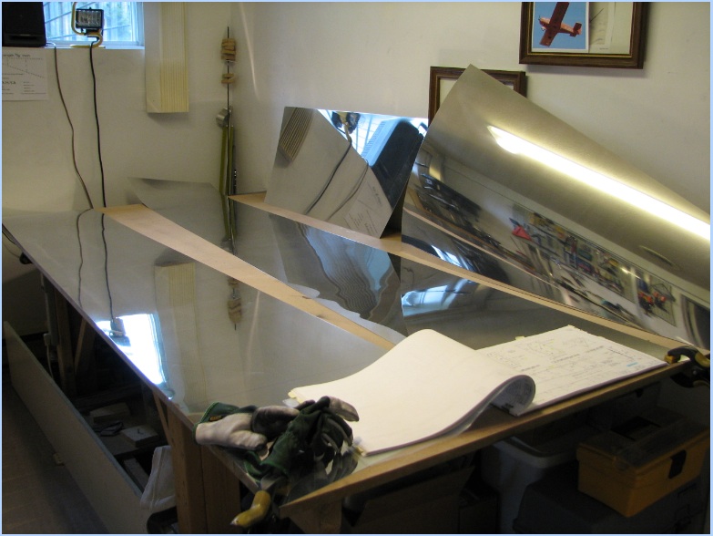

Hello, all
I thought I'd post some information on polishing.
I have been polishing flat sheets before actually drilling holes and, in some instances, even before cutting the parts.
Up to a couple of months ago, I was using "Mother's", a mag polishing paste.
I was applying it with paper towels driven by an electric drill.
That worked pretty well, but I thought a "real" polishing process should makes things go a little (hopefully a lot) quicker.
So, I invested on a polisher, similar to these (typical Chinese product):
http://www.drillspot.com/products/349756/Westward_1VUC2_Automotive_Polisher_Buffer
http://www.seaskytools.net/car-polisher/379219.html
I also got Nuvite F9 and C, one pound of each, and four wool bonnets.
All of this cost me close to CA$500.
I have thus far polished two sheets 4'x8', and am finishing the F9 phase on a 4'x4' piece.
The F9 jar was gone half way through the 4'x4', so it was good for approximately 72 sqft.
I believe I will be able to finish the 4'x4' and still have some C compound left (not to mention that I dropped the jar on the floor and wasted one or two spoonfuls of the stuff).
Clearly, I use less C than I use F9.
In terms of time required, I believe Nuvite and Mother's are on the same ball park. I did not keep proper records, but I'd say they both take one to two hours per sqft.
Nuvite, however, makes an incredible mess, particularly the F9 phase: it creates a very fine dust that covers the whole room you are working in. And black dust bunnies are all over the place when you are using a fairly new bonnet. The mess produced by Mother's is much more "believable": the paper towels only disintegrate if they catch a corner of the sheet or any other obstacle left in its way, and the dust produced is negligible.
The Nuvite dust requires me to wear a dust mask, or it will irritate my throat. And even with the mask, after 1.5 h, I stop because they bother me (the mask AND the dust). Also, Nuvite contains petroleum distillates, so the fumes can bother some people (my wife, for instance).
Both approaches are awfully boring.
Bottom line, if I knew then what I know now, I would have used only Mother's: it is clean, and a couple of jars will be enough for a 4'x8' sheet - less than CA$20 taxes included (15%) at the local hardware store, no shipping charges. Did I mention it is clean?
Attached a picture of some tail parts, polished with Mother's

'Just wondering if you tried the Chinese polishers with the Mothers. If so, how did it work out? I notice Harbor Freight offers a similar polisher for $50 right now.
Also, Googling "Mother's mag polishing paste" I find "Mothers 5101 Mag & Aluminum Polish Paste" in 5 and 10 oz containers. Is that the product you used? And, if so, are you referring to the 5 or the 10 oz container?
Your parts look great to me.

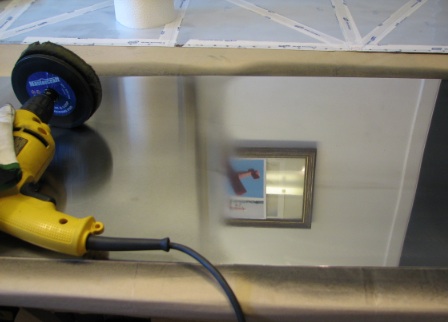

I never used a wool bonnet with Mother's - it might work, I just never tried. I am afraid it will create black dust bunnies - not something I am not very fond of.
I use a 5 " circular pad with velcro hooks on it, then a piece of foam, about 1" thick, and then the best quality paper towel I can find, cut in 5"x5" squares.
I put the paste on the paper, and work on areas of about 1 to 1.5 square feet at a time.
When the aluminum is clean from the paste and black residue, I stop, throw the paper away and get a new one.
And, contrary to the bonnet technique, I lay the paper/foam/disk attachment flat on against the metal, not at an angle.
It is as fast (or slow) as Nuvite.
Attached a picture of work in progress (tail parts).
The product you found seems to be "it", although the jar I have says the product # is 35100.
It could be because (1) it is packaged with French and English labels (for Canada) and / or (2) they changed the product code - I haven't bought one in many months - the last time was probably summer 2010.

How do you attach the paper towel to the foam? Does it leave swirl marks?
In my trials using Nuvite with a high speed polisher, it leaves swirl marks that I later removed with an orbital polisher and a fine grade Nuvite.

The paper stays there just by friction.
Once in a while it will stick to the aluminum and will slip - frequently a sign that I used too much paste.
Usually there are no swirl marks - but I haven't brought any of these parts into the sun light yet...
Once in a while I do get swirl marks, but it is usually due to contamination - aluminum dust left on the bench, for instance.
The work area must be very clean - no different from any other process.
And, of course, I still can finish with the finest grade of Nuvite, if I think it will make a difference - but I will have avoided the F9 (and C) mess.

Pat, I have looked closely at your pictures - the Zodie looks awesome!
I liked the results you achieved, so much so that it was part of my motivation for trying Nuvite.
But I think can achieve the same level of "shinyness" with Mother's - with less mess. Or die trying... Wink
Seriously, if I am not happy with Mother's results, I can apply the step after C (is it "S"?), and still avoid F9 and C.
BTW, grade C is much less messy than F9, and I assume S (?) is pretty clean.

Here's pictures of mine, just using Nuvite F9 for now. Will use the finer grades after phase 1 is done.
http://www.zenith.aero/photo/albums/polish-and-paint
- Pat

I polished my entire 601HD with Nuvite. The wings had been hanging in my attic for 7 years. The "trick" I found, which is especially useful for older aluminum is to lightly coat the metal with mineral spirits( paint thinner) before you start. This will make the nuvite flow like cream and give an excellent result. I polish my plane once a year and still start with a light coat of mineral spirirts.
