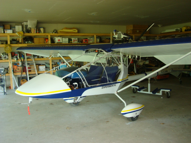

Here's a shot of my plane last June. ALL Lexan has been installed since this photo was taken.

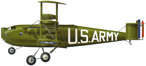

Well, it worked for the Barling Bomber, not.
Mike ...YOUR AIRPLANE IS BEAUTIFUL !

Thanks, Chris!!!
You're very kind. Like our buddy Scott Thompson said,"any plane can be made to look good from a few away". haha
Thanks again, Amigo!
