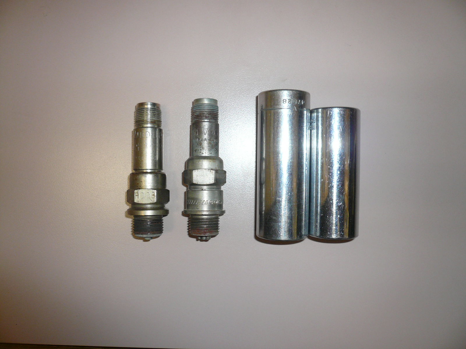

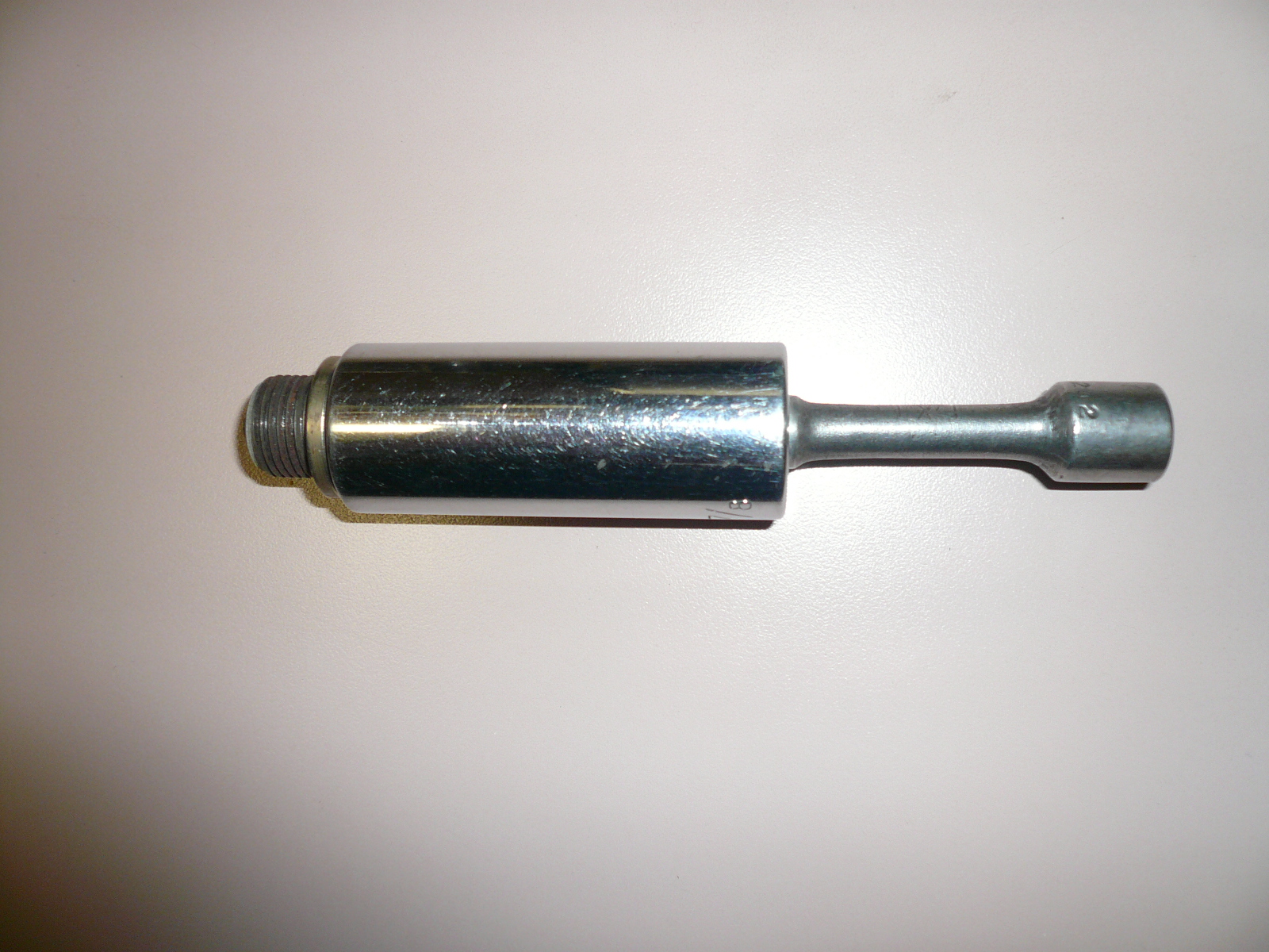

Doug Doty
Joined: 28 Oct 2011
Posts: 33
Location: Madison In
PostPosted: Wed Nov 09, 2011 3:15 pm    Post subject: Re: Which plugs for our planes these days Reply with quote
After cleaning up my REM40E's I found 4 fairly nice condition and 4 older so I actually ordered 4 of the 38BY's and will put them in the bottom for now to see how things go and then change the tops at annual if going well. According to logs all were new 430 hours ago and have been cleaned and regapped 4 times, but some definatly showed more wear than others.
I had some lead showing in 3-4 of the set of 8 but the real culprit was some oil on the bottom plug in #2 when it was stumbling yesterday and did not run up as expected.
Gary, can you confirm from experience which plugs are driven by which magneto on our tigers. I'll be trying to find it else where but feeling completely beat after work tonight. Maybe a little maint. Manual reading will revive me.

PostPosted: Thu Nov 10, 2011 6:25 am    Post subject: Which plugs for our planes these days Reply with quote
On 11/9/2011 6:30 PM, Gary Vogt wrote:
How do you get a torque wrench onto the #3 and #4 top plugs?
I don't have a problem with Unison (now Tempest) plugs. I typically use
a universal joint at the plug socket and then an extension that extends
past the baffle. You can install the socket on the plug and then put
the wrench on the socket.
Gary said:
"I explained to him that to reach the hex nut on the very bottom of the
plug, I needed you use a longer socket. Problem is, the longer socket
is difficult to use on plugs #3 & #4."
Depends on what socket you are using. I don't know about a Champion
plug socket but here is a photo of both plug types side by side and a
Craftsman and a Wright socket. The plugs are the same length but the
hex is closer to the thread end on the Tempest plug. But the short
Wright socket will engage either plug to the same level as shown in the
other photo. It actually goes on the Tempest plug about 1/16" further.
If you had an even shorter socket it would work better with the Champion
plug or you could chuck the Wright socket in a lath and shorten it about
3/8" and have more clearance with the Champion plug. But I don't know
of a socket that is any shorter than the Wright and hence they both work
the same. Any longer socket will be problematic on BOTH plugs.
Cliff
 Filesize:  886 KB
 Viewed:  11634 Time(s)
 Filesize:  871.48 KB
