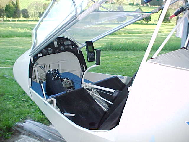

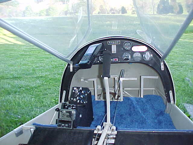

Richard Pike
Joined: 09 Jan 2006 Posts: 1671 Location: Blountville, Tennessee
Posted: Thu Oct 27, 2011 5:41 pm Post subject: Re: GPS in FireFly |
Make a bracket and mount it on the stick. Here's how:
Take a piece of tubing about 3" long and the same diameter as the control stick and split it in half. Spread it open a hair. Weld a 3/16" rod to the top of it sticking out sideways. Solder that to a piece of copper sheet (from the hobby shop) that is bent so that the gps fits into it snugly. Angle it so it is easy to see.
Roll the rubber grip back and slip the half tube into place, wrap it at the top with a couple wraps of electrical tape, it won't go anywhere. And (Taa-Daa!) you can poke the gps with your thumb without ever having to take your hand off the stick.
If you want detailed closeups, let me know, I'll get you some tomorrow.

On 10/27/2011 9:41 PM, Richard Pike wrote:
| Quote: |

i mounted mine on the top of the controll stick... at first it seemed a
bit odd,,, but on a cross country, it seems just right,,, only thing i
could sugest, is to make sure it is at the correct angle for viewing, had
to change the angle after the first try.
boyd
