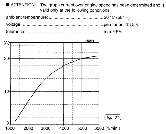

The built-in alternator is good for about 18A total. If
the battery is not fully charged, it can soak up
a large proportion of that 18A.
You need to put a good charger/maintainer on the
battery and make sure it is topped off. Start
the engine and turn off every accessory with
a switch.
You can't get full output out of the alternator
except at cruise:
[img]cid:.0[/img]
This data plot is a real 'hedge' on reality. First
a 5% tolerance. Next good at 20C. Finally, output
at these loads may be as low as 13.5 volts. In other
words, high enough to keep you from discharging
the battery but not enough to charge it either.
Hence, that excursion above 20A is a bit
of whimsy seldom realized in real world utility.
