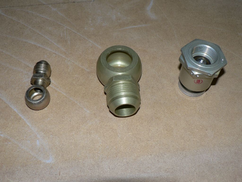

The items on the photo attached came with my motor, where do they go?

The item on the right looks like the anti-siphon valve for the oil feed to the engine. The male end threads into the side of the oil pump and forms the main oil supply to the engine. The female end would go to the oil delivery port on your oil tank. Its purpose is to prevent oil flowing back into the tank when the engine is stopped.
The two items are simple banjo fittings.
