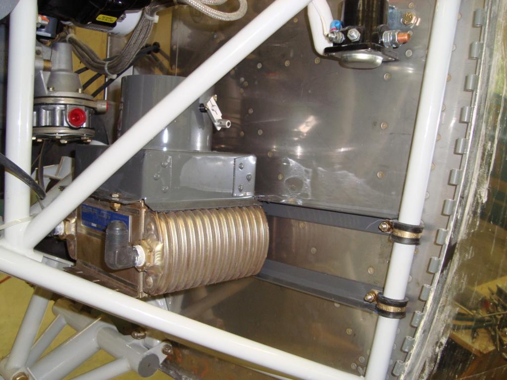

Just did the final mount of my oil cooler today. Photo attached. Photo was
taken before I added an Adel clamp and piece of angle to attach the forward
bottom flange of the cooler to the adjacent engine mount pipe. This forward
hard point is needed to prevent flexing of the cooler flanges if you just
had it attached only to the firewall. The two pieces of .063 angle are
attached on their inboard ends to the left tunnel vertical bulkhead angle.
I used Adel clamps for the outboard support attach points as there is no
good firewall support angle in that area.
Carl

PostPosted: Sun Aug 07, 2011 8:01 pm    Post subject: Oil Cooler mount Reply with quote
very clever
