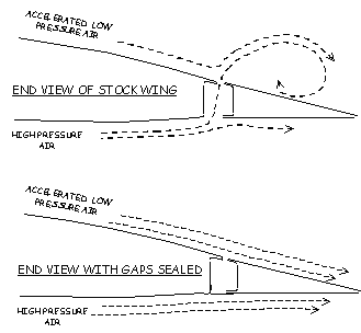

I too am looking into this ; Here is what I've found so far...hope other Kolbers will chime in !
"The purpose of a Gap Seal is to create a pressure barrier between the high pressure air on the bottom of the wing and the low pressure air on the top of the wing. The diagram shows how the air moves upward through the gaps, thus causing significant drag and reduced control authority.
Another benefit is that it smoothes the air traveling along the bottom of the wing, thus further improving airflow. The effects of a good Gap Seal kit will be: "
increased cruise speed
improved rate of climb
