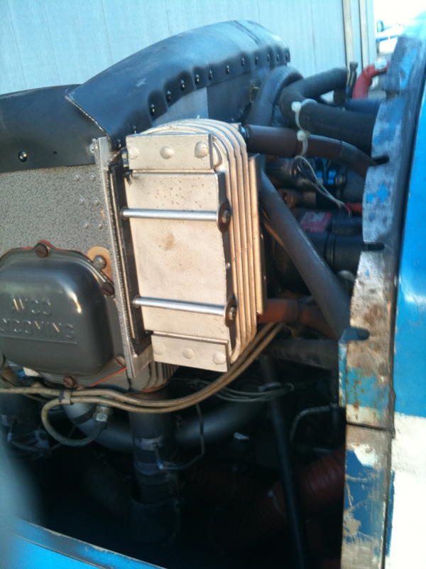

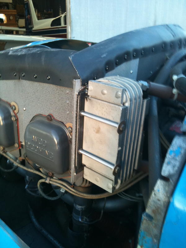

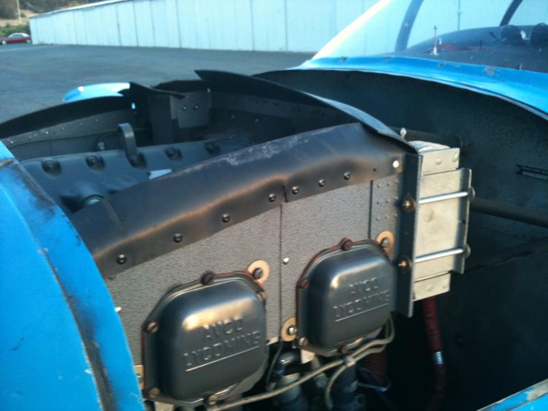

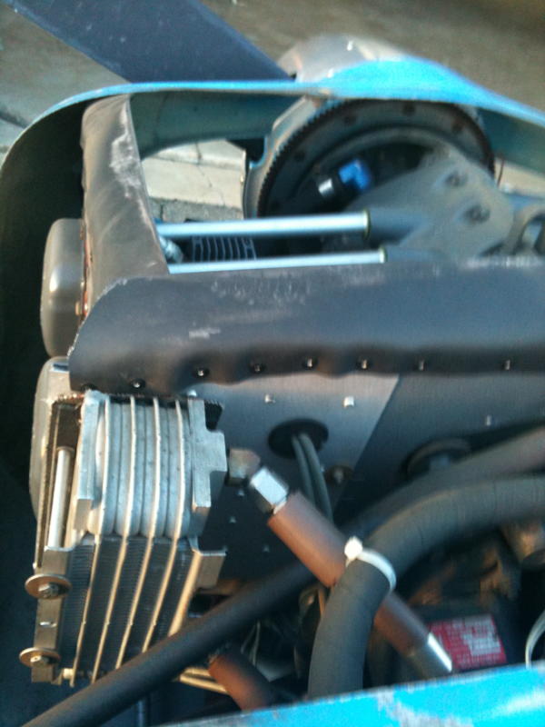

Here are some photos of baffling with the seals mounting on the inside (the wrong way according to Gary). Apparently they seal pretty well as the CHTs are about 300-325F on a pretty hot day. Note the baffle over the top of the engine that seals to the nose bowl, and the wings that deflect the air smoothly around the spinner and inside the plenum. This provides for a "total" seal that is not possible with the stock 2 place baffling, and most likely provides as good of cooling as a fixed plenum over the cylinders. Way to much air on this plane which needs to be throttled to reduce cooling drag. The small original oil cooler with 2" SCAT duct is plenty adequate.
Cliff

Don't you tuck the REAR baffle under the side baffles?
That way the inrush air pushes up both baffles against the upper cowl to seal.
With the rear on top of the side baffles the rear can lift higher and above the seal of the side baffles.
I also do my signature stitching sealing of the rear to side baffles with unwaxed dental floss.  It holds the baffles up, in the proper curve and in contact with the cowl.
And then if the owner REALLY wants to get fancy - They - Can smooth the gap between the rear and side baffle by cleaning the silicon with MEK and applying a TAPERED seal of High Temp RTV.  It is easy to use a straight edge and go out about 2.5".

Done properly, you don't need to do anything special. I usually have the rear under the sides initially to hold the back down. After that, it doesn't matter. Also, I don't need to connect the rear to the sides because they fit without any attachments. I've tried connecting the two together but it never fits as well as when the baffles find their own relationship.
