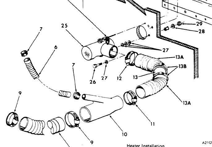

My cabin heat scat tube has a splitter. 3 inch line goes to exhaust pipe shroud and a 1inch line used to go to nose bowl diaphragm to supply fresh air. Do you know what it is for? My guess is that without it the hot air is too hot and it could damage the plastic defroster vents and maybe even windshield.
I don't see where does this 1 inch line connects to now. Where have you been connecting it to?

I eliminated this for the STC. Just plug it with a rubber plug.
In 1985, I was doing the first annual on my 77 Cheetah and saw that hose. It didn't make any sense to me. So, I removed it. I never replaced it. I sold the plane in 1999. As far as I know, it's still not there.
I also removed it on my Tiger prior to the new cowling.
With the cabin heat coming in under positive pressure, you don't need the hose. You can install it anyway you want. Get a 1 inch flanged duct from Aircraft Spruce and mount it under the ignition leads to the right of the oil cooler.

The 1" duct does dilute the hot air and reduce the temperature some.
How much I don't know but Grumman thought they needed it. The plumbing
would have been easier without it as it has been somewhat problematic
securing the Y to the engine mount tubing and keeping the metal air
outlet duct flange (78/79 Tigers) from sawing into the Y inlet SCAT duct.
An ideal system will have a mixing valve so that the amount of cold air
mixing with the hot cabin heat muff air can be regulated. It's better
to have a lot of warm air flow rather that a small amount of very hot
air that burns your feet etc.

Years ago I began experimenting with reducing the size of the fresh air inlet to the muffler. I found that no more than about a half inch diameter hole is all that is needed to maintain cabin heat with OAT even down in the teens F.
Among several benefits one is that the lower cowl is not pressurized as much as it is with the full size opening. This helps with lowering CHTs, enough to see the difference with the gauges and it also reduces cooling drag and keeps the overflow air at the cabin heat valve from burning things up. It also keeps the exhaust pipes from cooling which keeps velocities up to increase scavenging in the powerflow tuned exhaust
Why pressurize the lower cowl all the time by continuously dumping unneeded really hot air?
Would have been nice if the cabin heat valve were originally placed at the inlet to the muffler.
Carb heat was unaffected
It is a simple to do for many benefits.....

With the Jaguar cowling, the fresh air for the muffler is in front of the #1 cylinder. It's pressurized air flow as opposed to the static air flow on the stock cowling. An argument could be made that the 1" duct is designed to create airflow through the muffler.

A lot of useful info, thank you!
I guess I might want to try to attach an aluminum strip to the right front baffle and see how much of the cabin heat inlet I can cover and still get the carb heat temp drop.
As for the 1" fresh line, just leave it open into cowl space and use your nose as an additional engine diagnostic tool? Wink
Q - 1. Gary, if I am not using that 1" line, is there any place I could get a 3" to 2" reducer to put on the PowerFlow cabin heat outlet and get rid of that ugly "Y" altogether? Exhaust section of car parts store?
Q - 2. I have another contraption in my cabin heat inlet SCAT, called "muffler". It's number 13 on the attached diagram. It was added in '77, I think. What the (at)&^% is that for?

Plug the hole in the "Y" divider with a 1 inch rubber plug. RTV it in place.
A-1: In 1985, I cut off the 1 inch duct on the "Y" and had a shop weld a piece in place. After powder coating, it looked pretty good. Note, the AG5B does not use that 1 inch duct. Get one of the reducers from Fletchair.
A-2: VERY GOOD QUESTION! In 1984 when I began the restoration on my first Cheetah, I discovered that too. At the time, I was told that Grumman-American included that muffler so the pilot could not hear the engine with the cabin heat on. I removed it and flew for a while. Then put it back on and flew for a while. I couldn't tell any difference. On a Cheetah, the cabin heat is in the middle of the firewall. SOOOOO. I had a piece of aluminum tubing swedged out and used it as a coupler. I mounted the muffler onto the cabin heat valve with fuel tank sealant. Years later, on my second Cheetah, I removed the muffler material from the muffler and put the muffler material inside the cabin heat valve. After that, I just eliminated the damn thing.
Keep It Simple Stupid. The good ole KISS principle.
On a side note: air flow testing showed the cabin heat inlet in front of #1 kept the airflow attached to the inlet better. Without the cabin heat duct (I call it the vacuum cleaner attachment), there is a big recirculation of airflow in the inner corner. The same is true on the left inlet in front of #2. But, the fix for that one is a little more involved.

That's interesting, only 2 or 3 deg difference in carb heat rise. Is that static on the ground or flying?
I have a temp probe in front of the carb air intake behind cyl #3. I was trying to see where LoPresti gets that there is really hot air off cylinders going into the carb. I didn't find any hot air there while flying. It was about same as my OAT gauge. I could only get a higher reading after being stationary on ground at idle for 10 minutes last summer. I think it got about 15 deg hotter than OAT
On Jul 6, 2011, at 12:49 PM, Gary Vogt <teamgrumman(at)yahoo.com (teamgrumman(at)yahoo.com)> wrote:
I know what you mean about the carb heat entrance. Seems there is enough heat there and that leaving it open improves the airflow to the carb. I fabricated a plate and did a number of carb heat rise tests. There was about 2 or 3 degrees difference, higher, with the plate. Not worth the aggravation.

Remember the cabin heat valve? It is always open to the lower cowl unless cabin heat is fully opened. That's why you sometimes see evidence of heat on the firewall at the bottom of the cabin heat valve where the opening is. There is a lot if air moving thru there and it is very hot.
YMMV
Ned

> The 1" duct does dilute the hot air and reduce the temperature some. How much I don't know but Grumman thought they needed it. The plumbing would have been easier without it as it has been somewhat problematic securing the Y to the engine mount tubing and keeping the metal air outlet duct flange (78/79 Tigers) from sawing into the Y inlet SCAT duct.
> An ideal system will have a mixing valve so that the amount of cold air mixing with the hot cabin heat muff air can be regulated. It's better to have a lot of warm air flow rather that a small amount of very hot air that burns your feet etc.
> Cliff

I didn't reduce the scat tube diameter. I put a plate over the muffler opening and drilled a hole in the middle of it.

Yes and lower the pressure min the lower cowl if you have the OEM muffler.
Not if you have the PowerFlow muffler as it is open ended to the lower cowl.
Also, I question whether the cabin heat valve could with stand the pressure and heat with the vavle body being sealed. It might allow hot air into the cabin all the time if it were pressurized
