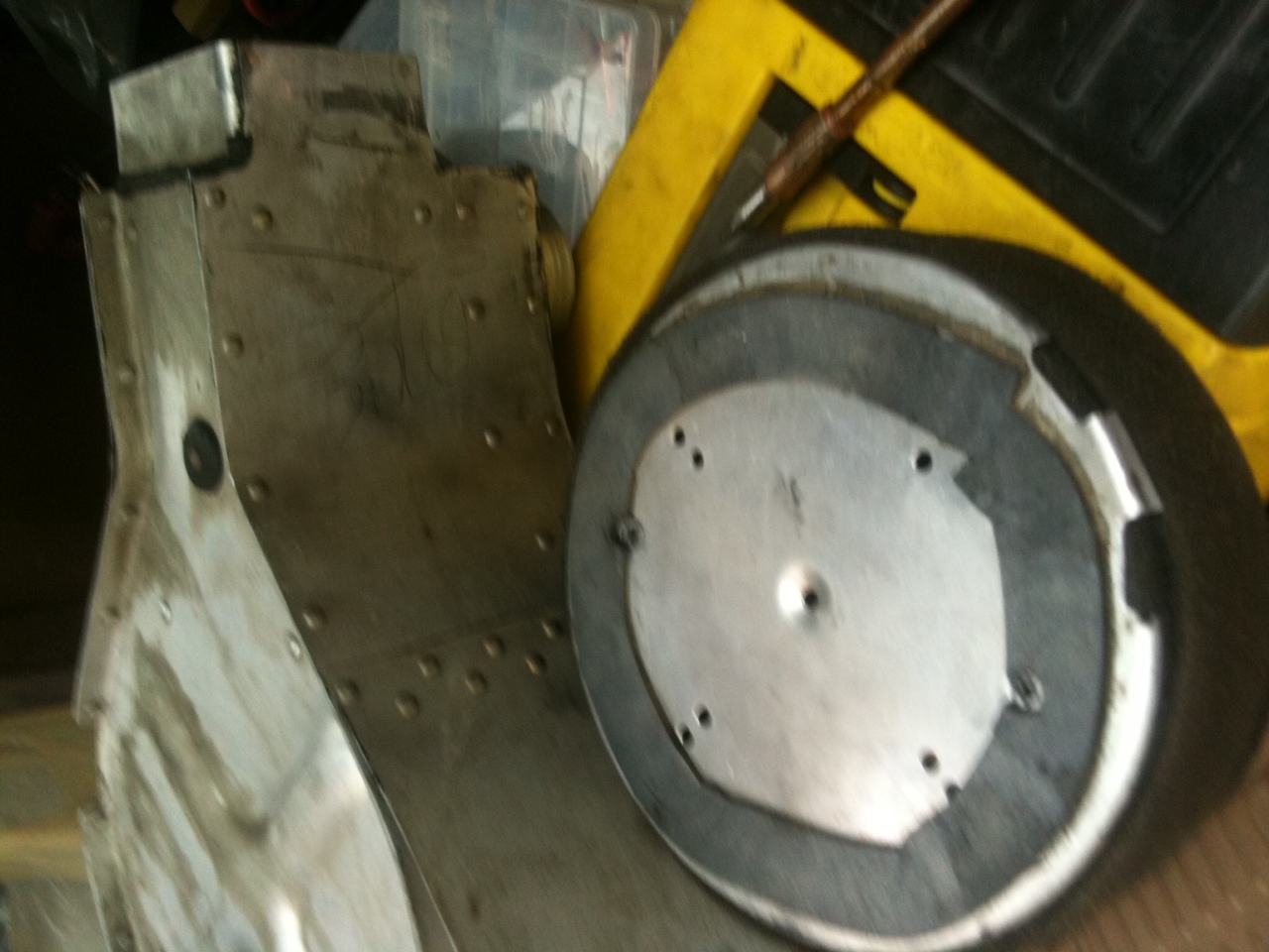

Guys,
My Brakett air filter bottom pie pan has several holes in it. Please see the picture. They don't make sense to me because I think that they let unfiltered air into the carb. Are those holes supposed to be there? Why?
A related subject. Is challenger filter installed with pie pans? Does it come with it's own pans or is one supposed to reuse the original ones? Does anybody have experience with challenger on 78 tiger? It looks like it may not be a good fit:

Hi Boris,
You can get a new cover from Fletcher. It isn't supposed to have those holes. I've seen a lot of weird things. This is just another example of someone who doesn't know what they're doing.
As for the Challenger air filter, I tried it on mine. I noticed the CHT/EGT spread was worse with the Challenger. Your mileage may vary.

teamgrumman(at)yahoo.com
PostPosted: Tue Jul 05, 2011 12:52 pm    Post subject: My Brakett air filter pie pan has holes Reply with quote
John,
By design, there should be a block on the bottom of the airbox which holds the air filter up. There should be a tab at the outer most corner up inside the airbox. There is a deflector plate at the inlet which holds it to the center.
On N28840, I replaced the tab with a stainless steel tube, held in place with a 1/4 inch bolt.
The design of the airbox allows the filter to move around a lot. It's a shitty design from the point of wear and tear. Just the vibration alone wears holes in the pie tins around the parameter. Over the years I've tried a number of things to keep the filter in my Tiger from eating itself. Right now I have two blocks in the bottom in an attempt to keep the filter from moving too much. It helps, but not a lot.
What about a redesigned airbox with an opening on top to drop the filter in?

So exactly what is supposed to hold a 1977 Tiger bracket air filter
centered in the airbox(and not fall to the bottom)?
Does anyone know?
I have seen sticky (on both sides) rubber tape used on the front and
back face of the filter pie pans. This seems pretty lame and it seems
it would offer the opportunity for worn rubber to get into the
carburetor.
Is this really the origial design?

PostPosted: Tue Jul 05, 2011 1:02 pm    Post subject: My Brakett air filter pie pan has holes Reply with quote
Gary:
Years ago I tried a block at the bottom but the filter machined itself into it.
The world could use an improved design.
(I note there is a hole at the back of the airbox that could be used to secure the filter (with a bolt if a nut were welded on to the air filter pie pan).
John
PostPosted: Wed Jul 06, 2011 9:49 am    Post subject: My Brakett air filter pie pan has holes Reply with quote
Yes, that is a problem. On one installation I tried two blocks stacked and shaved. I mounted them so they hit the filter and not the housing. It would put a big dent in the filter, but seemed to work ok.
