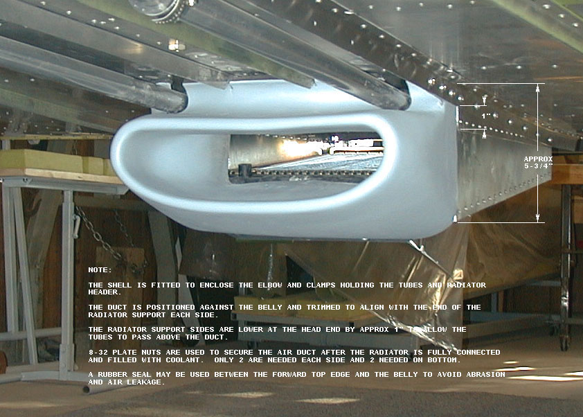

Would the glass intake fit if I don't move the radiator? I'm thinking the
nose strut or muffler would cause a problem. Moving the rad back less than
you did might solve the clearance issue without messing up the CG, but
that's a new experiment and might move it into a worse pressure area. Too

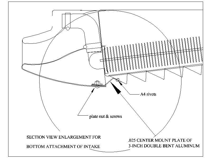

If you use my intake, you’d have to add a strip each side to get an additional ½-inch or so open at the front end.  The mouth of the intake is made to reduce the area, get better cooling with a stable airflow and deflect the air going around the bottom to effect a better negative pressure back at the louvers.  This effectively zeros out the drag at the front end, not completely, but it helps a lot.  The inch from the fuselage to the intake is dead air, sometimes moving in the same direction as the plane, so the intake needs no better streamlining there.
The engine page on my site shows what’s needed to put the radiator correct with the intake. I have a guidance sheet that pretty much summarizes the process.

I’ve attached several files that will describe the radiator and install better than I can here.
