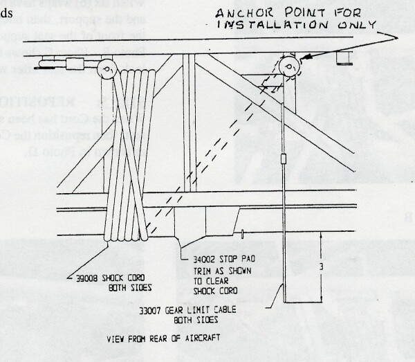

I have the letter from the factory about different length bungees. It says the 3/8" cord is 66 inches long and requires 6 wraps. The 5/16" is 90 inches long and requires thirteen wraps.
The rubber stop on the end of the gear should be trimmed to allow one wrap to sit outside the fence.
For what it's worth the replacement cords I put on a couple years ago are 3/8" and 60 inches long. I got 6 wraps. It took just about 15 minutes each using vise grips with the jaws taped up.
A while back I saw a post, but of course can't find it now, from a guy that used clamps similar to these http://www.lowes.com/ProductDisplay?partNumber=241624-52800-XCRU5&langId=-1&storeId=10151&productId=1068709&catalogId=10051&cmRelshp=req&rel=nofollow&cId=PDIO1 he said it was a fairly easy job using these clamps. I'm going to get some for my next bungee replacement session.
The trick is to stretch them as tight as you can on each wrap and do not lose any progress on the last wrap while you stretch the cord on the next wrap. use the clamp to hold each wrap as the next wrap is made.

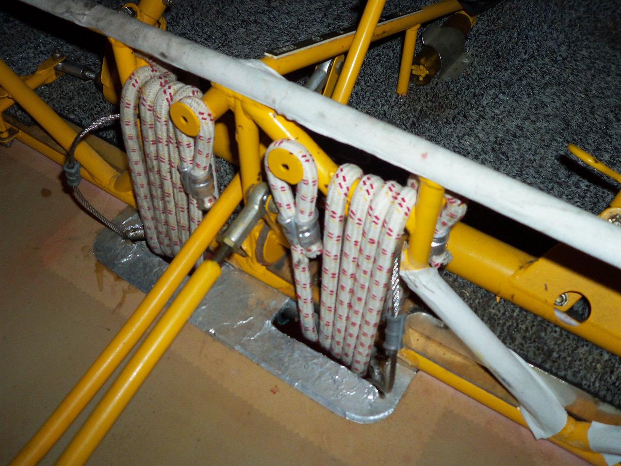

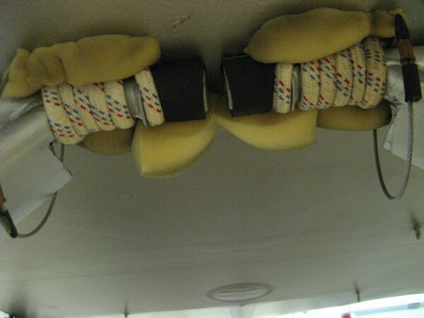

here's three pictures worth 3000 words.
 Filesize:  77.05 KB
 Viewed:  29824 Time(s)
 Filesize:  59.84 KB
 Filesize:  53.73 KB
Tom Jones
Classic IV
Ellensburg, WA

Thanks for that Marco, It's a good thing to laugh about as it's a bear of a job, at least with the knowledge I have now. I got them in with help, but we never achieved six wraps. I think now I might be able to next time, it appears to be one of those tasks that gets easier each time. Hammer handles, padded pliers, and the other tools suggested all helped, but didn't make six wraps possible, at least for me. I stopped at five and was sad to give up that much progress toward the sixth and watch that slack get sucked back. But the suspension is loads harder than it was before, so five may do me fine. It is a 1050 machine not 1200 and I plan to fly alone almost always, nowhere near max weight. I'm going to go with five at least for now and hope for the best.
[img]cid:050023622(at)25062011-002E[/img]

PostPosted: Sun Jun 26, 2011 3:35 am    Post subject: Re: Bungees, really need help guys! Reply with quote
Dave,
I know your frustration but looks good -- you might need a tie wrap to hold that bungee away from the flaperon control -looks like it close to rubbing.
5 wraps likely will not be enough - it will be too soft. Just rock the wings on the ground hard up and down and watch the suspension moving. Bungees will loosed over time. Short time likely you willl notice.
I gonna be pulling off mine for floats install very soon--- Looks like I will have to do a video for you guys to show you how easy it really is.
