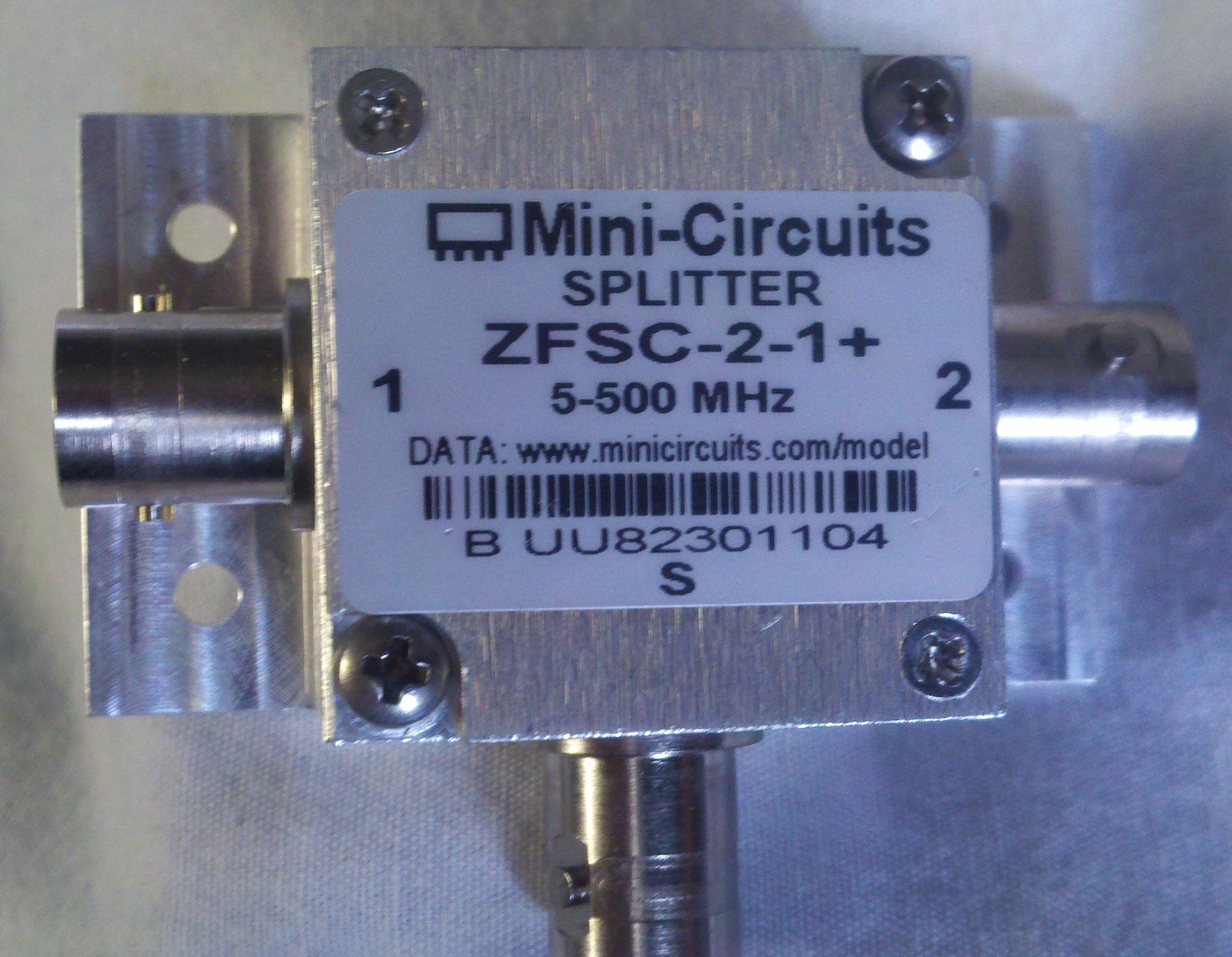

You had asked about the broadband splitter. I was able to get a picture of it yesterday. I believe that this is who makes them for Garmin. They are very small, especially for the amount of money that they get for splitters. I didn't look up a source for these but there should be enough info in the picture to find them. I got it from my local avionics shop (Airborne Electronics, Sacramento). Sorry, I don't have the Garmin part number equivelent but I can get it for you, if necessary.
This broadband splitter is only needed in front of the SL30 or other units that have the internal splitter for the glide slope and nav signals. You can come off the other side of this unit with a standard splitter for going to the two inputs for the 430W. I hope this helps.

Yep, that's the exact Garmin part I linked to previously.
Thanks Nick!!
-Sean
