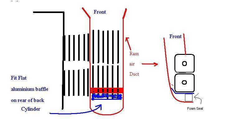

Hi Jeff, those look to be the narrrow air ducts with plugs caps outside. There is a bigger set if your cowls will take them?
Regarding the inlet holes I know there is a school of thought that with the shape you have the air can struggle to go in and would rather go over the top of the cowl.
Try a 'brow' to the holes, tape a strip of card or something over the top coming forward to see if you aren't capturing the air flow.
What's going on at the back cylinder? Is there a space for the air to escape without doing anything? My early 2200 ducts had a hole at the back you could put your hand up (see sketch).
The air will always take the easy way out. You do have the blanks in between the barrels to stop the air getting out that way? I can see a way out at the front on the front cylinder, close those gaps also.

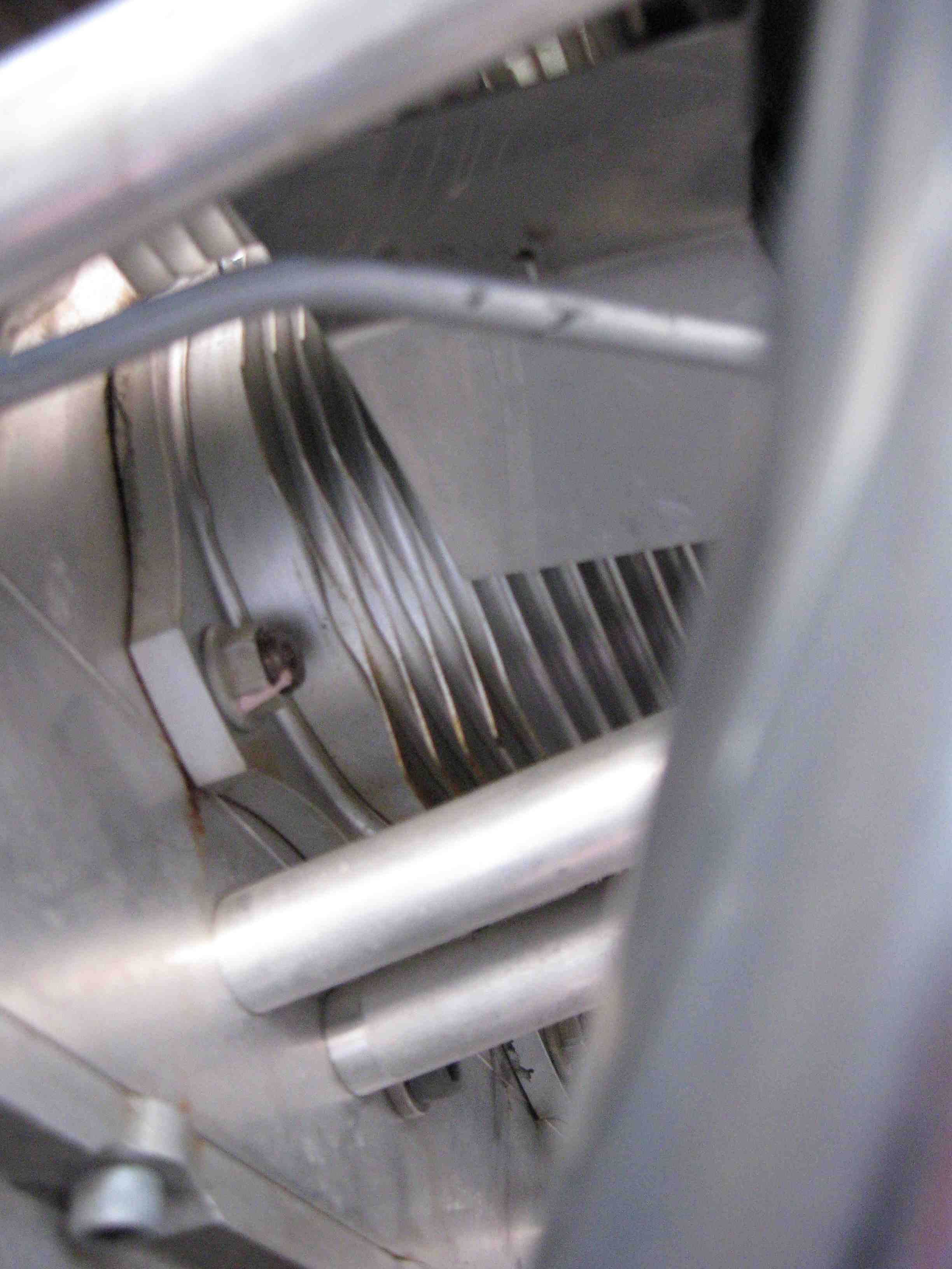

Jeff,

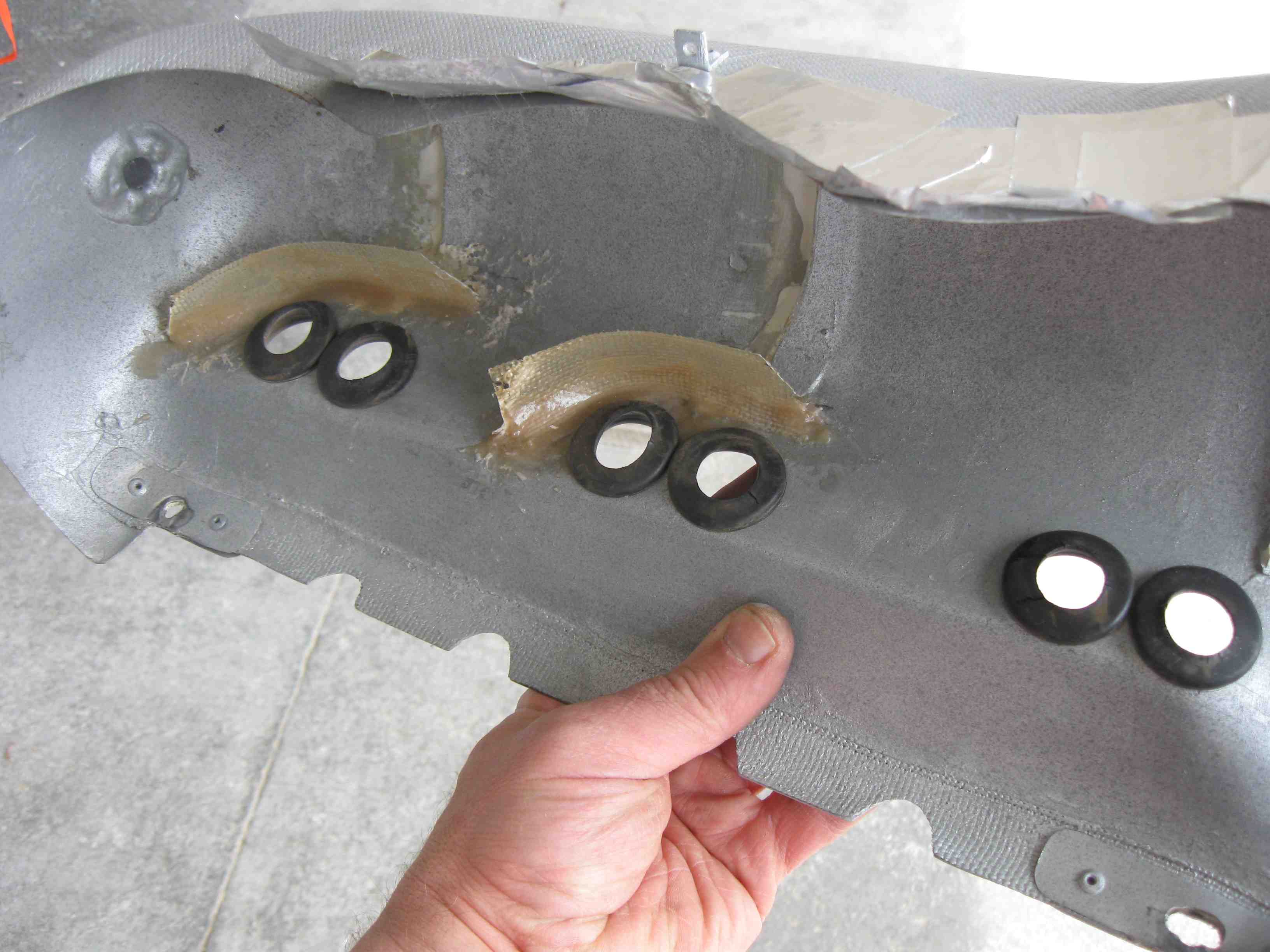

One thing missing is the dam in the front of the air-duct. This starts in the bottom of the duct and runs up to about the welsh plug in the head above the rocker shaft, may be about 2” tall.
If both ducts are like this in the front the majority of your cooling air is going underneath the front cylinder. This will also contribute to a lower pressure differential between the cowl and the duct, limiting the amount of air passing the cylinders.
I can provide a picture or two if you like.
Nick Otterback

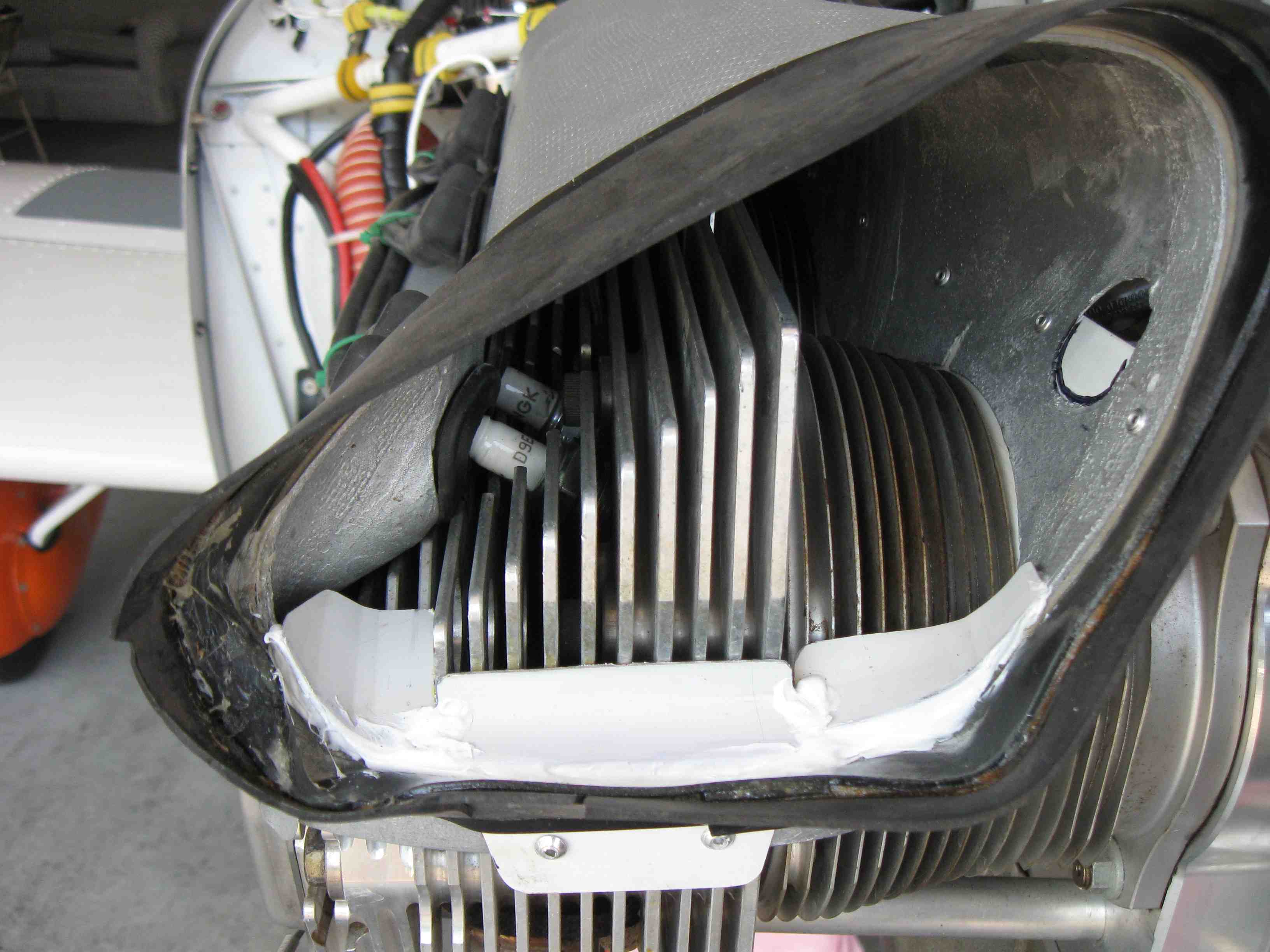

Jeff,
Along with my last email here is a picture. These are a new set of ducts, however it is important to put this air-dam in the front of the older ones as well.
Note in the right side of the picture is a cut out in the fins and a small half moon shape plug visible. That plug is for an oil galley, I would suggest making that dam this tall.
Nick Otterback
Arion Aircraft

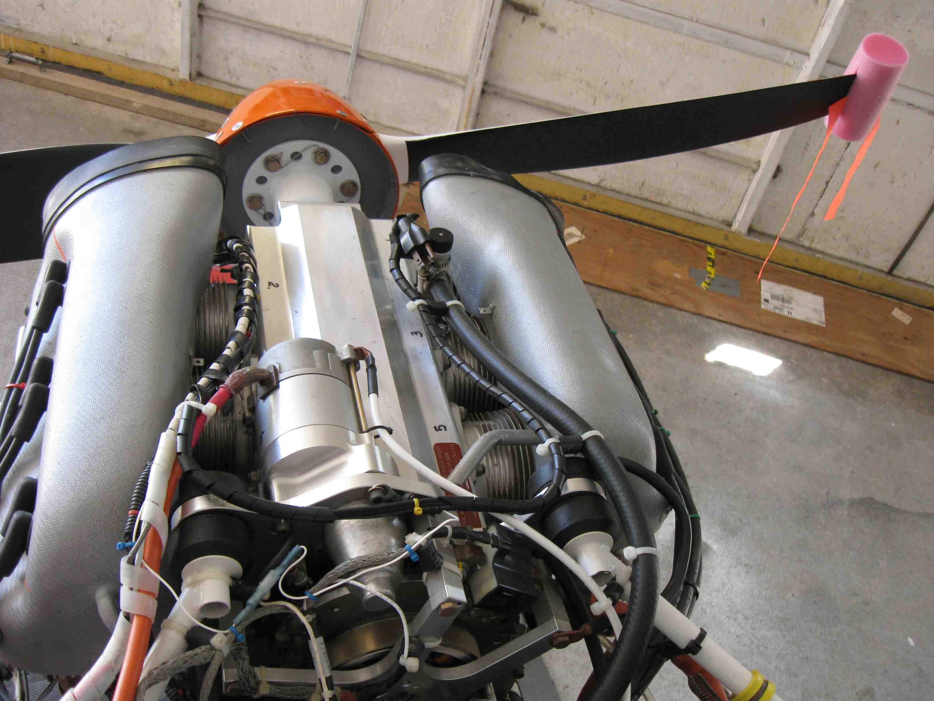

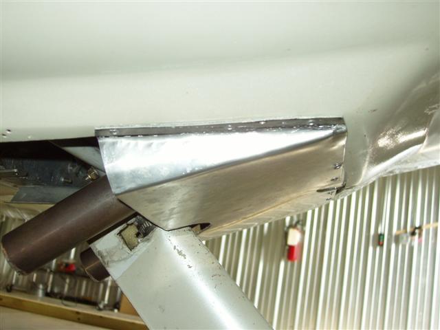

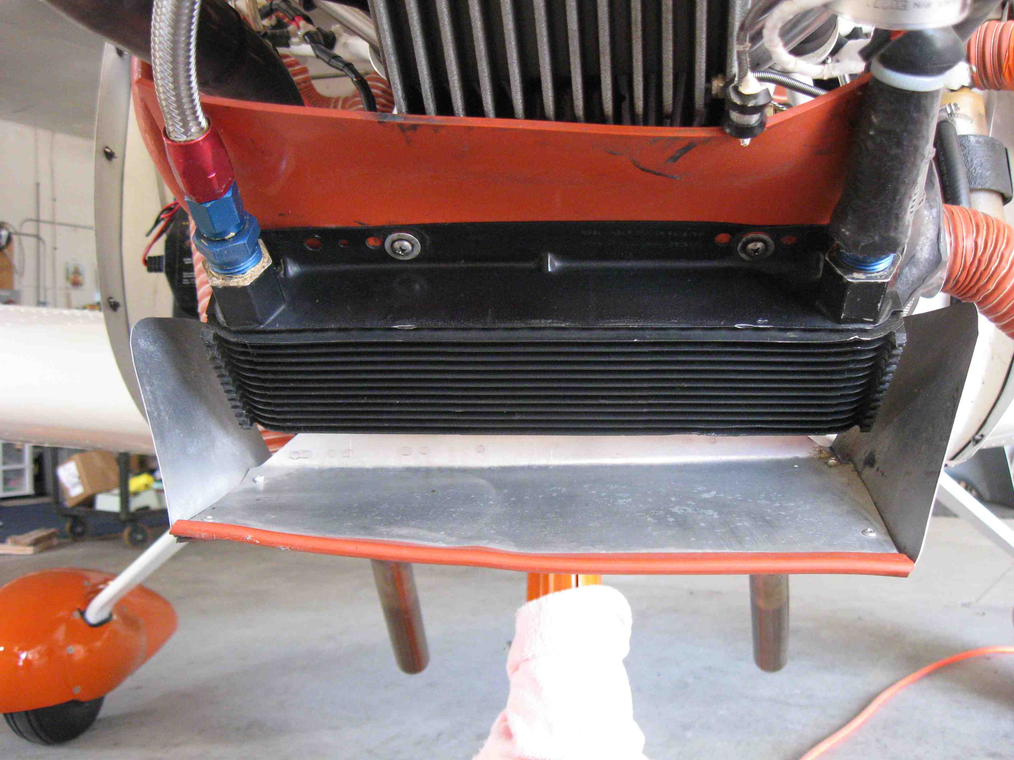

2514.jpg Shows a "scoop" that I added to aid in my old style oil cooler Seems to work temps on cooler days 190F hot days 212F.

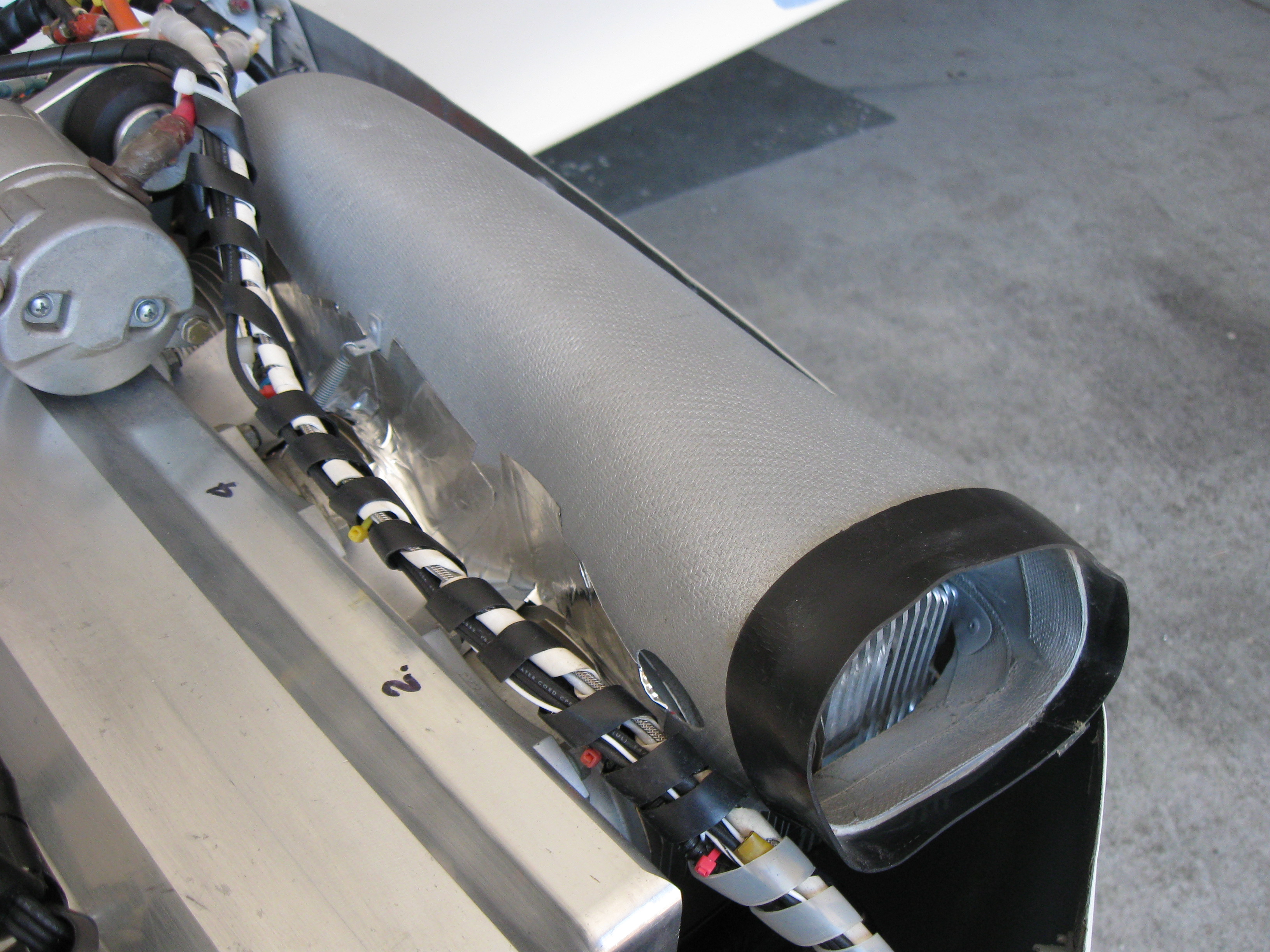

2515.jpg Top of engine looking forward.

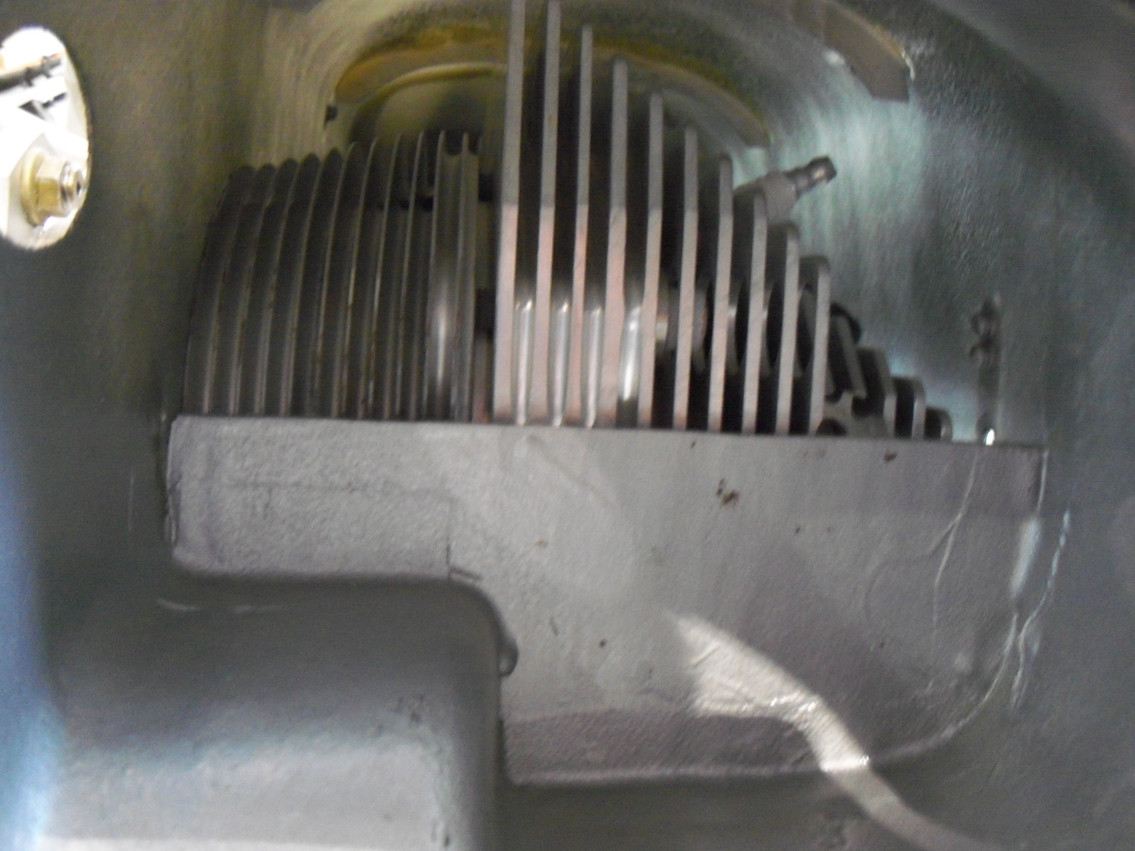

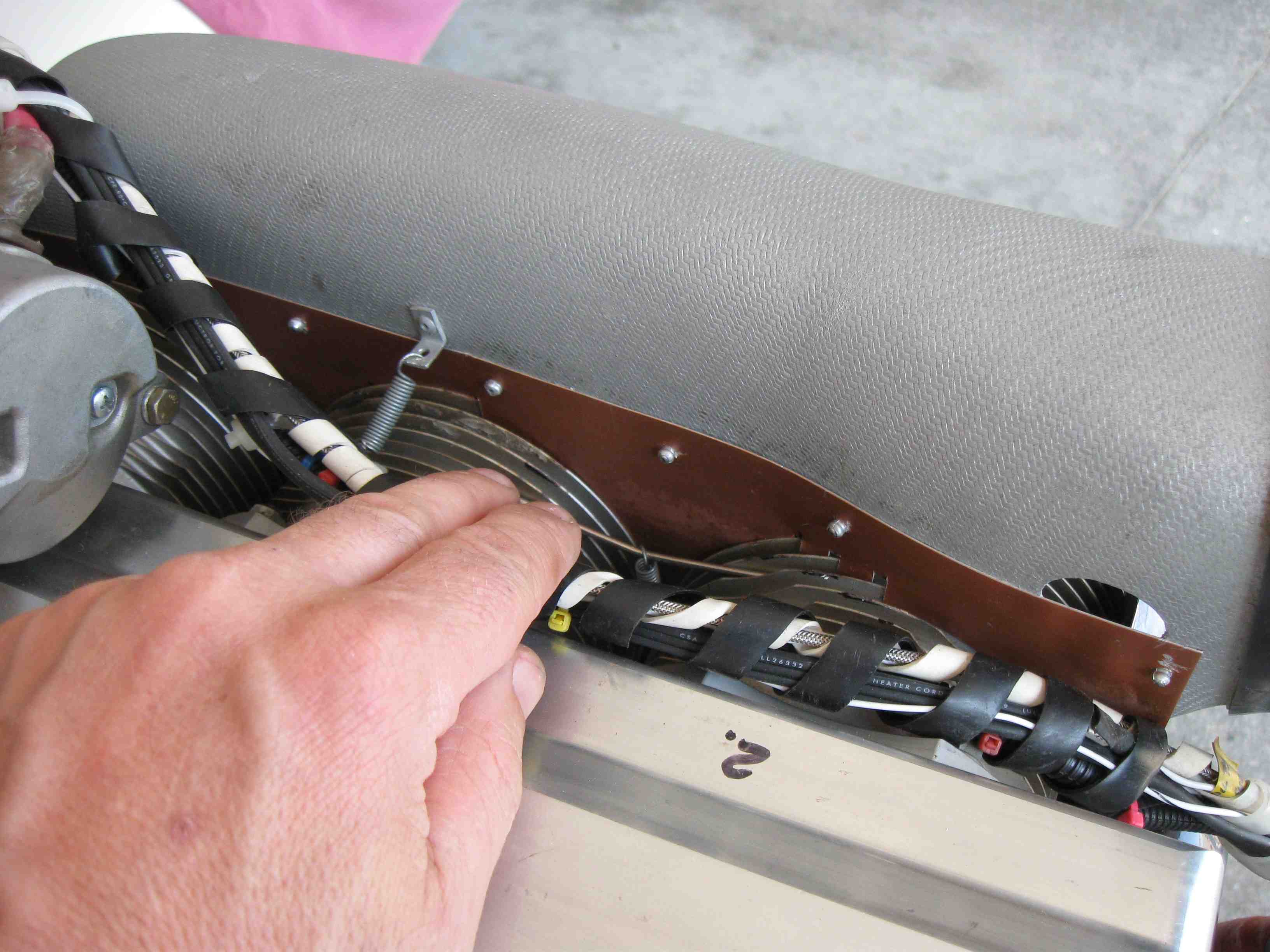

2529.jpg I added some aluminum sheet, cut precisely to the cylinder profile to seal up both inside baffles.

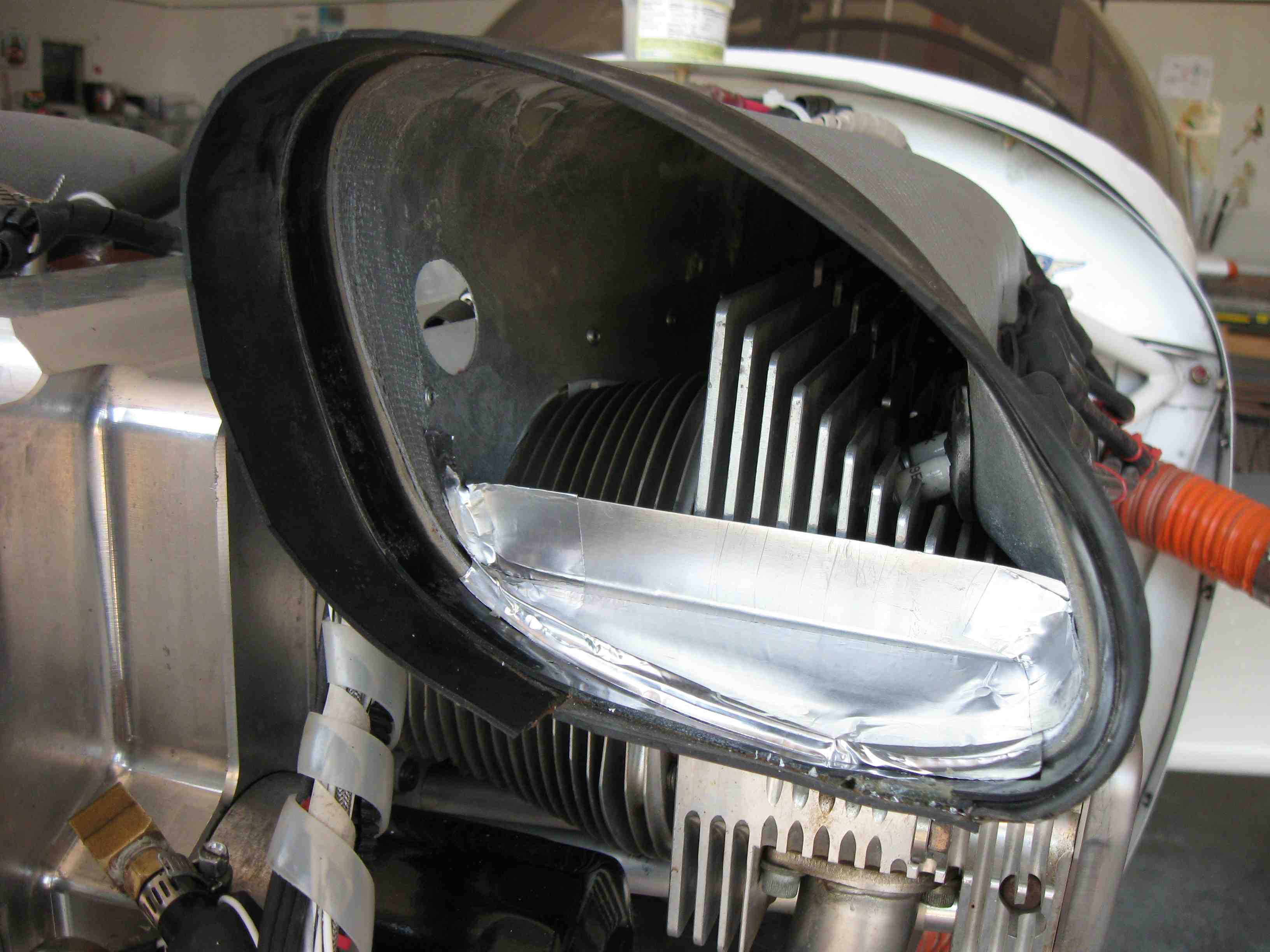

2530.jpg Per Nick Otterback's / Flylightning suggestion I added an air dam to the front right baffle on the 2,4,6 cylinder bank
2531.jpg Shows the 1,3,5 cylinder baffle entrance
2532.jpg I experimented with adding the butterfly cylinder baffles to the underside of the cylinders, I tested them during my first flight today and removed them for the second flight

I reckon the angle that your oil cooler is presenting to the incoming air is too great.  A normal tube and fin radiator like that does NOT like any more than 20 degrees before the air 'bounces' off.  Less than 7 degrees is ideal.

Remove some of the cowl on the bottom half at the air exit around the
nose wheel strut. Then temporarily duct tape a piece of aluminum to
make the rim bevel larger. This causes a negative air pressure actually
drawing more air out the bottom. In effect creating more air moving
from the inlets through the cowl/cylinders to the exit. The size of the
exit hole is important but the larger lip helped alot. I now have the
opposite problem. In the winter my cylinder head temps tend to run cold
(several read only 220 to 250) with a Grand Rapids EIS. In summer
(Pennsylvania) in a long climb number 3 cylinder might get to 350 but
returns to upper 200's after lowering nose to cruise.

First of all thank you for all of your input I appreciate as I battle
the heat demons in my cowl. Yesterday I spent the day working on my
CHT cooling issues.

When I had the Rotax cowl on my Esqual I got a step change in the
cooling by adding an outlet baffle.
It went back three times as far as it went down, so it was more
streamlined than the 'lips' that I've seen added by others. I don't have
a picture of mine but I do of the one I copied, Dave Mc was good enough
to send me the attached.
If you think about it, a hanging baffle on the cowl outlet will create
some suction but not as much as something more streamlined. I cured my
head cooling with the duct like this but went on to change to a new cowl
for oil cooling reasons.
I would recommend trying a more streamlined 'baffle/duct' on the outlet.
Regarding the dam on the inlet, there is a school of thought that the
tumbling effect of a vertical baffle is better than a 'ramp' I recall
someone trying both and finding the vertical baffle better.
The hanging baffles inside the ducts that restrict airflow, restrict
airflow so there is a balance between how much they restrict and how
much they deflect, any restriction is not a good thing with marginal
cooling.
Roger mentioned the smoke test's to see where the airflow goes, this
will show mow much air gets deflected over the cowl and so bypasses the
ram air entry. Another reason why creating more 'pull' on the outlet is
so successful.....IMHO.
Regards, Clive
