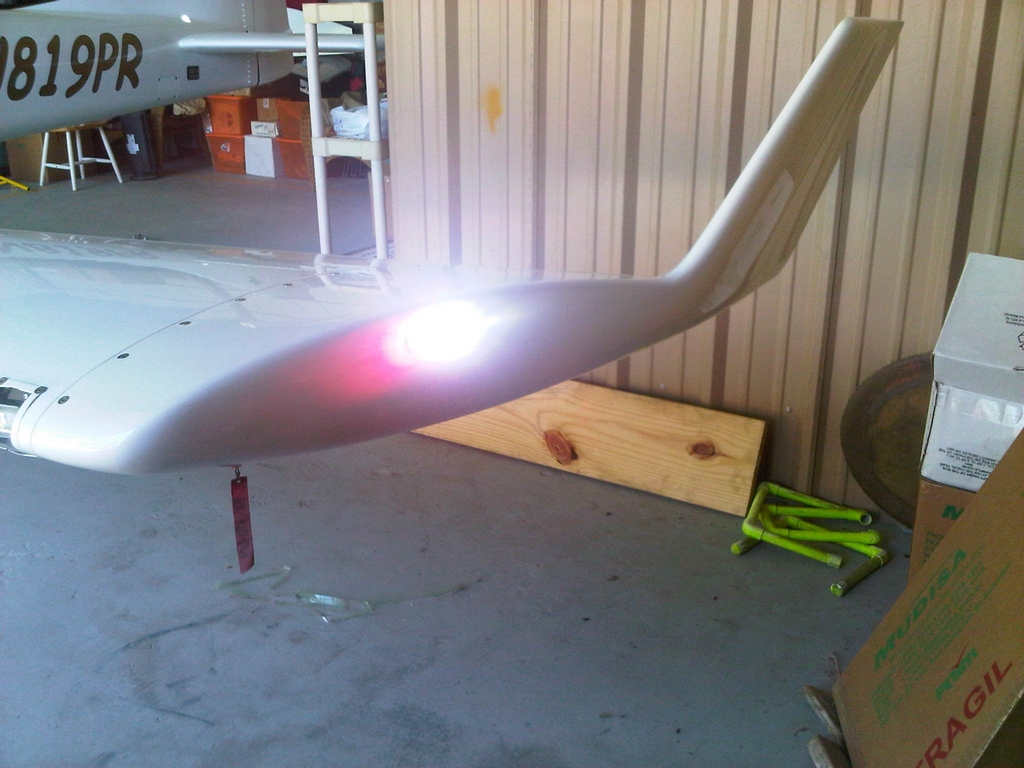

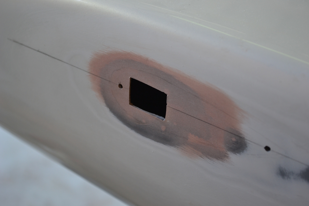

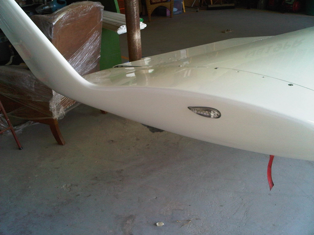

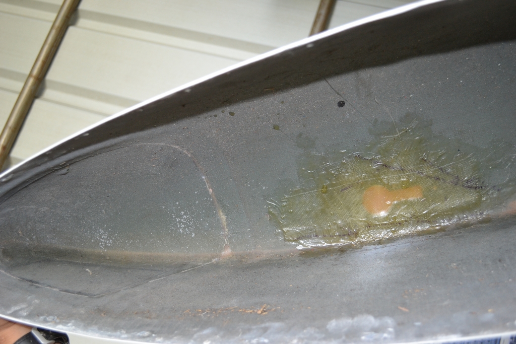

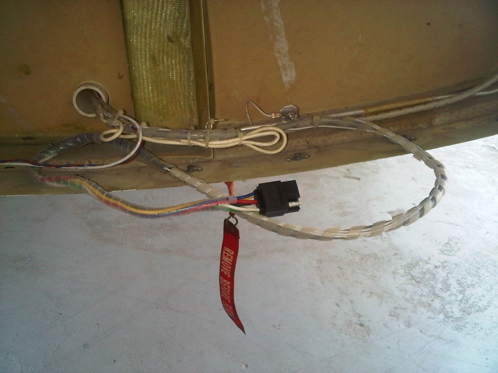

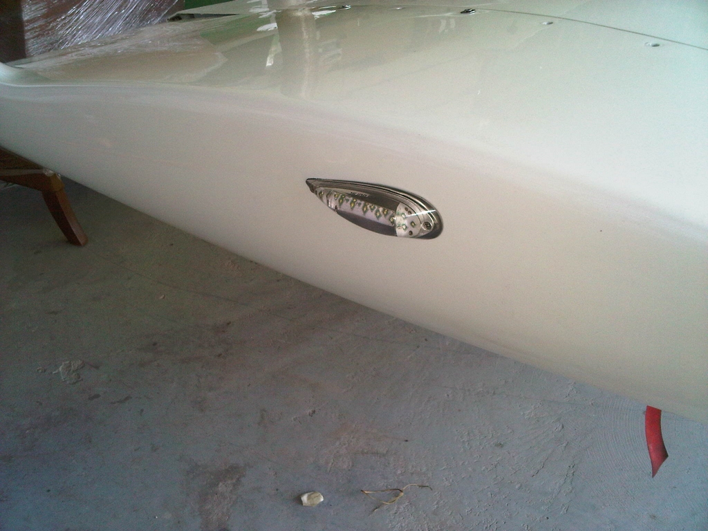

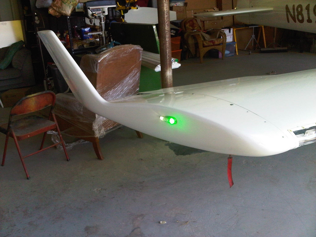

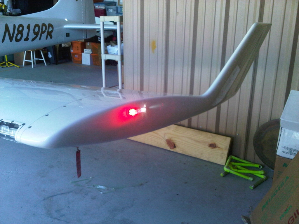

I completed the installation of AVEO Powerburst LED combination Position/Strobe lights replacing the old WHELEN lights. I deceided to change them since the AVEO lights are so much smaller in size, draw only a fraction of the current, have a MTBW exceeding my lifetime and have no interference issues like regular strobes. The mounting pattern is very different so I had to patch the old holes, re drill the new pattern then paint the tips. I used a 6 wire exterior trailer hitch electrical coupler ($3.99 at O'Reilly's) and used only 4 of the wires so now I have 2 spares.
The units look great and are extremely bright. Gives the wingtips a clean sleek look.

[img]cid:ii_13058196497f5ddc[/img]
AVEO Powerburst LED Navigation/Position/Strobe combo
[img]cid:ii_130581af461d23bc[/img]
Old WHELEN mounting holes
[img]cid:ii_130581d4ee7d8103[/img]
New AVEO mounting pattern with square hole for new connector
[img]cid:ii_130581e5cff885c7[/img]
6 wire exterior trailer hitch connector
[img]cid:ii_130581f792ae8f5e[/img]
Green navigation and white position light

Red navigation and white position light

[img]cid:ii_1305828eabe4c47c[/img]
Completed Instalation
