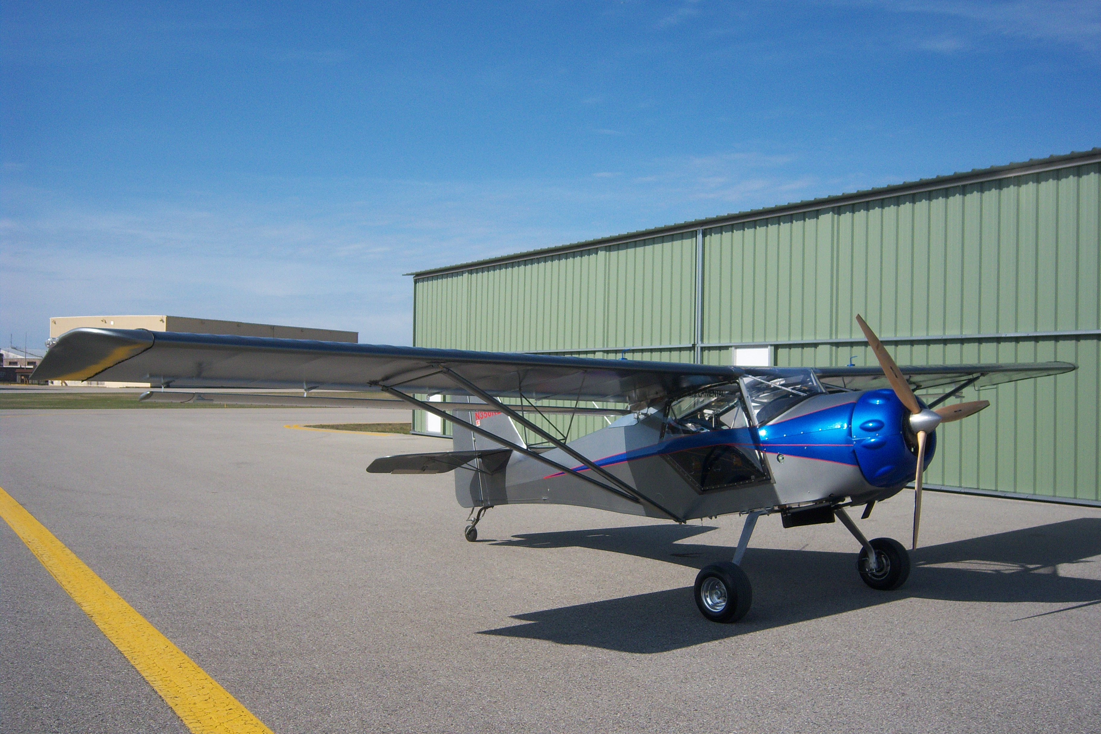

PostPosted: Tue May 10, 2011 1:30 pm    Post subject: MODEL IV-1200 PERFORMANCE Reply with quote
Apparently my earlier email had too many pictures so here's round two....
C box 3:1
Three bladed wood GSC presently set at 14 degrees
Cruise and full throttle EGTs remain between 1100 - 1200 F
Duel plugs per head
Round cowl
The only fairing is on the wing struts. I don't have gap seals or any other drag reducing strategies or devices. I've double checked my wing dihedral which is set at 2 degrees per side. All my measurements are within 1 or 2 mm of the manual's recommendation. She flies great--just at a slower than anticipated rate of speed and climb. I'll try your suggestions...

PostPosted: Tue May 10, 2011 3:22 pm    Post subject: MODEL IV-1200 PERFORMANCE Reply with quote
Yep. Clean enough, and very attractive. You should be going at least my speeds. I'd hope for an ASI or tach error.
